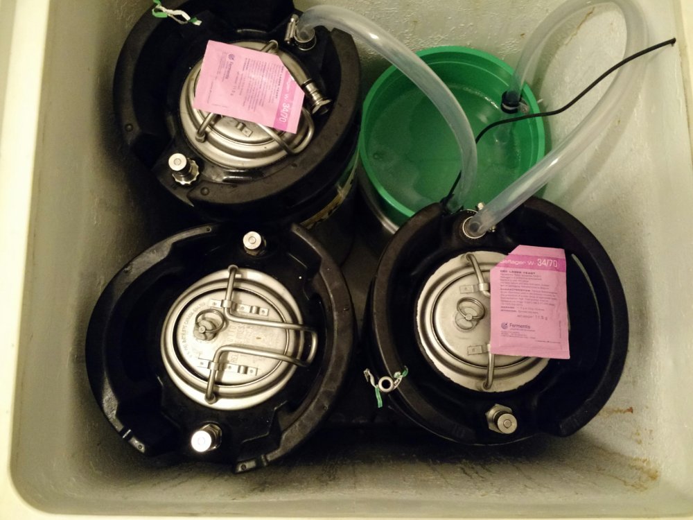

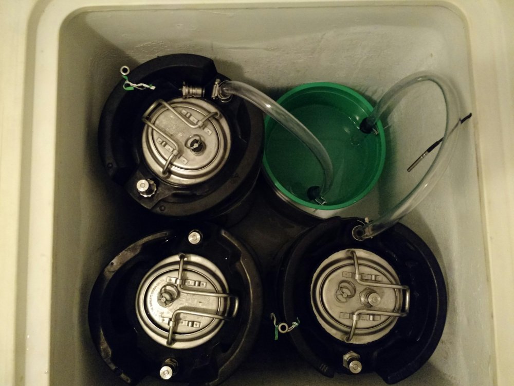

I brewed up two 5 gallon batches of Oktoberfest, a amber & a dark. I'm fermenting in my new/old corny kegs, with blow off tubes, into a bucket of Starsan. Both with be fermented with Safelager 34/70 that needs to primary ferment @ 55 degrees. Hopefully 10 gallons of Oktoberfest will be enough for the party. I'm also going to make 5 gallons of root beer (non alcoholic/CO2 gassed) for the grand kids to drink during the party.

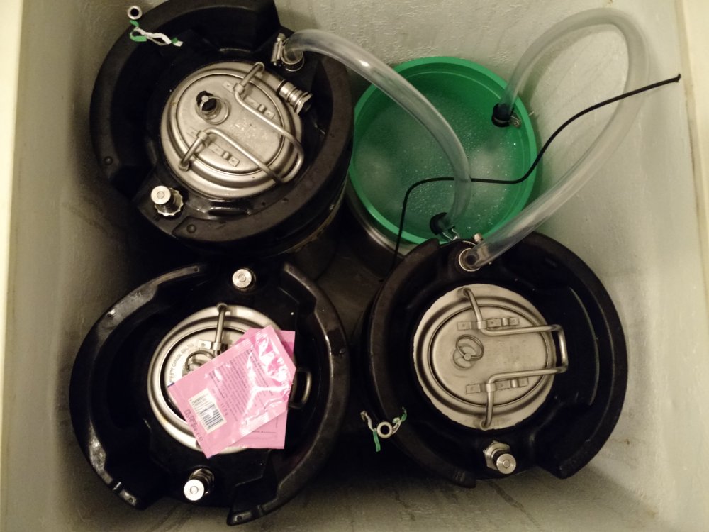

Both Oktoberfest brews are blowing a bubble about once every 90 seconds now. So its time for diacetyl rest. I unplugged the kezzer and opened the lid, so the kegs come up to room temperature. This is needed to allow the lager yeast (Saflager 34/70) to finish fermenting and clean up diacetyl (buttery flavored keytones) that it produced during primary fermentation. I'll most likely rack into secondary and start the long lager phase this weekend.

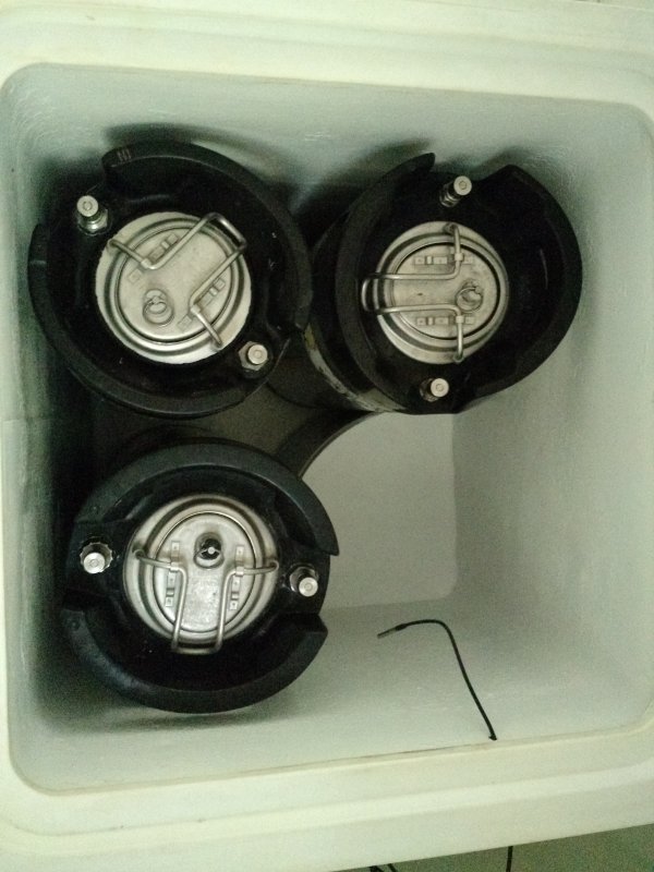

After 5 days of diacetyl rest, I racked both Oktoberfests, it helps to have 3 korny kegs when your racking 2 kegs :). I set my keezer to 50 degrees and will drop the temperature 3 - 5 degrees every day until 35 degrees is reached. Then I'll hold 35 for several weeks to lager. Then it will have to be racking again with primer dry malt extract to carbonate before its drinkable.
