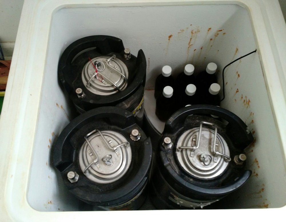

My 2nd oldest son gave me 3 5 gallon corny kegs, now I just need to brew up 15 gallons of high octane Oktoberfest. All three kegs just fit in the freezer :)
I'm having a heck of a time stopping rust on the freezer walls. This is a older freezer the inside is steel. I've primed with oil based primer and painted with rustolemn but rust still come back through in places. Any ideas how to stop the rust?

I dunno….stop the moisture - stop the rust? Kinda hard to do in a freezer I'd think...

Are the kegs causing the rust? Or? If kegs, put them in a plastic bag before inserting in freezer. Probably just didn't get all rust off before the paining? It happens.

Kegs are stainless steel and rubber. The freezer is steel, which is rusting. Good idea about plastic bags. I wonder if I couldn't fit and glue some thin plastic laminate to the walls of the freezer. Its only rusting where the refrigerate coils are behind the steel.

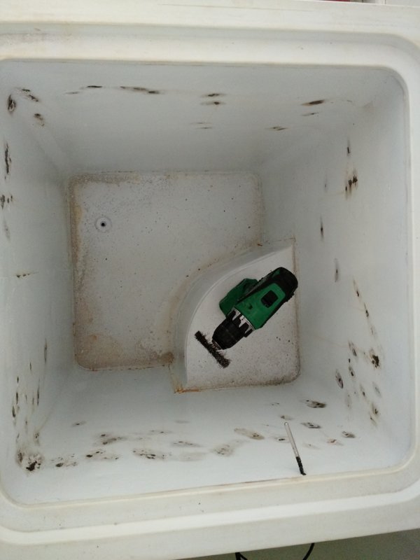

I used my cordless drill and a brass wheel to grind away as much of the rust from all of the spots as I could. The rust spots are mainly concentrated where the refrigerant tubes are located.
I'm going to run to the dollar store and pick some "the works" and hopefully they have some white oil based primer. I already have a can of white rustolemn top coat.
