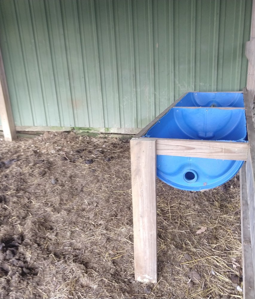

Here's what I came up with using 55 gallon plastic drum and some scavenged 2 by and reused wood screws.. I cut the barrel off center a few inches so the waterer has more capacity than the feeder.
I also placed bung holes at the bottom for ease of draining / cleaning. Waterer bung had a crack, so I gooped the inside up with silicone. As soon as it sets, I'll screw in the bung and check for leaks. Width of the barrel is 24 inches, but you can make it fit tight at 23 inches.
I rate this approximately 1 hour cattle feeder/waterer project easy. Plus the materials were free. Can't beat that price 😂 It would have taken me a good two hours to go buy one from rural king. So there's the time saved also.

It looks good although I'd add some cross braces so it last longer. More weight but sturdier.
8,488
19,528
Water is heavy. Will you need bottom support? Maybe a steel strap?
Otherwise looks good...that would be my only concern...lotta water will fit in there.
12,080
25,717
Thanks 😁 Water 8lbs per gallon. Say 30 gallons to be safe. 240 lbs I think the woodscrews will hold it. If not I'll reenforce.
