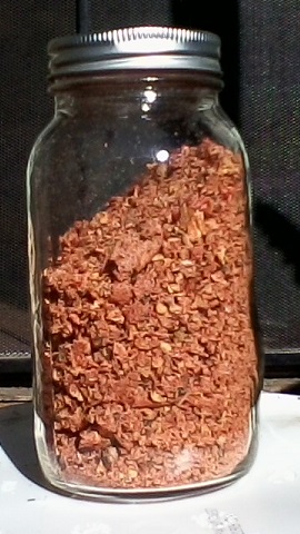

FD Salsa.jpg My freeze-dried salsa worked out great! This 1 quart jar is what I have of the 1 1/2 quarts I started out with. It takes about 1part salsa to 3parts water to make a decent texture. I also did some mixed frozen veggies that were sitting in the freezer, a package of boneless skinless chicken thighs (raw) and 1 lone pepper-crusted steak. I should have cut the steak into thinner slices, because the 1 inch thick cut was too thick- I've had to put a whole bunch of extra time into the final drying time on it. I will let you know how the chicken turns out later this week when I use some up for dinner.
