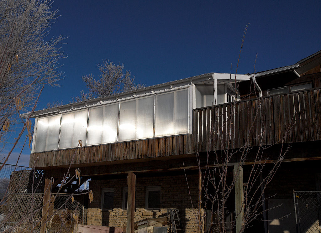

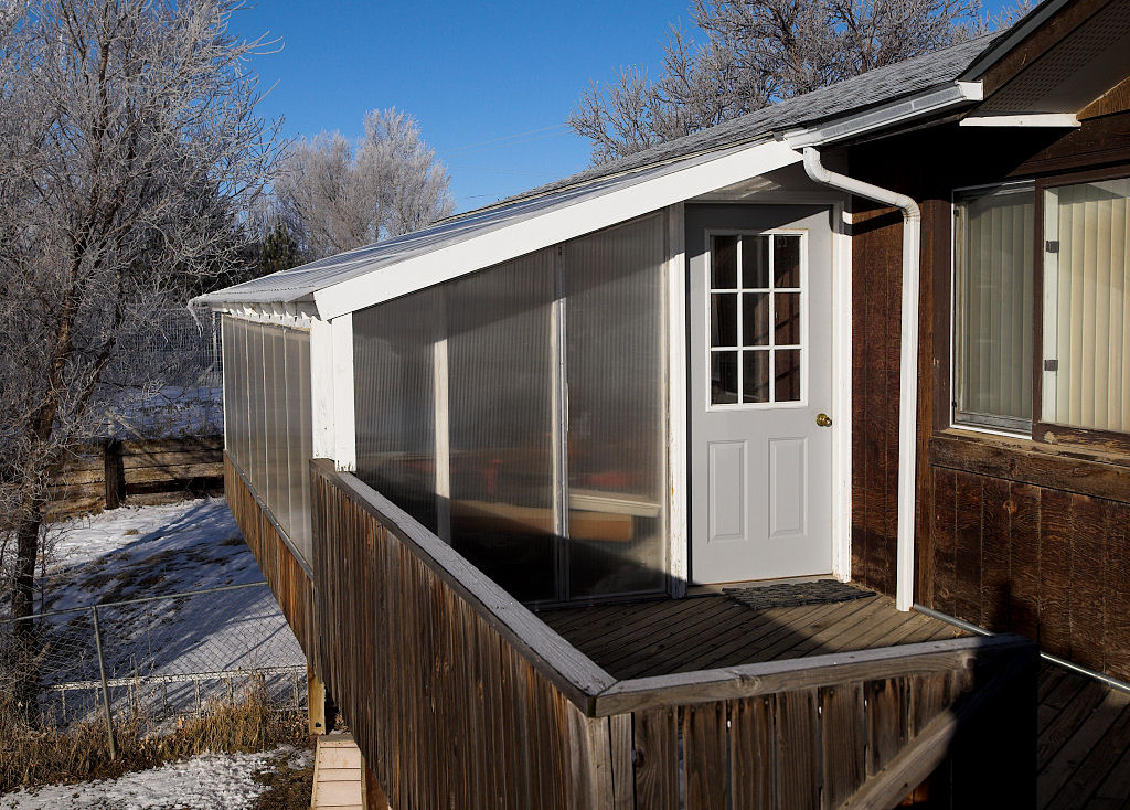

I dont think the wide day-night temp fluctuation helps plants much. Mine is on patio pavers that retain some heat so it does better in late fall than early spring.
Mine is on my deck with a window to a bedroom in the house. I leave the window open during the winter. I put insulation under the greenhouse floor. I do not keep plants in it from December through February. In March I have an electric heater rigged up with a thermostat to prevent freezing temperatures.
I want my greenhouse on the deck right against my patio door. DH says no because the gaps between the deck boards. (Isn't that why God gave us green treated plywood?!)
R2elk
Jan 25, 2021
525
2,040
Natrona County, Wyoming
I insulated under the greenhouse and covered that with cheap flooring plywood. For the floor of the greenhouse, I put the same stuff over the deck 2"x4"s covering the gaps. I put a wood grain linoleum over top of the flooring plywood. No gaps to be seen now.
