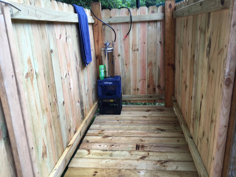

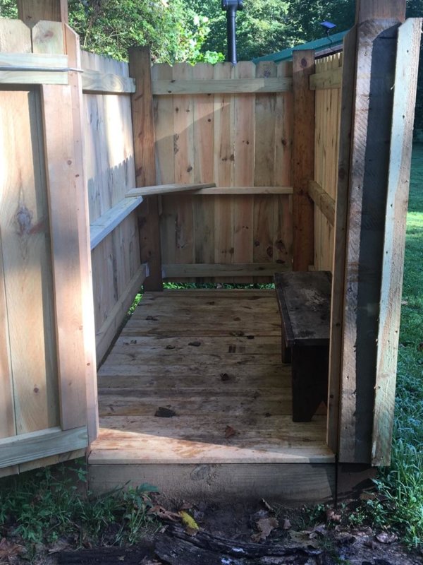

Ok so I was at camp this weekend finished the enclosure, the shower door has an old time screen door spring so it SNAPS closed like an old wooden screen door. Next camp weekend ill work on the floor and building up a gravel base for drainage.

Almost done, but was able to use the shower this week end at camp.

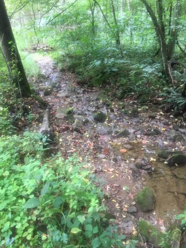

IMG_0594.jpg Foraged creek rock

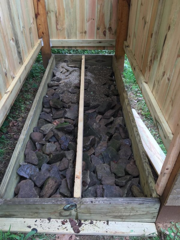

IMG_0598.jpg placed landscape plastic, built frame, placed rock and pea gravel for drainage
IMG_0599.jpg Zodi and deck boards

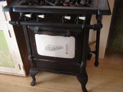

Our camp is in Ritchie County WV . When we first built the cabin we used a 3 burner perfection kerosene stove that was purchased at a Amish auction. The Amish use these in the summer often because their large wood stove gets their house to hot. We found that the kerosene stove created a smell that penetrated all our food and clothing even sealed in plastic Rubbermaid containers or sealed bags. The food even tasted like kerosene probably because the cabin is small. We since upgraded to an old Dangler 4 burner stove vintage 1930/40 that we found in a Amish appliance store . We converted it to propane and its in amazing condition (attached a pic of a similar stove I found on internet ) . The Zodi came with a burner that uses small Colman propane cylinders I'm thinking my stove is more efficient and if needed I could use the camp fire.
300818839333.jpg similar to the Dangler stove

Thanks for all the info Getty this site is a great place to share experiences. I noticed that on the Butterfly stove it has 22 individual wicks in comparison to the perfection that uses a one cylinder type wick ( see attached ) do you think that the multiple wicks produce more efficient combustion reducing fumes ? Most the Amish by me use the perfection inside the house in the kitchen area along with the wood wood cook stove. It seems they have a laundry area in a breezeway area between the main house and the Grandparent house ( they call it the Doddy house which is smaller ). They usually use a wood fired pot belly stove to heat water for the laundry and bathing. The Zodi worked out good it seemed like it only took 5-10 minutes to heat the 3 gallons of water to shower temp. I was a bit concerned how much we would need to pump it to pressurize it. I only needed to pump it twice 1st time 10 pumps and the second time 8 for a shower.
