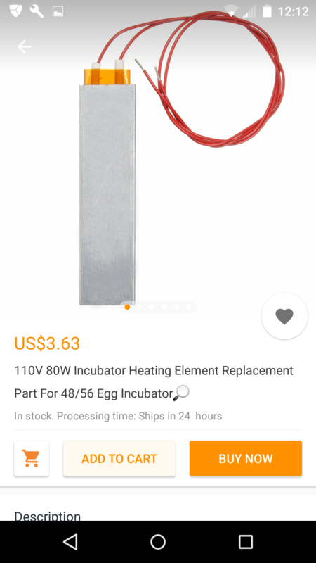

Lots of ways to skin a cat but here is a actual heating element (80 watts) / (46 to 58 eggs) designed for a incubator. Your guess of 100 watts was spot on!

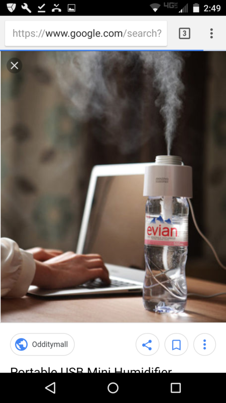

Ok... Now you done went and sparked my curiosity. I'm just gonna have to take my wife's humidifier apart and see how it works. I'll have to make up some lame excuse about how its not working right or something because she does like it when I take something apart that's not broken. I suspect all I'm going to find is a water proof heating element though.
I did find this mini humidifier that looks kind of interesting and might work for a incubator. It runs off USB so 5V DC should power it up.
Now just need a controller board, a power supply, thermostat, hydrometer and I think I might be in business. Getting all this stuff in a neat little electronics case is going to be the challenging part.
