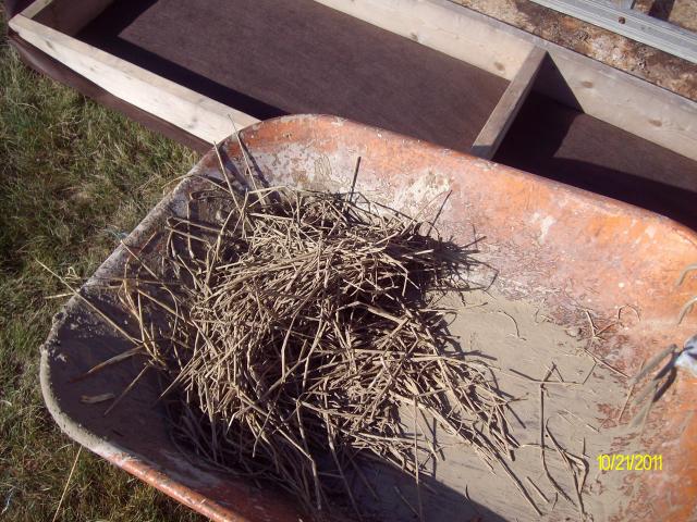

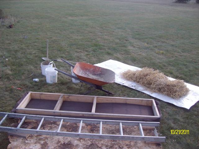

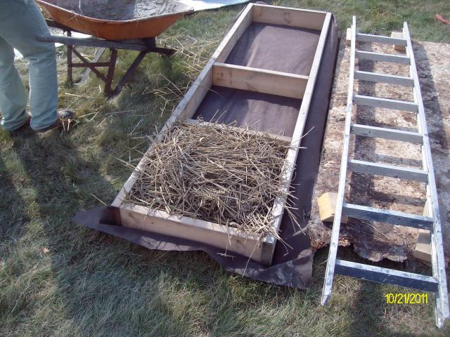

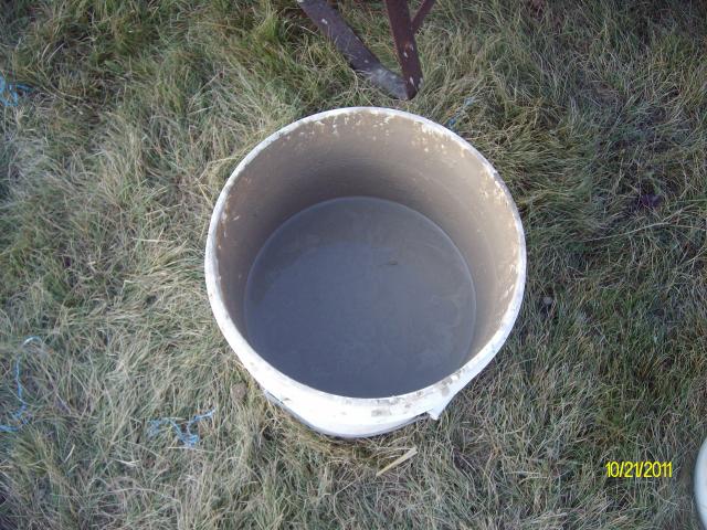

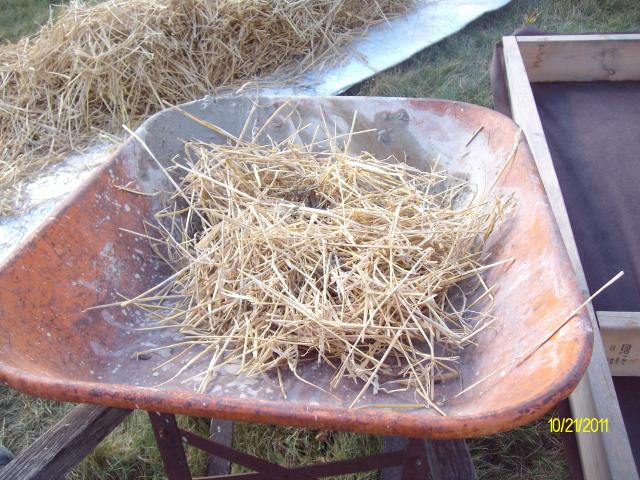

Things on the cob home have slowed to a crawl, mainly because of the weather, but today we made our own slip straw insulation.
My soulmate created a form that was 8x2. Inside that form he created three sections.
We had to mix clay slurry onto the straw and then place the straw into the forms and then tamp. Now we need to wait for them to dry, which could take up to a month, depends on the weather. :rolleyes:
These are going into our floor.
The thickness is roughly 6 inches....which should give us a R value of 10, if we were eager and wanted to do 12 inches, then we would have almost an R20 value.

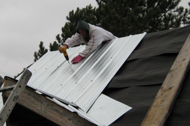

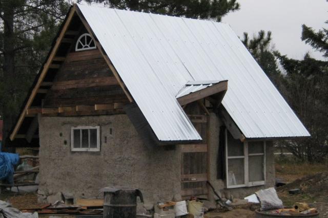

It took a few weeks, but our roofing material finally made it here!
And can you believe we have a few nice days left in Novemeber to put it up??WOW!
My soulmate thinks we can have it up in one day, only if we can keep out 3 yr old little girl preoccupied with something....
First we lay the foam, then sheetmetal and lastly the ridge cap. viola we're done!
I want us on the roof by 7 am....and I hope that we will have a completed roof tomorrow night!
So excited! :celebrate

Well, we certainly had a very productive weekend. It is so gratifying to know we are almost at the end, and yet so sad, to see the cob studio being finished.
It was very exciting to learn each challenge and embrace it, in the meantime knowing there was another level to conquer. I loved it all, although, I can't say I was much help in some aspects of the different stages. The most challenging for me, was the drywall stacking of our stone foundation and the rafters, but I made a valiant effort with as much muscle I could muster.
There is plenty more to learn as the building changes with the seasons and offers us new lessons on how to improve our self sufficiency. Next on our agenda is installing a slipstraw floor. Rocket Stove. Inground refrigerator/freezer. Trombe wall. Wool insulation. Cattail insulation. And last, but not least, a solar panel.
I will keep posting on whatever milestone comes our way, and let you know what lessons we learned.
