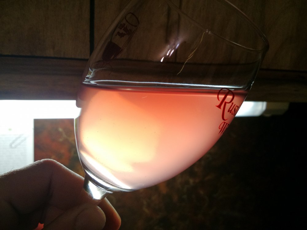

I would never have guessed that strawberry wine was not red.
Me too, but just because a strawberry is red on the outside doesn't mean the wine will turn out red. Unless artificially colored. I guess most everyone tastes with their eyes, as much as they do with their nose and tongue. My wife said I don't care what color it is as long as its good. I agree with her, so Golden Strawberry Wine will remain Golden with no artificial flavorings or colors. The way it's supposed to be :)

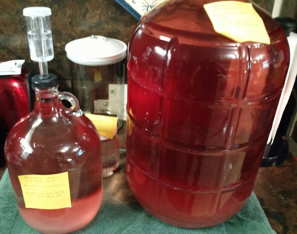

6 gallons plus a pint of Blueberry wine. 1.097 starting gravity/.990 final gravity or 14.5% alcohol by volume. It's ready to be racked and back sweetened. I need to get it off the dead yeast and lees that has settled out on the bottom, before it creates off flavors. Its nice its cleared out now and I can actually see the dead yeast and lees on the bottom. I'm surprised to see it's turn a pretty shade of red. Contrary to popular belief, blueberry juice is naturally red, unless you add blue food coloring :sick

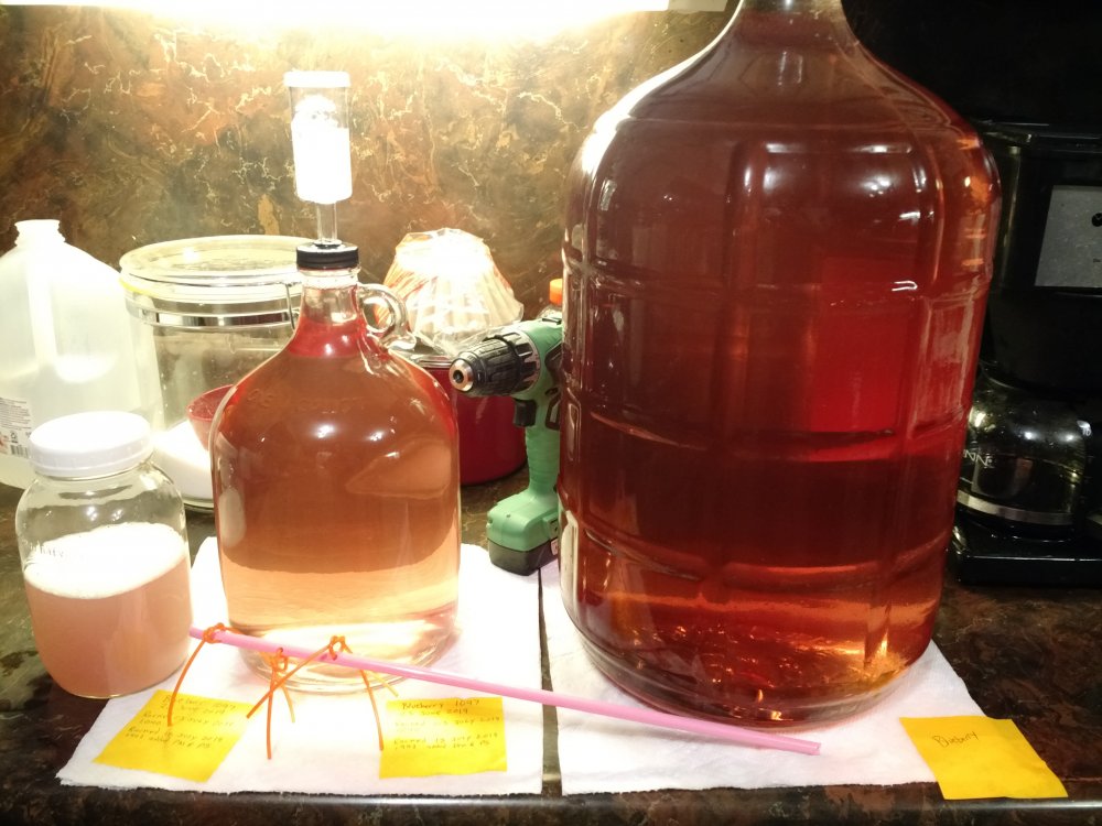

I racked, back sweetened to gravity of 1.000 and degassed the Blueberry last night. I want to let is sit another week or so before I bottle it. Just to make sure I didn't pick up any lees during racking that could settle out in the bottles.
My wife helped me with back sweetening, its really a two person job. One to slowly add sugar and one to stir so it all dissolves. Out of necessity, I made a whisk to attach to my drill with a plastic coat hanger and some length of weed Wacker line. It worked well for stirring and degassing. Amazing how much CO2 was in the wine. I whipped it up to a froth. The whisk is the pink thing pictured.

Your whisk is ingenious! Way to create the tools that you need.
Do you use regular table sugar to back sweeten or a bakers sugar which dissolves faster?
12,257
26,386
Regular table sugar, it dissolves pretty easy adding a little at a time and whisk it in.
I've been reading and they say to create a syrup with 2 parts sugar to 1 part boiling water. But honestly adding sugar directly seems way easier than cooling down the syrup to room temperature and plus no added water to the wine. I also add a campden tablet (potassium metabisulfite) per gallon at the same time so I'm not concerned with picking up a secondary infection.

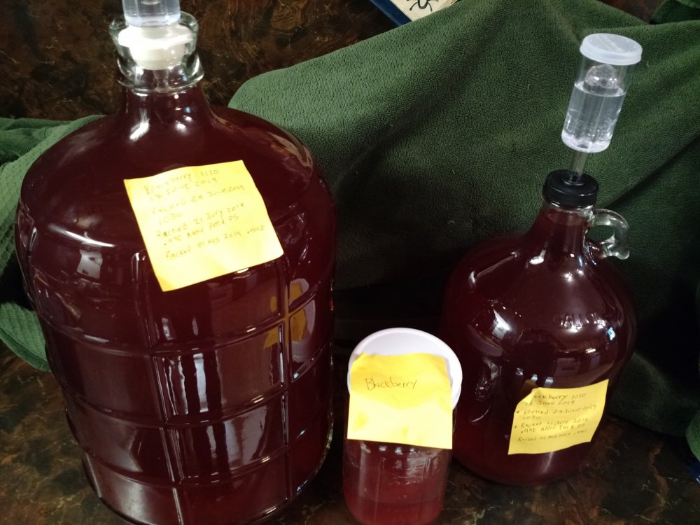

Trying to decide if my blackberry wine is ready to bottle. It's not clear enough yet.
I don't know if you can see in the picture the super tiny bubbles of CO2 in the glass or not. This batch has been in the making 2 months. I have not back sweetened it, its super dry @.990 gravity (water is 1.000) but I like the taste just the way it is. I'll rack it into a fermenting bucket, de-gas it in bulk, add benonite fining and the rack it back into the carboy and jug then stick it back in the deep freezer for another week. See what it looks like when I inspect it again.
