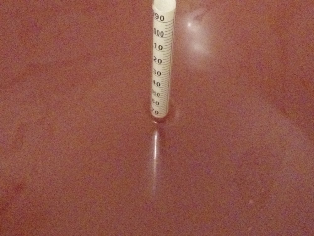

23 June gravity 1072 approx 2.8% alcohol by volume produced so far. Nightly gravity reading at stir.
Notes: ferment slowly ramping up / racking and yeast nutrient addition seemed to help.

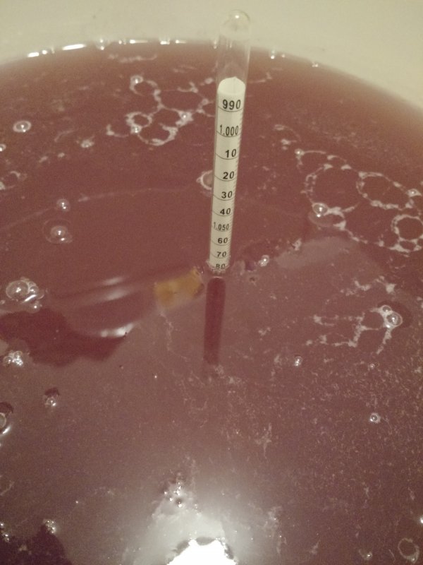

25 June gravity 1062 approx 4.3% alcohol by volume produced so far. Nightly gravity reading at stir.
Notes: \o/ hooray! ferment picked up blowing multiple consecutive bubbles every 3 seconds. Yeast made 1.3% alcohol in less than 24 hours. That's a very active ferment :) Looks like adding 1 gallon of water and 1 lb 12 oz of sugar did the trick. I'm not counting my chickens until the eggs have hatched though. We'll see what tomorrow evenings hydrometer reading is. Because this is a very challenging wine for a beginner to make. I've learned a lot from this wine so far.

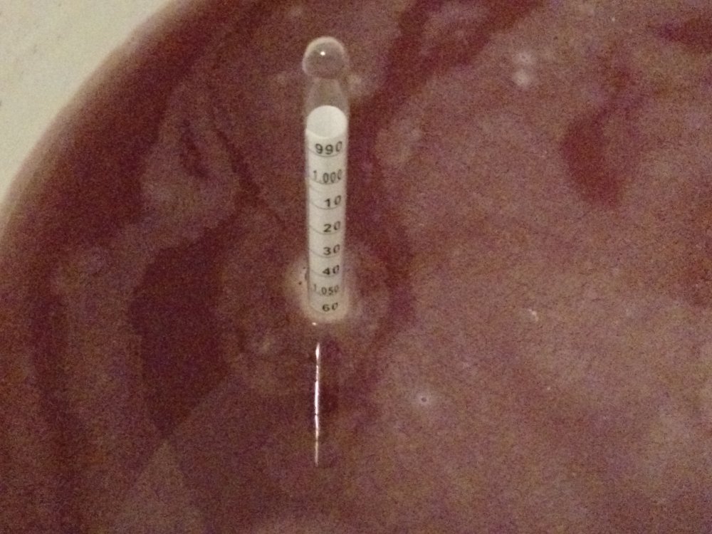

26 June gravity 1050 approx 5.9% alcohol by volume produced so far. Nightly gravity reading at stir.
Notes: \o/ hooray! I got it fired back up and fermenting nicely.

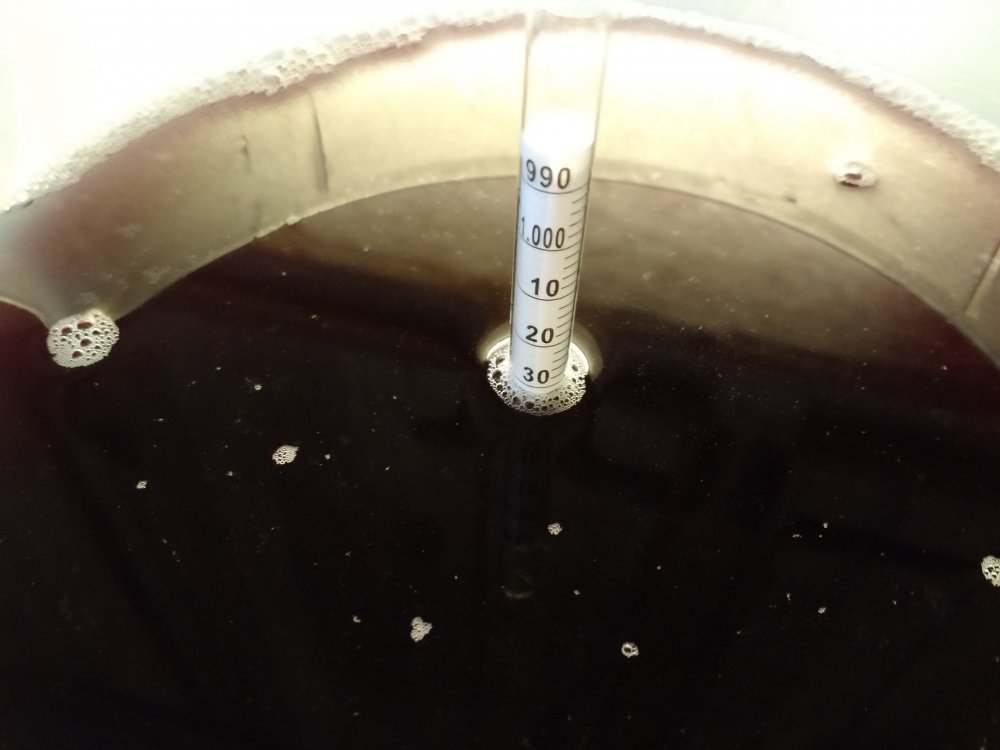

27 June gravity 1040 approx 7.25% alcohol by volume produced so far. Nightly gravity reading at stir.
Notes: most definitely fired back up and fermenting nicely with a gain of 1.35% alcohol by volume in 24 hours, that a great fermentation rate. However, seeing this wine has given me such a fit, I'm going to leave well enough alone and not increase the alcohol level, I'll finish it as is. Its ready to rack now, but I'm going to wait another day or two, just to be sure it stays lit (keeps on fermenting).

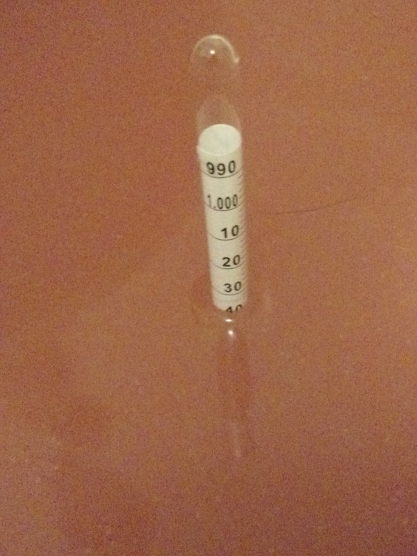

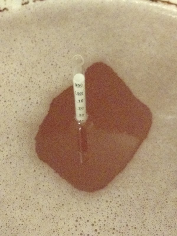

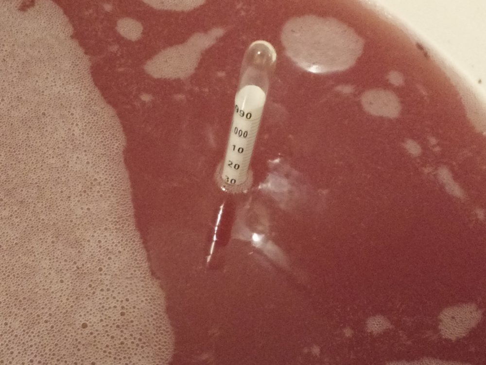

28 June gravity 1030 approx 8.6% alcohol by volume produced so far. Nightly gravity reading at stir.

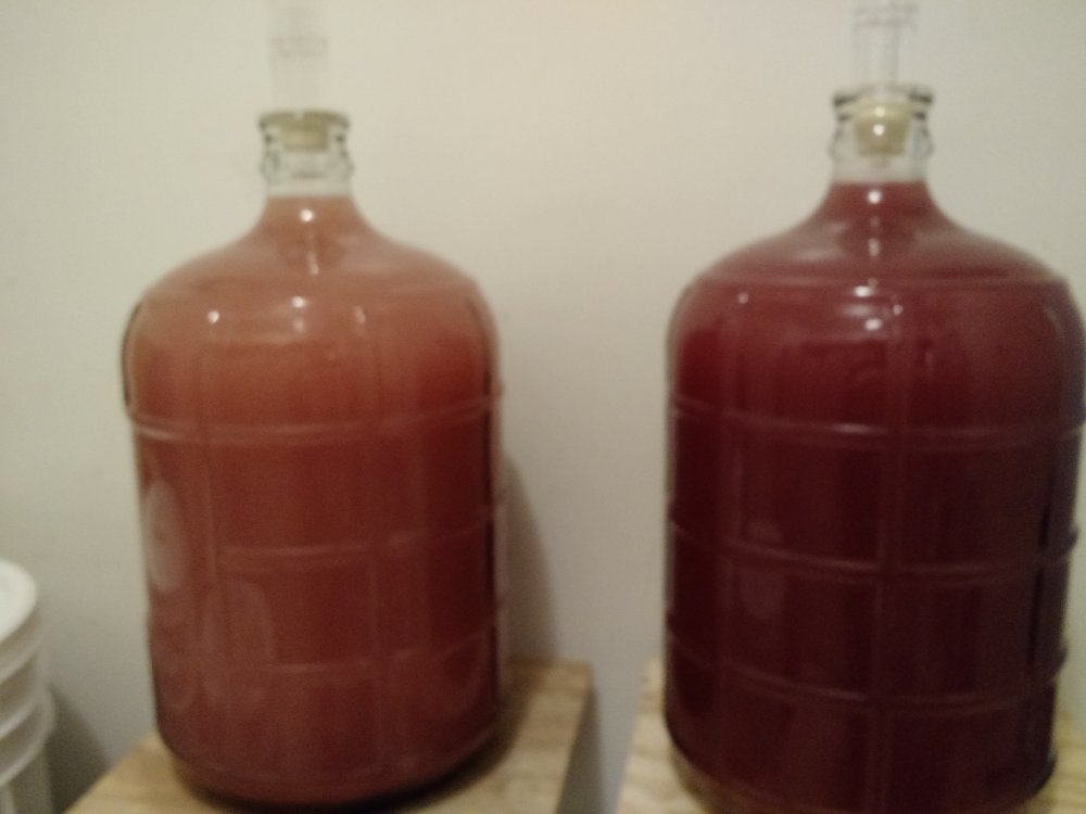

Notes I went ahead and racked into secondary. However i racked through a length of copper pipe, because of the sulfur it produced early on. Yielded 5 gallons plus a little for the newbie wine maker. Tastes good, I have a good feeling this is going turn out wonderful.
3 gallons cranberry on the left, blackberry on the right

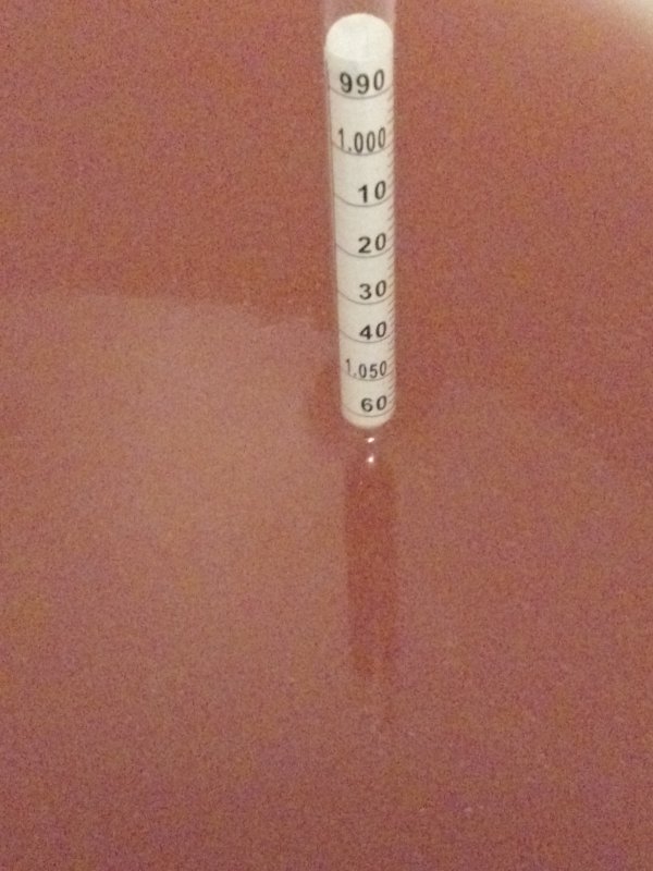

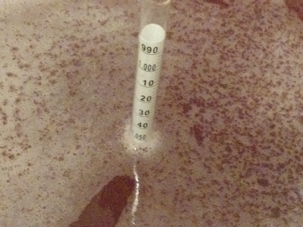

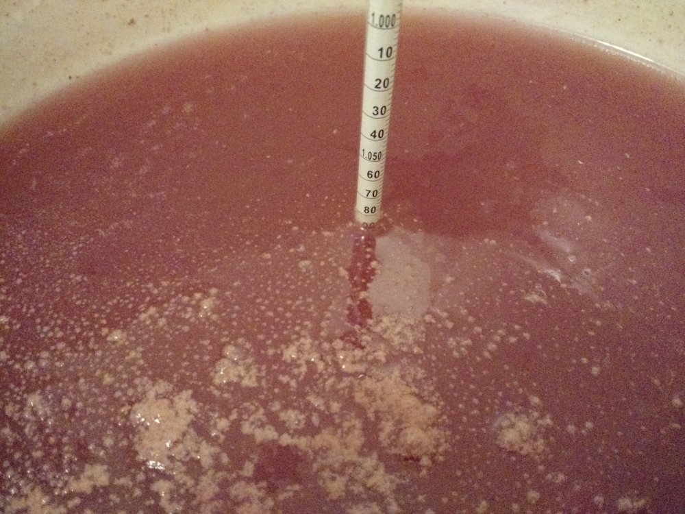

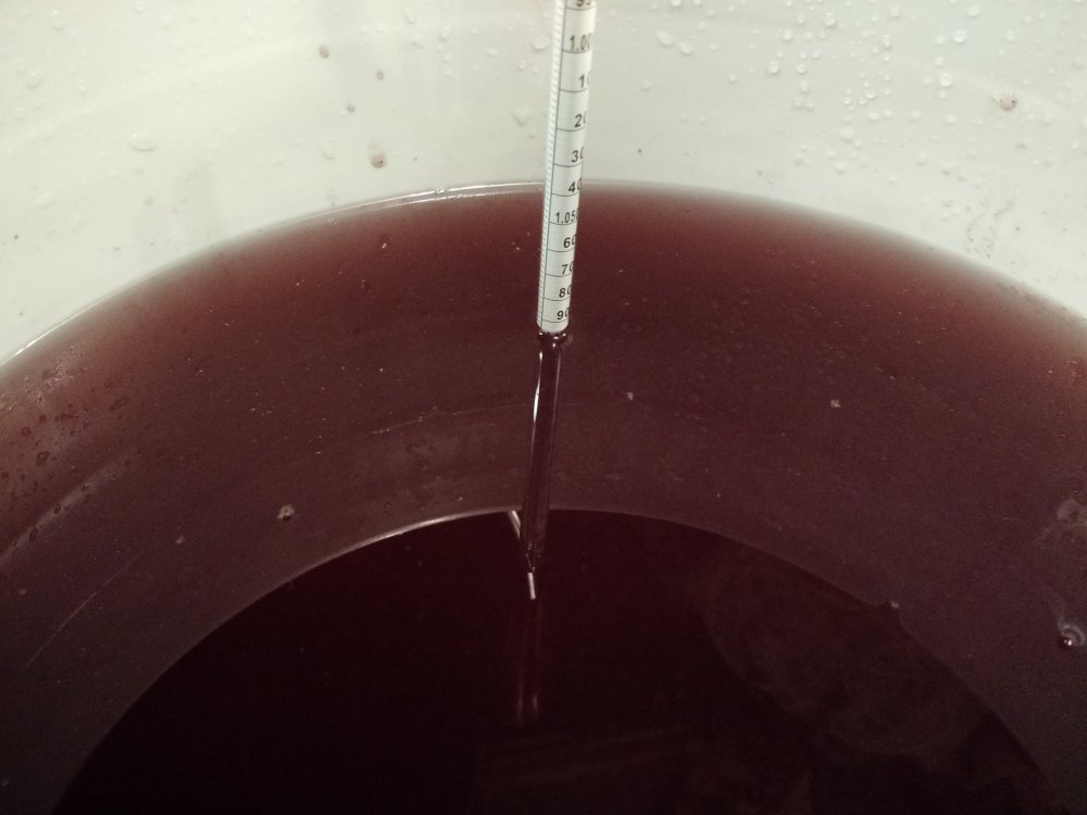

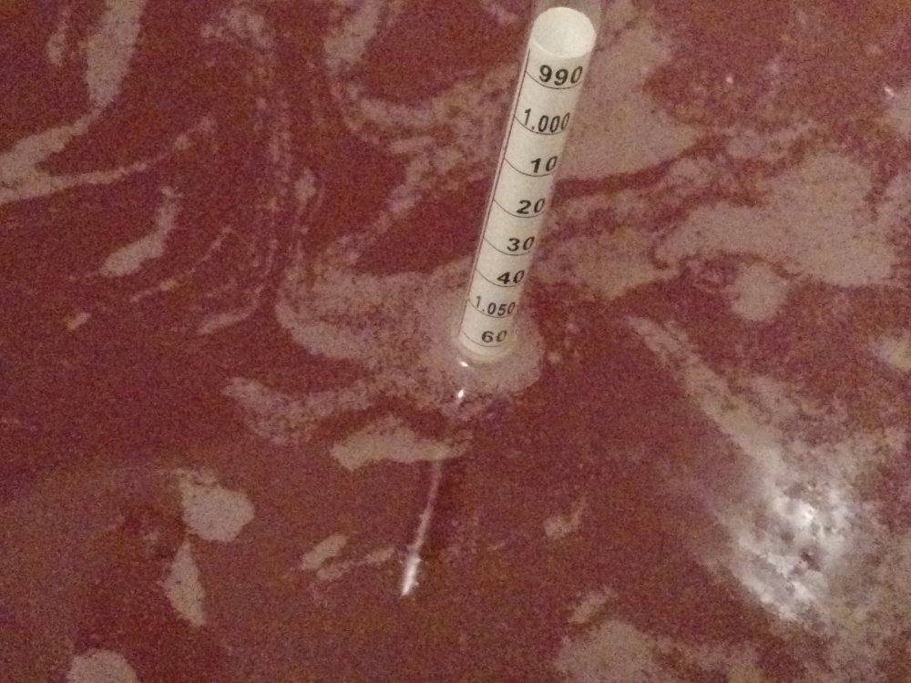

25 June gravity 1.050 approx 7.75% alcohol by volume produced so far. Nightly gravity reading at stir. Blurry pic but is 1.050
Notes: This batch is really a pleasure to work with, despite the addition of 1 lb 5 oz of sugar the morning of 24 June, fermentation has not missed a beat and is still extremely active. This batch should be ready to rack into secondary in 2 or 3 days once the gravity falls to 1.040 or a little less.

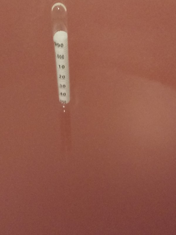

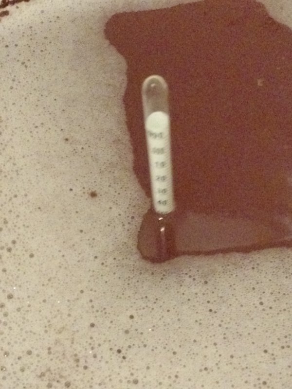

26 June gravity 1.040 approx 9.1.% alcohol by volume produced so far. Nightly gravity reading at stir.
Notes: I snuck a little taste - Mmmm lip smacking delicious / After taking gravity reading I poured the top 3 gallons into a clean and sanitized bucket, the last gallon I poured through my large funnel with fine screen. I then rinsed the original bucket and funnel of sediments and cleaned and sanitized the bucket. Then I poured the entire 4 gallons back into the original bucket, re-lided and air locked the bucket. / this batch will be ready to rack into secondary in a few days. It sure will be nice to get this wine into clear glass carboy, so I can observe its progress and not have to stir it every morning and evening and also take nightly hydrometer readings.

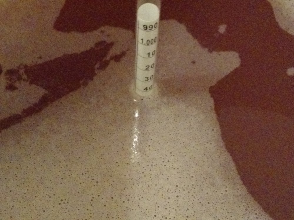

27 June gravity 1.030 approx 10.5.% alcohol by volume produced so far. Nightly gravity reading at stir.
Notes: I went ahead and racked into secondary glass fermenter. Yielded 4 gallons, one 3 gallon glass carboy topped and one 1 gallon glass jug topped. Plus about 4 ounces for the newbie wine maker :) 10.5% it has a bit of a kick to it now, but is lip smacking good.

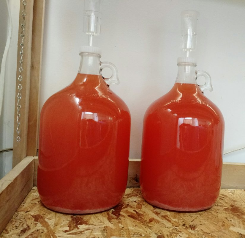

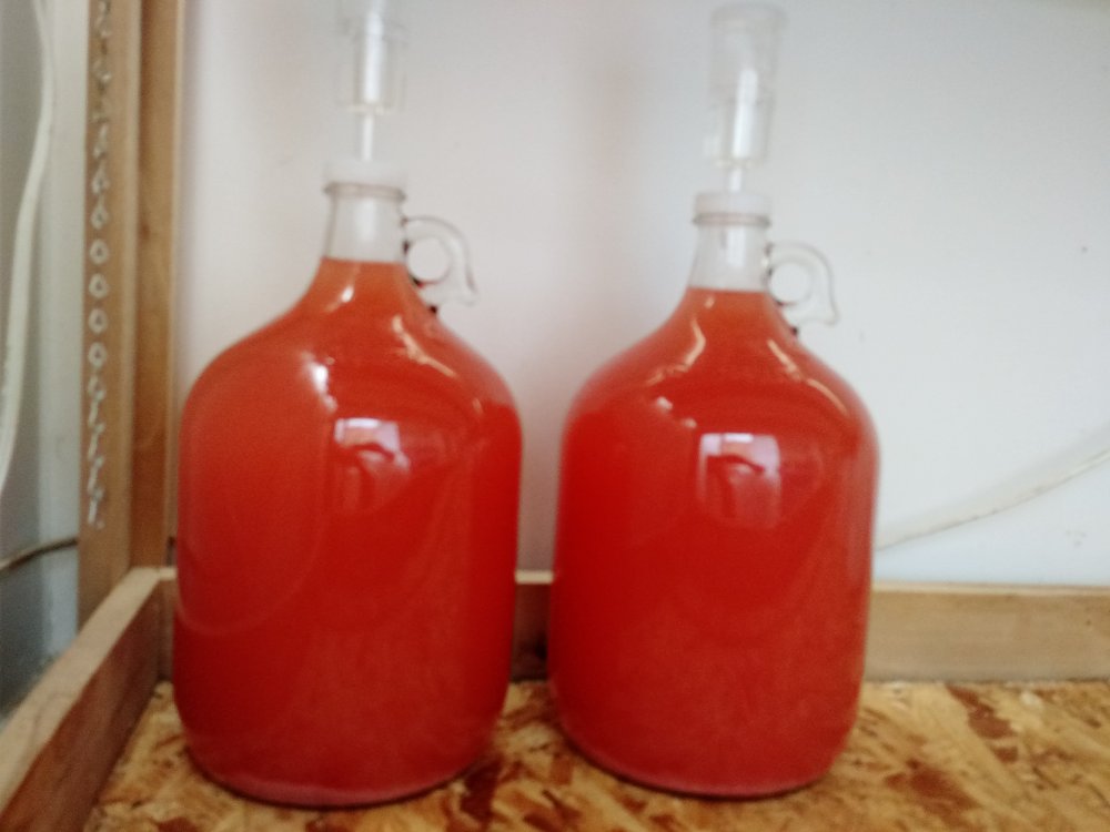

Strawberry 1090 started 01 June 2019
https://www.sufficientself.com/threads/strawberry-1090.16158/
20 June (day 19) Notes: in secondary since 11 June (9 days) / bubble through airlock one every 15 seconds / fermentation is still very much active. Nice bright color & pleasant strawberry/alcohol aroma from airlock / thick layer of sediment. Will need to be racked again soon to get it off the sediment.
27 June (day 28) Notes: in secondary since 11 June (17 days) / fermentation is still active. Nice bright color & pleasant strawberry/alcohol aroma from airlock / thick layer of sediment. Will need to be racked again soon to get it off the sediment.

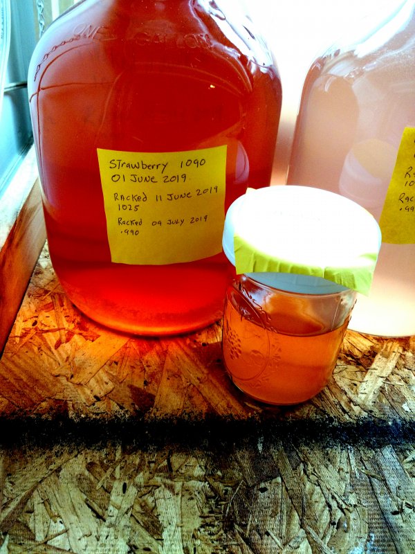

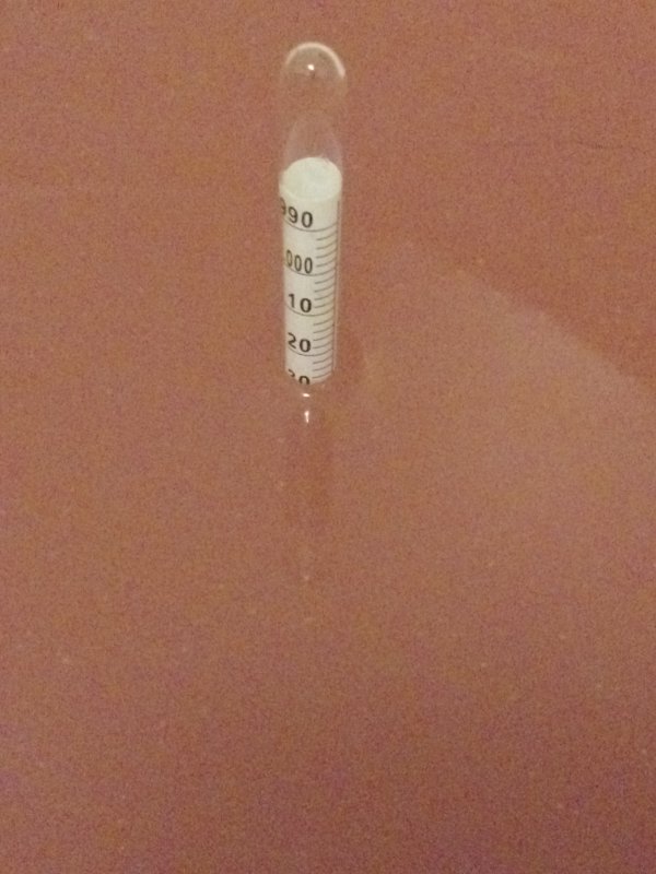

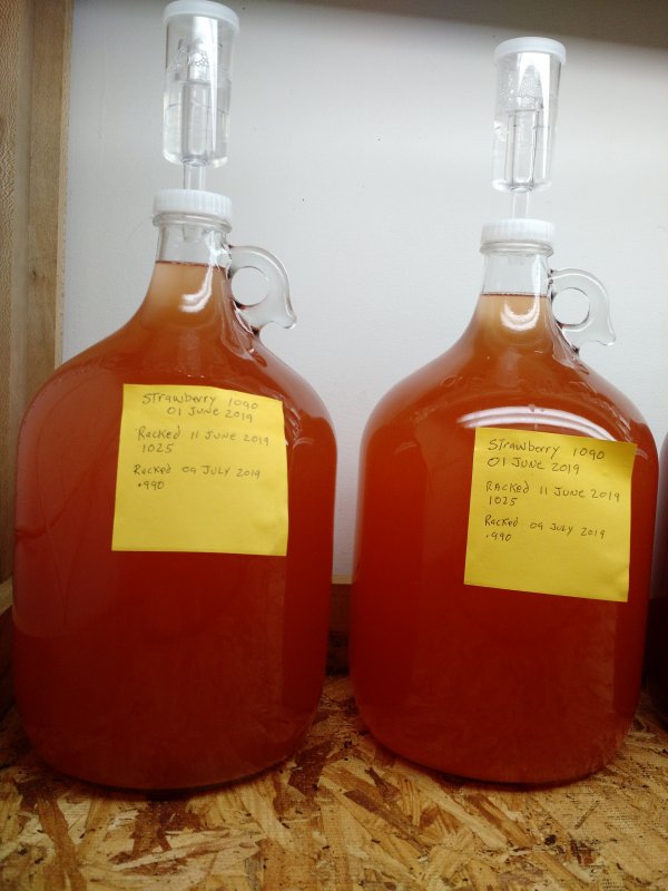

09 July (day 39) Bubbles completely stopped. Pulled a hydrometer reading of .990 or 13.5% alcohol. Racked and topped both gallons again into sanitized 1 gallon jugs, to clear. Clearing has already started in the necks of the jugs. This should make a nice Strawberry Rosé if all goes well from here on out.
17 July (day 47) - natural clearing continues, its nice to see light shining though a bottle. The 1/2 pint jar has been cold crashed and will be the final color of this batch of strawberry wine. It will be more of an orange than red, unless I add a drop or two of red food coloring. Time to get to this point is not bad at all, only 47 days since making. Next racking will be the final racking before stabilizing, back sweetening and bottling.

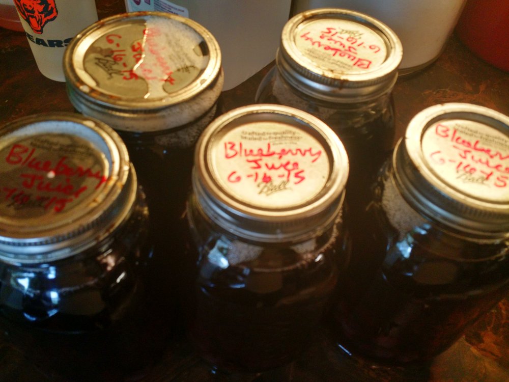

Its a rainy day :( what else is a guy to do but raid the wife's canning shelf, for something to make wine out of. What's this? 5 quarts of blueberry juice from 2015. Actually is more like blueberries in light syrup - nice!

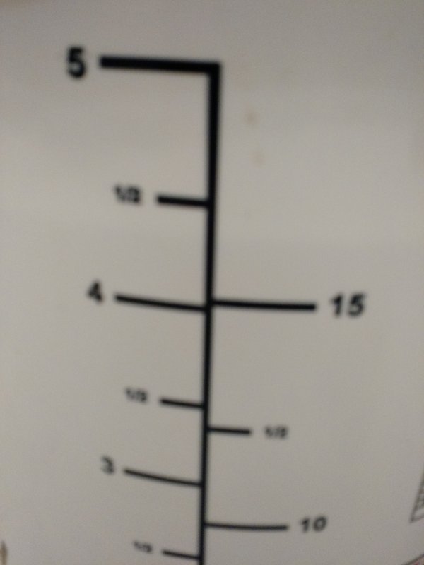

To the pot I added a little more than 3 1/2 gallons of water and heated just to warm. I calculated I need about 7 lbs of sugar to bring the the juice and 3 1/2 gallons of water to a starting gravity of 1.090. So I poured the blueberry juice in one if my ferment buckets along with a little over 3 1/2 gallons of warm water. Then I measured out 7 lbs of sugar and stirred it in real well. I took a gravity reading and determined that, darn I can still do math. 1.092 is close enough for government work :)
A little under 4 1/2 gallons of must

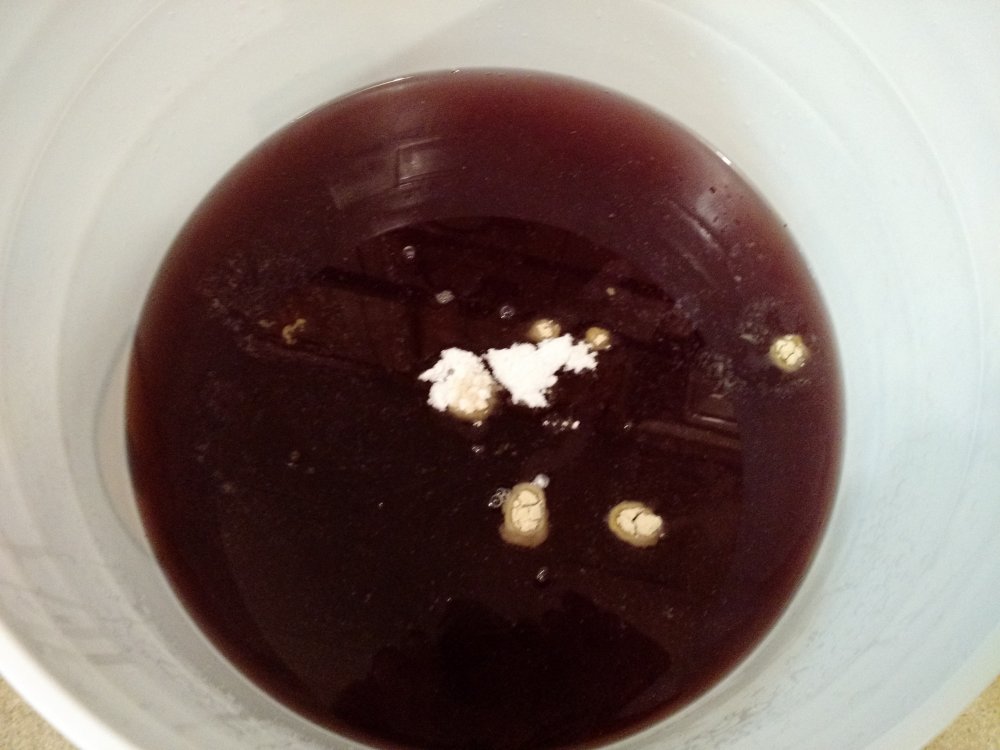

Next I added the chemicals as per the recipe and stirred in real well.
And fitted my fermentation bag over the bucket and emptied all those delicious blueberries into the bag. I lifted the bag and squeezed the blueberries inside the bag to mash them a little. Then I re-fitted the bag over the bucket, fitted the lid and set in with the other two wine I have fermenting. I'll pitch a Montrachet yeast starter about 1:00 pm tomorrow to give the requred 24 hours time for campden to gas off.

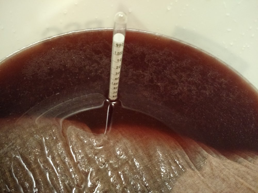

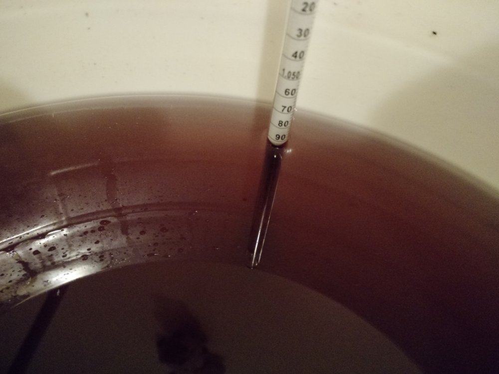

24 June - I pulled the fermentation bag and squeezed out as much liquid as I could. Then I took the starting gravity reading 1.093 or about 12.5% alcohol potential. Stirred in red star Montrachet yeast started, covered and air locked the fermentation bucket. Hopefully this will turn out to be a nice bodied violet colored wine.

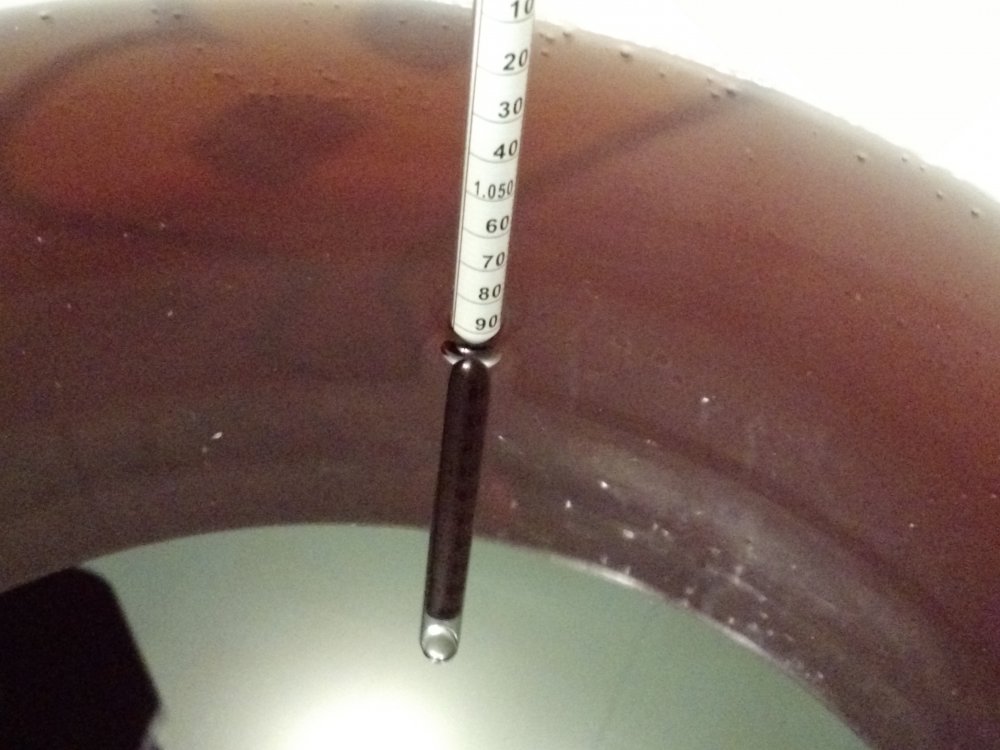

I added 1 gallon of purified drinking water to drop the starting gravity & dillute the must with hopes of getting this blueberry must fermenting. I also poured the must into a clean sanitized bucket and back again twice to oxygenate the must. I will need to add 1lb 8 oz of sugar once it's fermenting strongly to bring the starting gravity back to the original. I also made a yeast starter with 2 cups of must, 2 cups distilled water, two teaspoons sugar and a pinch of yeast nutrient. My plan is to add 2 more cups of must to the starter for 2 days then add the 1/2 gallon yeast starter into the now 5 1/2 gallons of blueberry must. Blueberry is the hardest to get fermenting out of all wines. I'm such a glutton for punishment... But nothing ventured nothing gained. Its a opportunity to learn new things and if I can't figure it out there's always the drain.

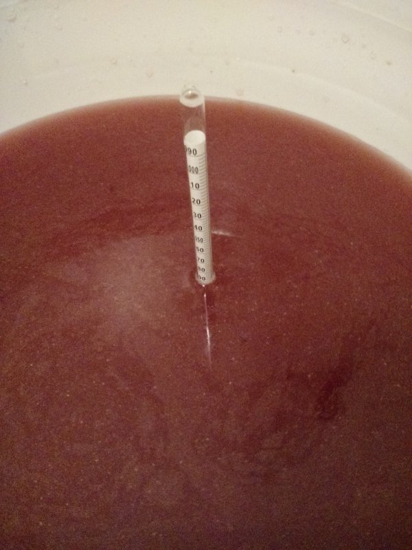

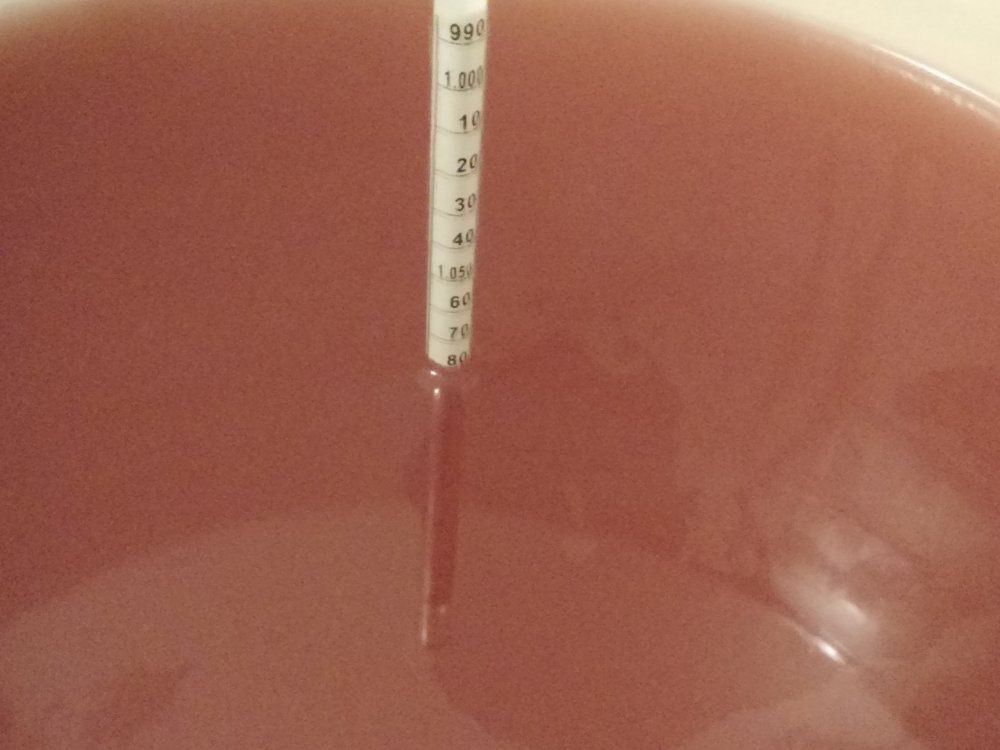

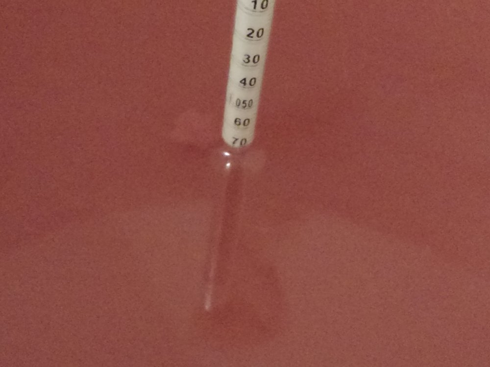

1.082 gravity after addition of 1 gallon of water.

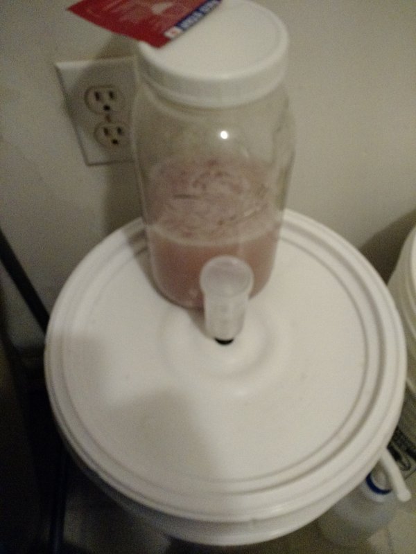

Yeast starter
27 June morning notes: I awoke this morning to find both the yeast starter and must in the fermentation bucket aggressively fermenting. Looks like adding 1 gallon of water and oxygenating the must got it started finally \o/ . I went ahead and added the yeast starter anyways, since it won't hurt anything. I'll let it ramp up a few days and then add 1 lb 5 oz of sugar to get the starting gravity back up to around 1.092. Finally got it started, horray \o/

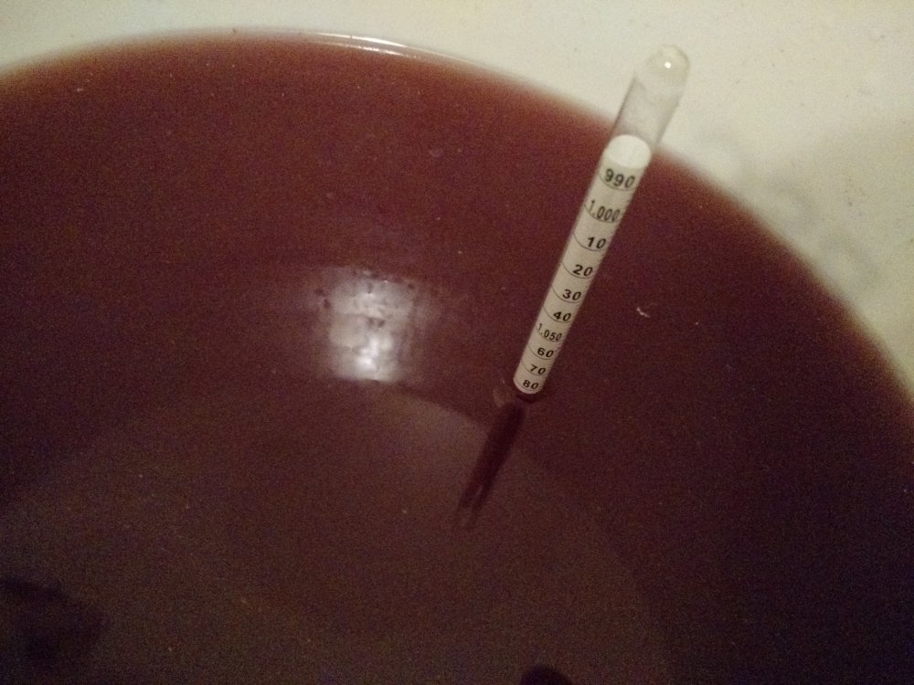

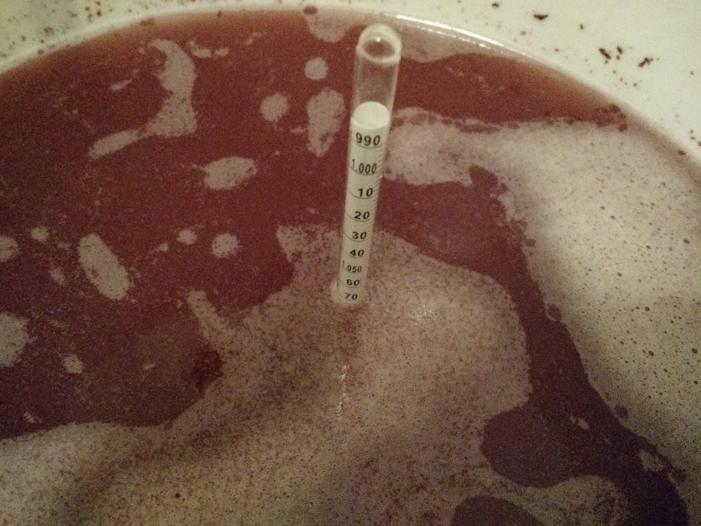

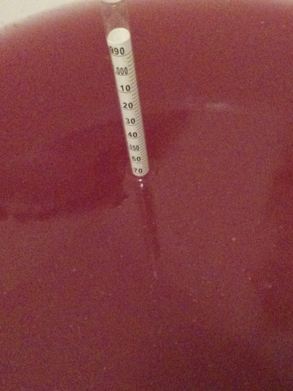

27 June gravity 1.072 for reference only
