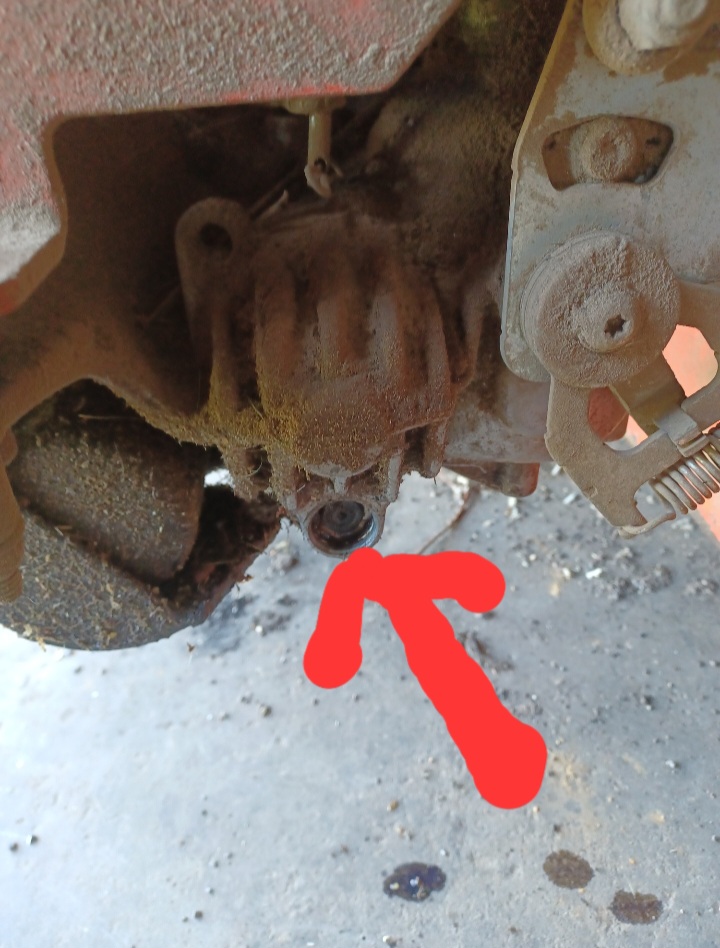

I filled the gas and fired up the zero turn mower to pull it out of the barn this morning. No steering :oops:. I shut it off and looked at a big puddle of oil under the mower. I put a little steering fluid in the reservoir, it was bone dry. Then I managed to get it to the door.
This is what happens when a wood worker plugs a hole, that needs plugged.
Missing plug.

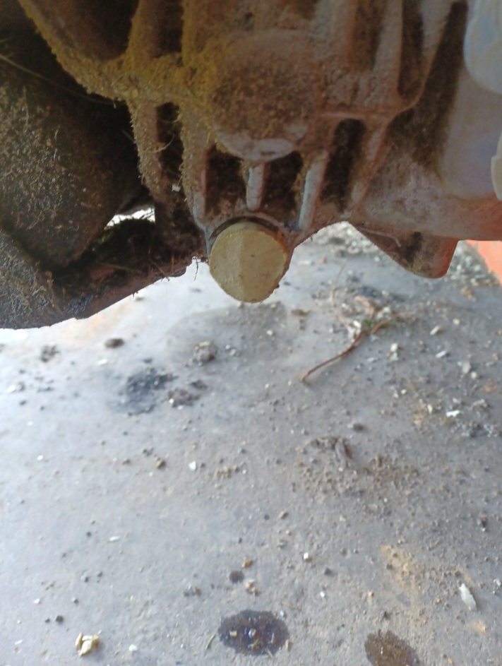

I whittled down a oversized poplar dowl with my pocket knife and beat it in with a hammer. It fixed the leak and the wood will do nothing but swell when the oil hits it and make the plug even tighter.
I filled the reservoir, still no leak and FB has been mowing with no issue so far :thumbsup.
I will order a plug from the manufacturer, but atleast the mower is up and operational.

Finally got around to finding out what the part number is I need.
I called the manufacturer, they transferred me to the parts department, no one answered.
Looked on the manufacturer website, sent an email with attached pictures. Got a reply back in like 5 minutes. With the part number and a link to dealers to buy from.
I called the first dealer no answer.
Called the second dealer. They didn't have it in stock. Took my name and number said they would order from the manufacturer and call me when I could pick it up.
About 4 hours later the second dealer calls me tells me the manufacturer is out of stock. But he found another dealer, but by the time it would get to his shop it would be 10x the price. I said nah... I whittled a oversized poplar dowl with my pocket knife and beat it in with a hammer. It may last a lifetime or it may fall out next mow IDK... He bust out laughing and said he's seen some redneck stuff in his day but he ain't never seen anyone do that, you must be king redneck. We both were laughing pretty hard. I said I had to get that hole plugged, my wife needed to mow. He laughed some more, then he said listen if you have an ebay account search for that part number, I pretty sure you'll find it there.
So I ebay'ed the part number and have 2 seal plugs ordered. Like 10x cheaper than if I would have the second dealer get it for me. Plus it gets shipped right to my door :thumbsup
I'm telling you the truth... I could have whittled many seal plugs with my pocket knife in the time I wasted trying to find that silly seal plug today :rolleyes:.
