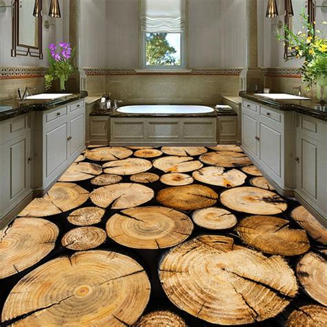

If I were to make my own flooring, using different size rounds, same question. Would mortar between rounds be ok and what kind?
Check out WiseBond Deep Pour or one of the many knock offs. Basically it's a clear 2 part epoxy resin that's pourable and self leveling.
A wood cookie floor that's so cool. I would go a minimum of 2" thick cookies so you have plenty to sand before running out. I would also think about the same finish for the floor. But I would also call WiseBond and get someone on the phone who knows more than I do.
https://www.wisebond.com/collections/deep-pour-epoxy-resin
I once did a record album floor with bartop finish. It also is a two part epoxy but it was before the deep pour epoxies came out in the mainstream.
How does that hold up to floor traffic, mud, sand and so forth? And how does it hold up to years of use and abuse as a counter top?
That's kind of the neat thing about that deep pour expoxy. When it gets beat up badly, you just sand down past the ugly and buff it out to a good as new finish. It's pretty tough stuff when it dries. I wouldn't go using it as a butcher block or anything like that though. Give WiseBond a call I'm sure they will answer any questions you may have.
Edit... here's one where the tinted the epoxy black to make the cookies pop.
maybe this is two pours a black first and clear over top?
