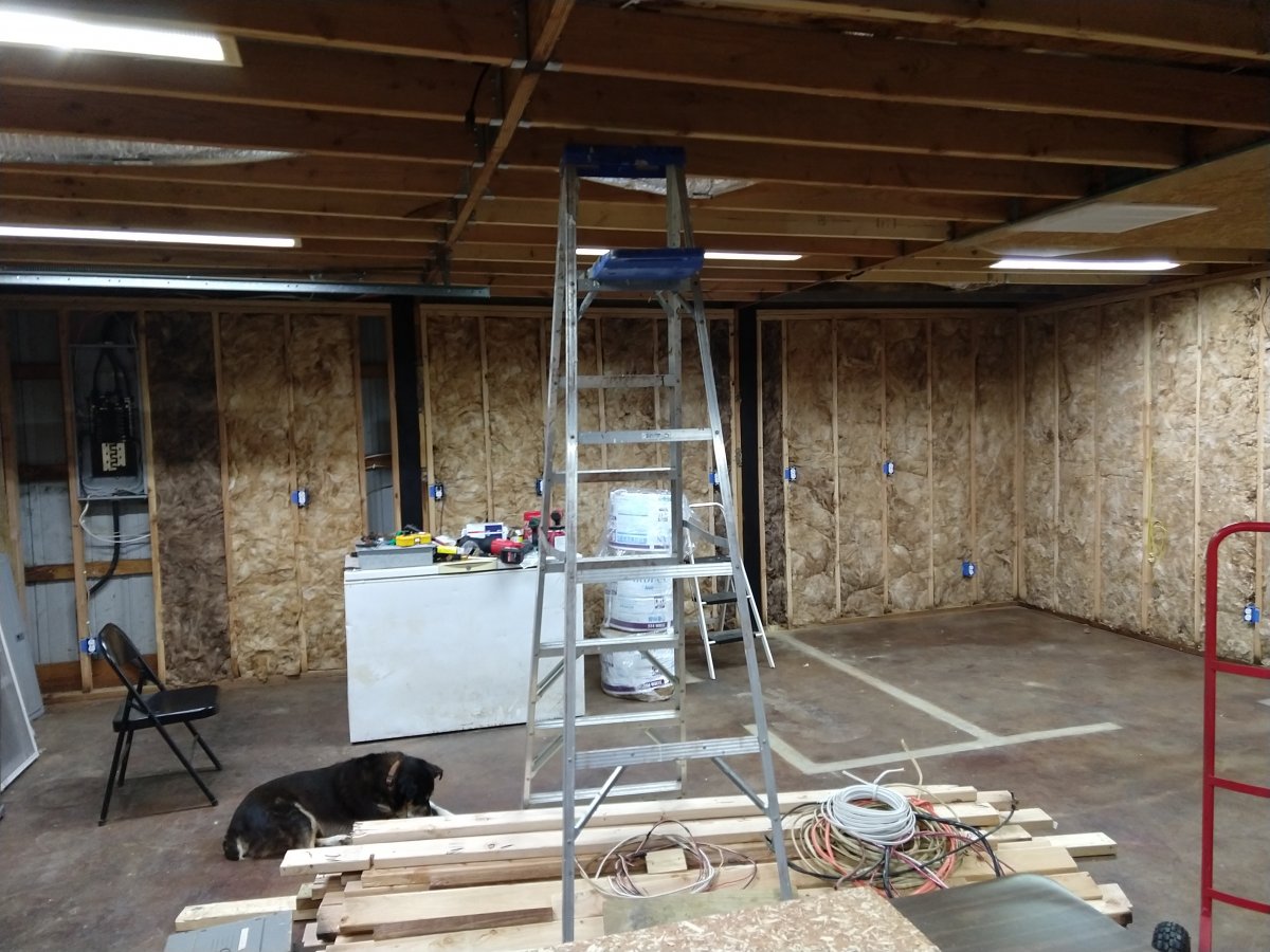

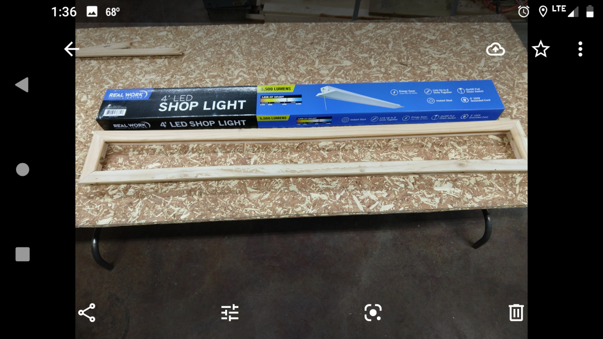

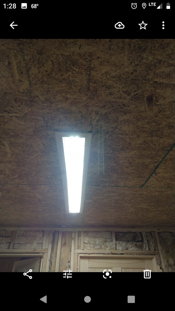

More "man cave" stuff Rural King had a Rudy special on 4' shop lights. These things are strong, 5500 lumens with color of 5000K, which is basically white but only consumes 50 watts or less than 1/2 amp at 110 volts. Thats less than a 60 watt lightbulb. So I bought 10 of them.

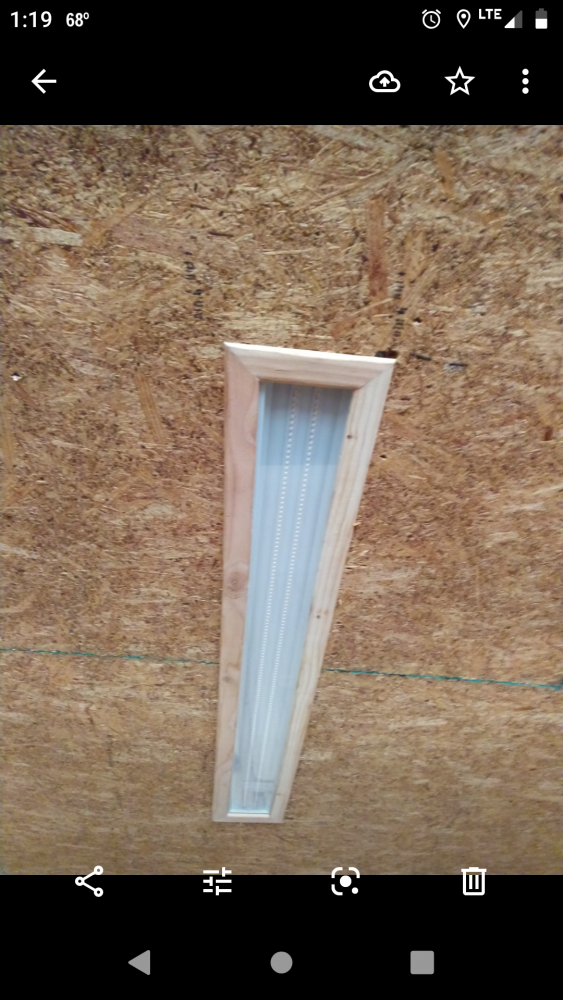

Now how to hang them??? I came up with a quick recessed frame made out of some 2x4-10 that I had laying around. I haven't used my tablesaw in a long time but the math came back to me real quick. Basically the frames were made with the fence set at 1 1/2 and 1/4 inches and adjustment of the blade height. Easy smeazy plus they look pretty good recessed into the ceiling. 8 of these bad boys, lights up the 23 x 27 multi-purpose room in "the man cave"
Three construction screws hold the frame to a ceiling ceiling joist and the light floats in the frame held by gravity. I wired each light to have it's own recipical so if one dies it's easy to push it up into the ceiling unplug it and replace with a new one.
Light on
With wiring (14 guage) recipicals, switch, boxes, frame the lumber and a little brain power, I have a very lightly lit huge room for about 20.00 a fixture. You can't beat that with a stick. Plus they will be easy on the electric bill. I consider it a win.
Light and frame. I highly recommend these rural King lights. But wait until they go on sale, it's even a better deal.

I also tore out the walls that we're for a kitchenette and bathroom. Wired one of the 27 foot walls for our chest freezer, a 7' countertop, an electric stove, another 7' countertop, a upright freezer and a refrigerator. Once completed it should be all we need to have family dinners and holidays in the multi-purpose room.

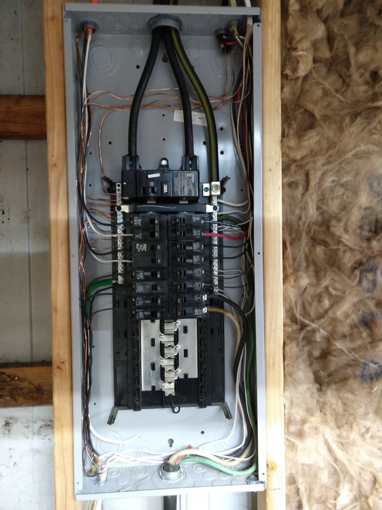

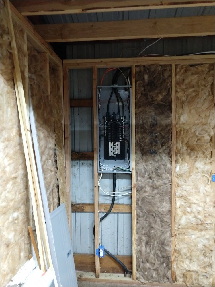

I also switched all the wiring to underground feeders wires did away with the old fuse box and started wiring all my branch circuits into the new 200 amp breaker box, much safer now.
All the branch circuits are home run to the main panel box. And dedicated branch circuits for lights and recipiticals. Each freezer and refrigerator are also dedicated circuits. This is the way I was taught to wire. The wiring in the pannel box is pretty tidy also. I think my old college professor, would give me an A for this wiring job.
There's still a ton left to do, but it's going to have to wait until building materials come down in price. No way I'm paying stupid high prices for what I need to finish it, with a OSB plywood ceiling and drywall for the walls. The lumber is not a problem, since I own a sawmill and woodshop :)
