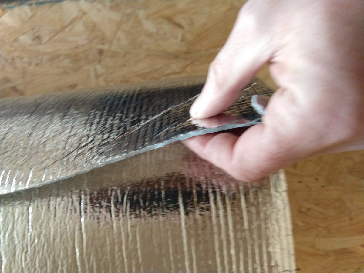

I went ahead and ordered a roll of 1/8"x4'x50' NASATech AD3 from eBay. Below are it's characteristics. But an R value of over 15 for something that's 1/8" thick is almost stupid ridiculous, +1 for NASA. I figured I could use the excess in my incubator that I would like to complete soon.
  • EXTREMELY EFFECTIVE - Reflect 97% of radiant energy, perfect RADIANT BARRIER. R-value up to 15.62 (1 layer), up to 21.10 (2 layers) (building envelope)
  • Non-toxic, non-carcinogenic, fiber-free, safe to handle and does not require protective clothing or respirators to install. Easy to install and maintenance free, cuts easily with utility knife or scissors and installs easier than fiberglass. Simply staple, nail, glue or use a spray adhesive to hold in place! No mess, and no itchy fibers!
  • Waterproof, Not affected by moisture or humidity. Inhibits condensation and does not promote the growth of fungi, mold or mildew. Does not promote nesting of insects or rodents. Non-flammable, flame retardant
  • Saves energy by reducing the stress on heating and cooling systems, keeping your home warmer in the winter, and cooler in the summer. It can reduce utility bills substantially all year round. As well as provides benefits of soundproofing
  • Class 1 Class A Fire Rated / Made in USA / Ships from USA / Super Fast Shipping
  • AD3 (1/8 thick) 4ftwide x 50ft Long

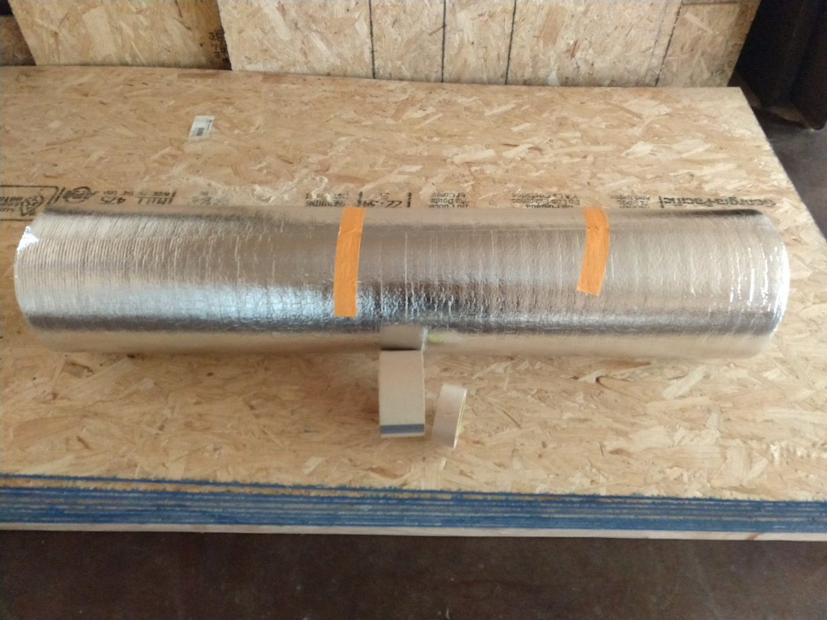

Perfect for my application, it's light as a feather, 1/8" thick insulation. Still amazed the stuff is rated at R15 for being 1/8" thick. If my garage door ends up looking like the inside of the space shuttle you know why. This is the same stuff they insulated the space shuttle with. Plus 1 for NASA. Along with ATA 400 double sided tape my son gave me. I'm just about ready to insulate the garage door.

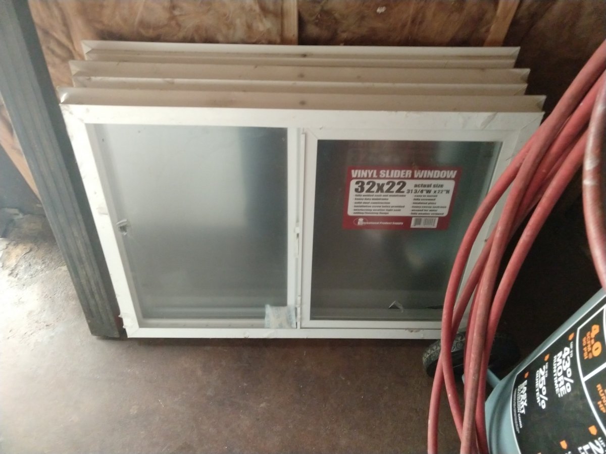

Will do... I still need to get some E-cips to hold some of the bolts in the door. The way the garage door was made it's not meant to be insulated. It was made to allow light into the garage which it does very well. So well as a matter of fact there are no windows in this multi purpose room and we need no lights on during the day. All that is about to change. I might eventually put in some clear panels on the roof and box in some sky lights, maybe we'll see... However, I already have 3 vinyl sliders that I may or may not install, IDK yet.
