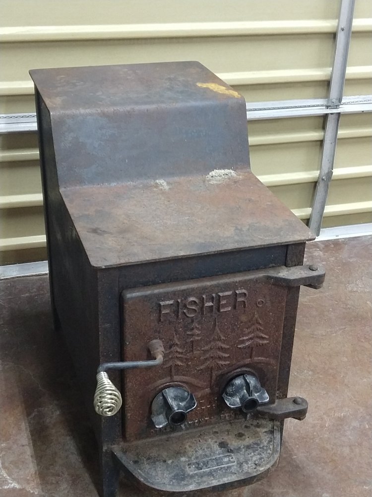

Seems like I always have several Homestead Improvement projects going on at the same time. This one is installing a wood stove. There's never a lazy moment around here.
First make sure the wood stove is a decent one and that it's in good shape (no visible daylight showing through seams/corners, etc...). If so, then weld up them up. Also size does matter... You want one that will heat the area you intend to place it in. Remember... When in doubt double the stout! That's my motto anyways.

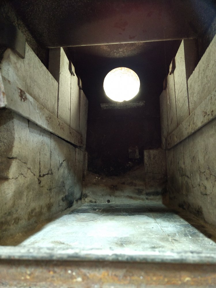

Now inspect the inside, all broken, mising, cracked fire brick will need to be replaced. I really you should inspect the fire brick, through out the heating season but at a maximum every year before heating season starts and replace the bad bricks.
As you can see I have a lot of brick to replace, more on that later.
