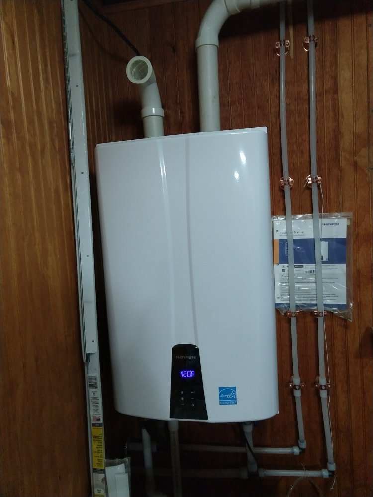

The farm came with a brand new tankless hot water heater, runs off propane. I absolutely love this thing, it's rated for 250 gallons per hour. My wife and I will never use that much hot water in an hour. If you can afford, get one - you won't be disappointed.
