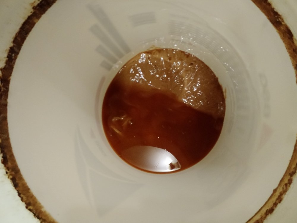

The starting gravity was 1.070, now it's 1.016 which puts the beer at 7.05% ABV so far. Now it's off to lager at 35 degrees for 6 weeks. But It was good green, cloudy and flat. I like the taste of Munich and Pilsen malts with just a little bit of Hallertau hops. It makes for a malty sweet beer.
the nasty part of brewing beer... the trub was a good inch thick in the bottom of the primary fermenting bucket. You can also see a ring around the top where it krausened. Lager yeast take their job seriously. More yeast for the septic tank. I bet my septic tanks is pretty clean with all the live wine and beer yeast, I've dumped down the drain.

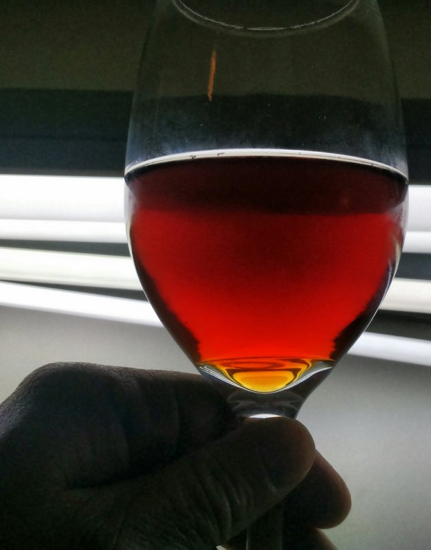

Now I have the true color of the beer. I can finish my label and make the Billy the color of the beer :)

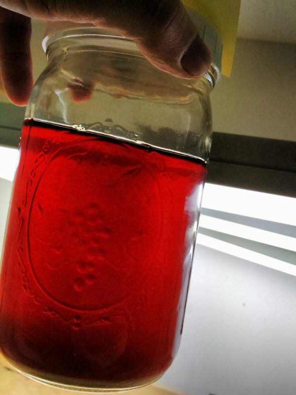

the what was a full quart My Bock finally dropped clear in the refrigerator. I wanted to save the quart for priming and topping off after lagering but I keep sneaking sips. It's a beautiful colored Bock and is really delicious even non carbonated. Looks like the Billy on my label is going to be red. Maybe I should color her dress the color of the beer instead??? A red Billy goat, yeah I don't know about all that!

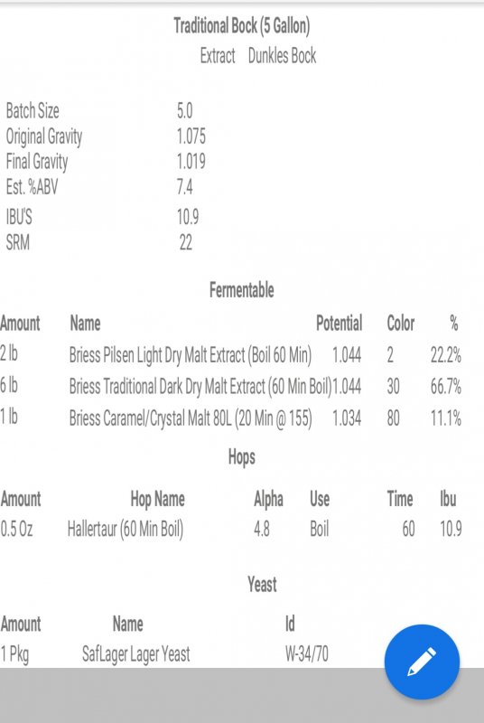

Here is my super complex recipe :lol: of course it has to be high in alcohol content or it's simply no fun... This beer is no coors lite, you'll actually be able to taste it.

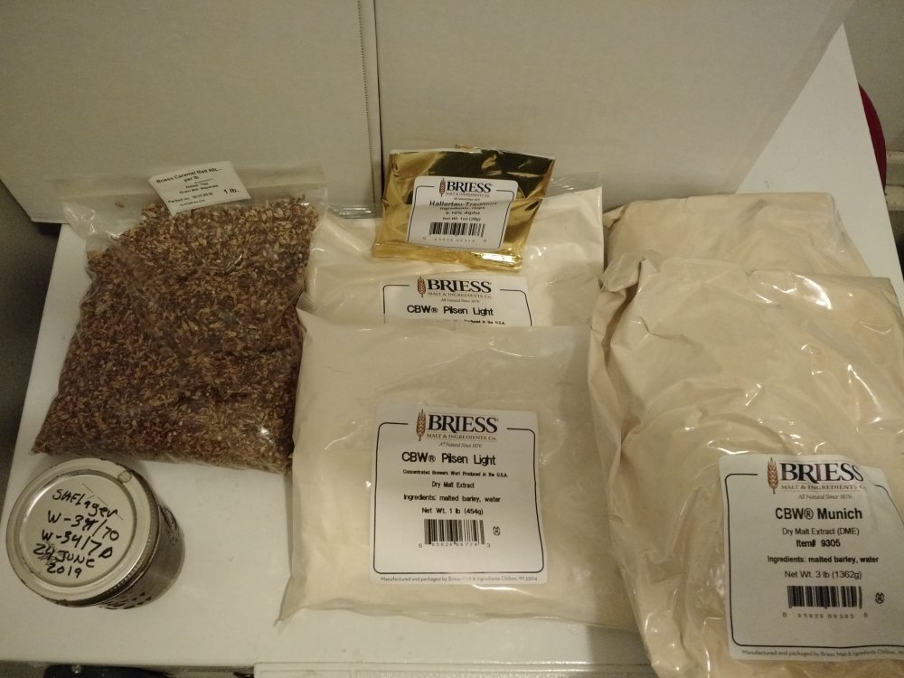

Here are my ingredients 9 lbs of barley, 1/2 ounce of hops and a harvested lager yeast starter. Geeze there's so many of them, however will I manage? -lol
Sometimes simple is the best, who needs all those fancy ingredients in today's beers? Lemons are for lemonade, rice is for stirr fry, corn is for eating and corn syrup and corn sugar is just plain nasty.

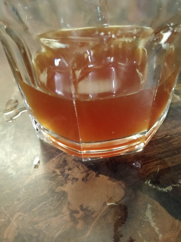

I'll drink this Bock for you then. It's spicy on the front end, from the Hallertau hops but finishes sweet, with enough alcohol to be warming on a cold winter's night. The best description I can come up with is, a spicy malt candy liqueur. It's very unique for me, I've not ever had beer that tasted quite like this Bock before.
It has just a very slight hop and barely aroma because I didn't add any aroma hops near the end of the boil, so you can detect the scent of barley. As of right now, I don't think I would change a thing about it. It's highly drinkable as is.
