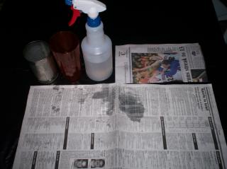

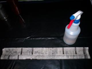

Here are the supplies needed to make the newspaper pots:
tin can- 15-16 oz size, end cut out
cup with tapered bottom
spray bottle with water
2 pieces newspaper- large page (~12"x21")
small piece- 1/4 of the large page

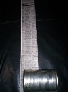

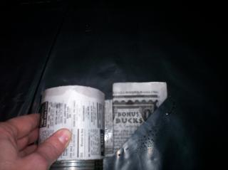

Making the Sides

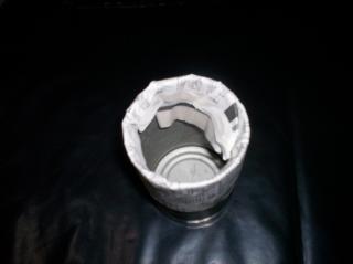

Fold the large page in half length-wise and then again in half length-wise. Spray lightly with water. This will give 4 paper thickness to the sides. Lay the tin can, open side to the left, on the newspaper strip, about 1/2 " from edge of paper. Roll the paper around the can.

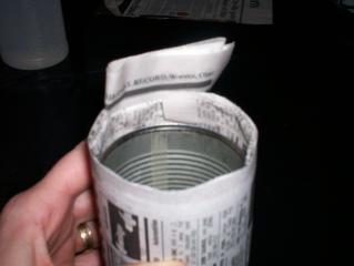

At the end of the paper strip, fold up a large diagonal tab, spray the paper protruding from the end of the can and fold over into the can.
Remove newspaper from the tin can and set aside for a minute. The folded over end is the bottom side of the pot.

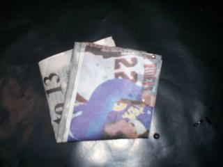

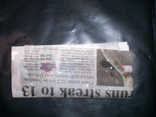

Using the second piece of newspaper, which is 1/4 size of the big page, fold it in half length-wise and again in half lenthwise.

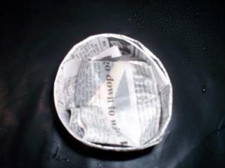

Now rotate the paper 90 degrees and fold in half again. If you make the fold a bit at an angle, it anchors the bottom of the pot better.

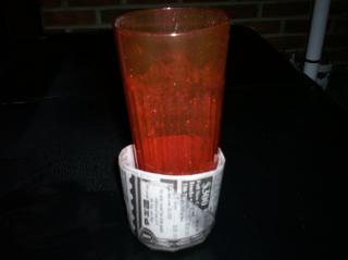

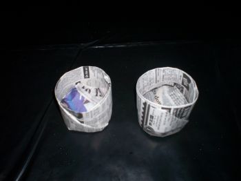

Next, push the folded little piece of paper down into the rolled up pot. Do not be too neat here- the bottom edges of the rolled up pot need to be spread out a bit. Then take the tapered cup and moosh the bottom piece into the rolled up pot. And there's your pot!
