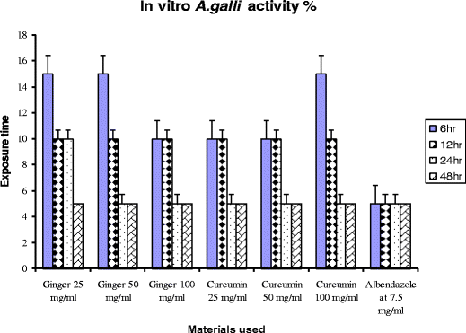

Different studies on different types of parasites and the use of ginger, curcumin, etc.
https://www.sciencedirect.com/science/article/abs/pii/S0001706X14002319
LIKE, LIKE, LIKE. Bee, you get all my bonus points for the day. I love it when statements are backed up by supportive studies, Love it even more when you post the meat of the study along with the reference!!!
