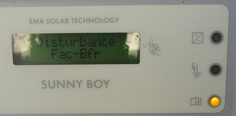

I logged into my solar control panel dashboard and was surprised to see no power today. I was then shocked that I havent been getting any power from my system since the 28th of last month!!!
:he
I went out to the inverter where I see the following:
Disturbance Fac-Bfr
Yellow blink twice, delay, long blink
I think this happened last year as well and we needed to have a tech come out to replace a fuse.
Such a bummer to loose out on all that power during some of the best days of the year!!!

Fortunately the company I use has been very helpful and responsive. They are also going to check to see why I didn't get the email alerts like I should be getting when this kind of thing happens.

Has this been resolved yet?
According to my husband, there are several things that could be happening.
1. This an AC fault, not a ground fault.
2. If you have a fuse disconnect between the inverter and the electrical panel box, those fuses may be blown and/or the breaker may be popped.
3. Wire may be undersized from the array to the house. This voltage drop would cause the inverter to disconnect and show this fault.
4. (Most unlikely but...) AC voltage and frequency not within acceptable limits for the inverter.
If you need more info, we could converse by PM.
If it has been resolved, what was it?
Nifty
Administrator
Nov 13, 2007
1,621
268
237
Turns out it was a blown fuse and may have been caused by a combo of a super hot day and a really bright day.
This is the second time this has happened in August, so they are evaluating if I can get by with a bigger fuse or if something else needs to be fixed.
