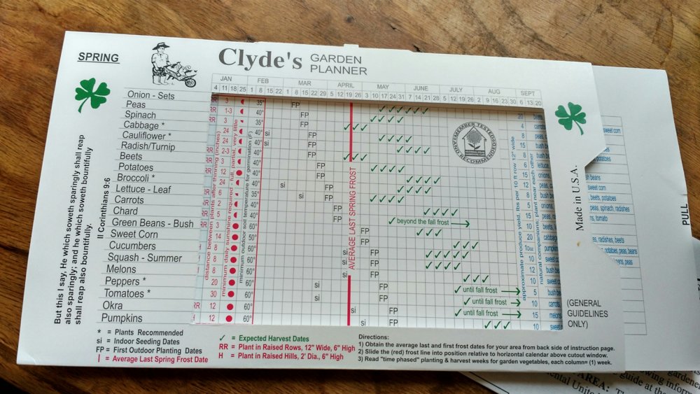

You are the same zone as me 6B, but I think I'm more in zone 7 most of the time. Spots in both my gardens are still to wet to sow in.
Here's what old Clyde has to say about our zone. He says, plant potatoes around the end of March. I most always plant a week or two early and rarely run into problems due to a hard freeze. My "rule of thumb" I don't set out any hardy transplants until the last 25 degrees overnight temperature has passed, 20 degrees for onions.

CrealCritter-- That's a pretty handy gadget!
