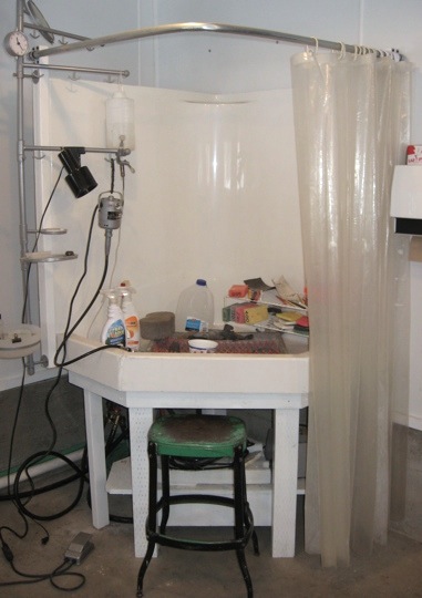

This is a water containment cabinet I built for my wife. She's a sculptor who works in glass and bronze. And since these can generate a lot of unhealthy dust, she works with water-cooled tools that dampen the dust, making a slurry and keeping the dust out of the air. Some of the processes utilize smallish power tools, and this containment contraption - fundamental to which is a sort of basin - acts as a sink for the slurry and then routes the liquid into a drain system we built in her studio.

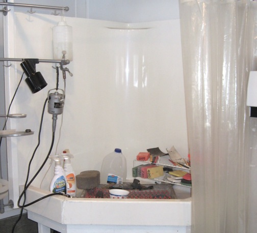

I built the basin and back-splash by cutting down a prefabbed fiberglass shower surround. Got it for half price from a plumbing-supply dealer. It had been damaged during shipping, though the damage was superficial and wasn't going to be a problem for our purpose. I cut it down by a bit more than one third it's original height.
This is a closer view of the portion of the shower surround that I retained as a sink/backsplash...
I put the portion of the shower surround that normally gets sealed down to a bathroom floor up onto a five-legged wooden framework made of 2x4's and 2x6's, using lag screws as fasteners. I determined the height of the framework when we decided what height the basin should be. That height has to allow for sitting and working, comfortably, for hours at a time. We used an old shower curtain to enable enclosure, if desired, while working at the cabinet.
