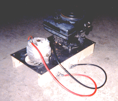

This guy made a generator from a small single-cylinder engine and an alternator, that tested-out as delivering 39 amps of power. The essential components were all re-used (lawnmower engine, GM car alternator, auto battery, pulleys, cables, etc). He tells how he built it and tested it, and he gives wiring diagrams. He says it can power home entertainment, lighting, and cooking.

DH says the tricky part would be getting a useable alternator? I've already put this on his honeydew list.
22,202
28,773
That's pretty cool! Some people just have a knack for looking at one thing and seeing how to turn it into something totally different.
