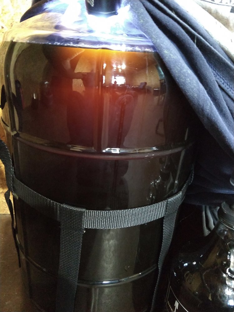

Both beers have been in secondary fermentation 8 days now. Hopefully you can see the clear beer, it's only cleared about 3/4" from the top. It still has a long ways to go but usually starts clearing faster after a couple of weeks.
Very high level explaination of what's happening. The yeast is cleaning up after it'self, eating every last little bit of nasty tasting stuff it can. As it runs out of stuff to eat, it drops out of suspension from the top down. This is a Ale (top fermenting) yeast strain. Lager is a Bottom fermenting yeast strain but a this stage both lager and ale yeast behalves the same.
I don't filter my home brews, so it's a matter of patience. I would say time wise it's a little more than 1/2 way finished. Every homebrew behaves a little different, to keep the hobby interesting.

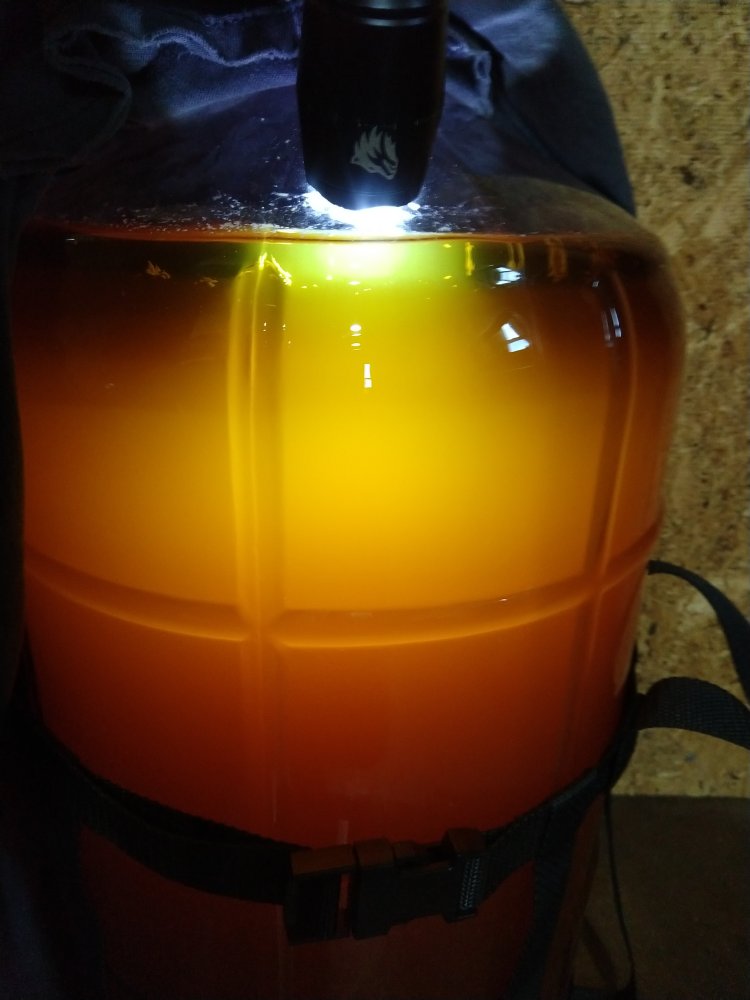

Blond Ale, easier to see the clear beer on the top.
Irish Red Ale not a very good picture to see clearing.
Some home brewers "Cold Crash" at this point. Which is just like it sounds. They stick the carboy in cooler at about 34 degrees fahrenheit. After a few days the yeast drops to the bottom but in my opinion, leaves behind off flavors. I don't like cold crashed beer, I can tell with just one sip if the beer had been cold crashed or not. I would rather let the yeast clean up and have a nice natural and enjoyable flavored beer. Like I said to me it's patience... and It's worth the wait :)
This is kind of a neat picture of the blond all with no artificial lighting to see the different stages of yeast falling out off suspension. It's maybe a little less than 1/4 of the way cleared. Patience...

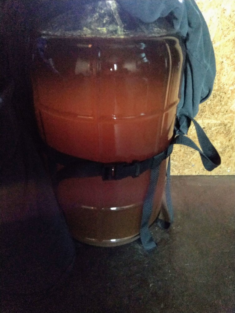

The Irish red ale is about 3/4 of the way done clearing. I'll probably wait until the blond ale is done and rack both at the same time. That way I'll only have to clean and sanitize my brew gear once. Notice the brown haze near the bottom.

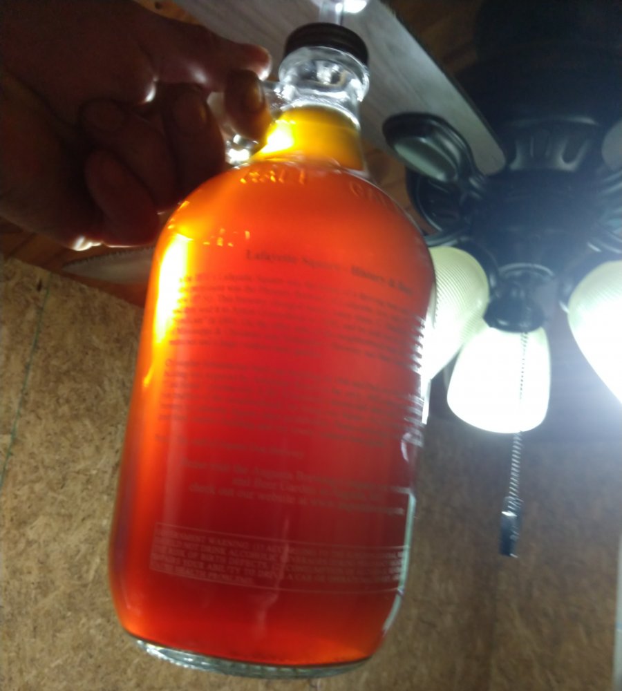

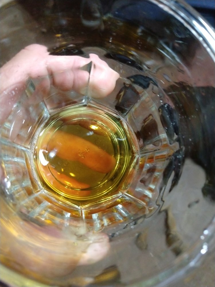

First blond ale sample. Yep, most definitely my Blond Ale recipe. Tastes a lot like tangerines on the front end, with a grapefruity taste on the backend. It's the 4 additions of hops during the boil, that gives it the unique flavor. It's a pretty low ABV and an easy drinker. It should do nicely for the wedding (if I don't screw it up somehow).

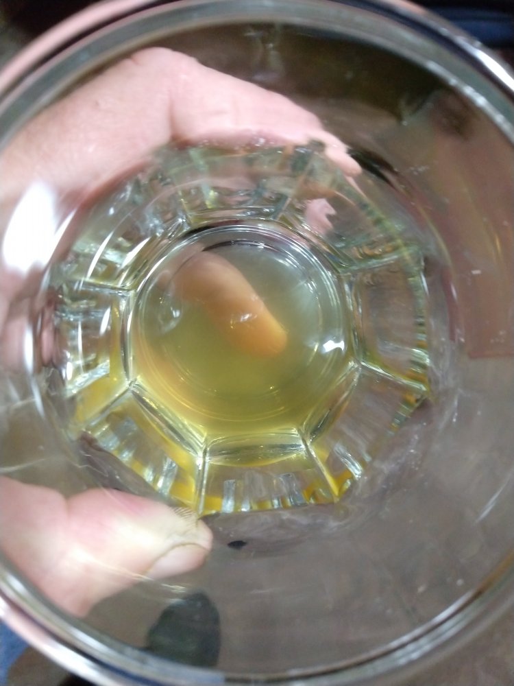

And first sample of Irish Red Ale. After a lot of study, I created the initial version of the recipe. Then tried tweaking it 6 times. Each version grew a little worse. 😂 Like most things in life simpler, is better. So the original version is the best. For the original version, just eliminate the flavor hop addition from version 3 I have posted.
I really like how smooth it is, start to finish and the slight hint of sweet roasted barley and East Kent Golding hops arroma, that reminds you it's Irish. This will also do well for the wedding (again, if I don't screw it up somehow.)

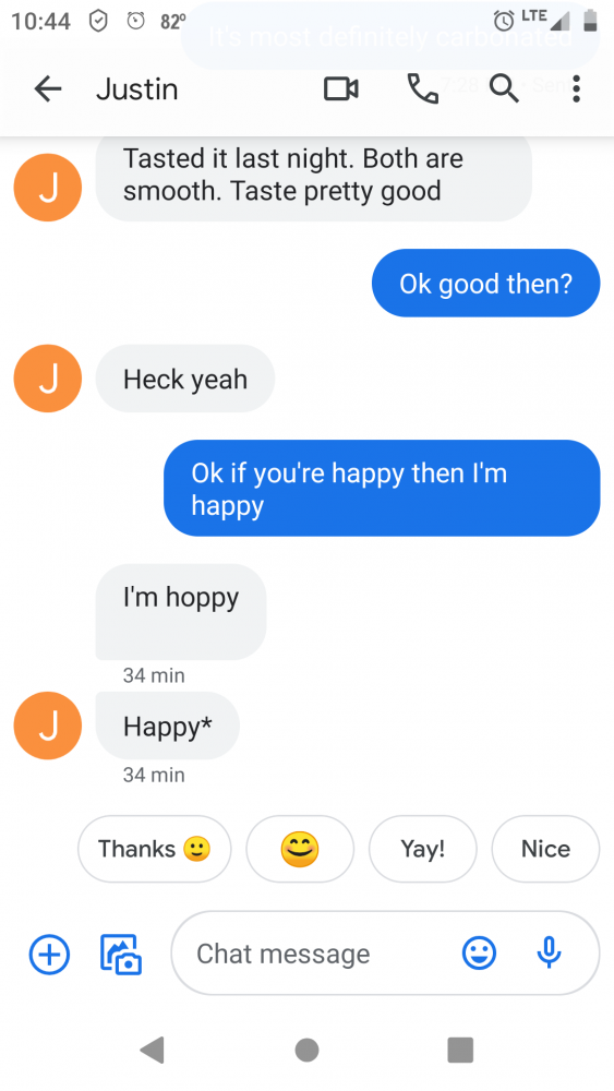

Success 👍 both brews took longer to drop clear than I expected but was worth the extra wait.
I think it's difference in the water from our old place to our new place. We are on a totally different water supply now. Next batch will prove or disprove my suspicion. Probably a bit of excess calcium in the water, if I had to guess. But this water produces a smoother brew, so I'm not at all complaining. People forget or overlook... The number 1 ingredient by volume in beer, is water.
