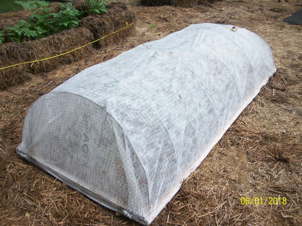

My experiences with the low tunnels have been mostly good, though I've had trouble with the Agribon material....the cats shred it in two seconds and for some reason just fall in love with it. They want to play on it, sleep on it, and otherwise lay it to ruins. I tried deer and bird netting OVER the Agribon so they couldn't get to it with their claws but to no avail.
This year I'm collecting flat white sheets from Good Will to use over the tunnels instead...cheaper, hardier, about the same type of sunlight and fluid is let in and I can reuse them for a couple of seasons.
They are great for growing greens of any and all kinds as it keeps most insects off them...still have a problem with slugs, though. You have to check under there frequently, as one day you can have lettuce that's almost ready for picking and the next it has bolted. Harder to monitor such things when they are covered and you can't check them at a glance as you walk by.

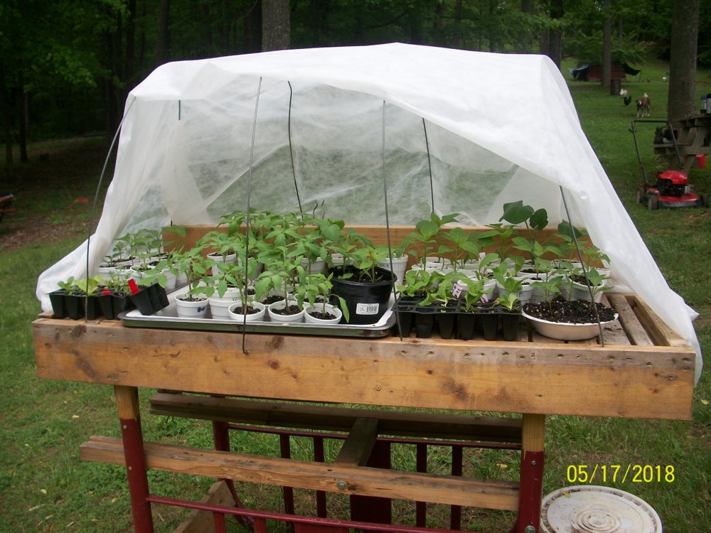

It's a great place to harden off seedlings. I use a tiny low tunnel erected over my butcher station as a place to grow seedlings, then when they get too big for that space, I put the trays out in the grow tunnels where they can still get sun and rain but have more room to get taller. Since I don't use grow lights, this method allowed me to get sturdier, less leggy seedlings this past year.
Mini tunnel on my butchering table/outside sink...the only drawback is that it was just too small. May do this on a bigger scale in the spring so when I repot the plants I have more room for them. TEN times better than trying to do the same thing inside on a window ledge.
This is just 1/2 x 3 in wood frames with heavy gauge wire cut into half hoops, inserted in between framing.

I have been using Agribon fabric to cover my tunnels....you can get that about anywhere that sells seeds and even on Amazon. I got mine from Fedco these past few years.
