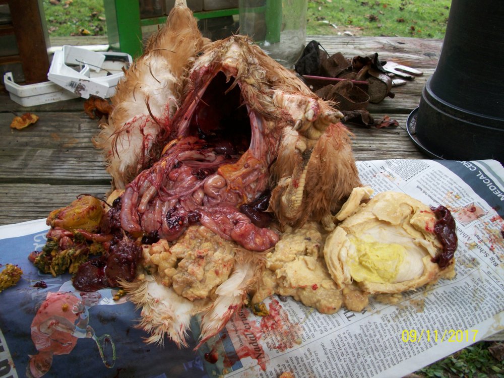

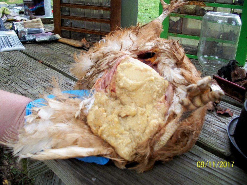

Today I got a group of production reds on the cheap, to use for meat purposes, but among the group was a hen that needed killed immediately(the farmer was the one who transported her to my cages or I would never have taken her at all...didn't get to see this one until we got her home) and two more who will need killed within the week if I want to prevent further suffering for them. All three have massive ascites~huge abdomens~indicating either fluid around egg tumors or massive egg tumors.
Another two have vaginal prolapse that may not cause them problems if they cease to lay due to the move...neither of them are currently laying very often, judging by the vent, but if I were to hold onto them they would eventually lay more, causing them pain and suffering due to the prolapse.

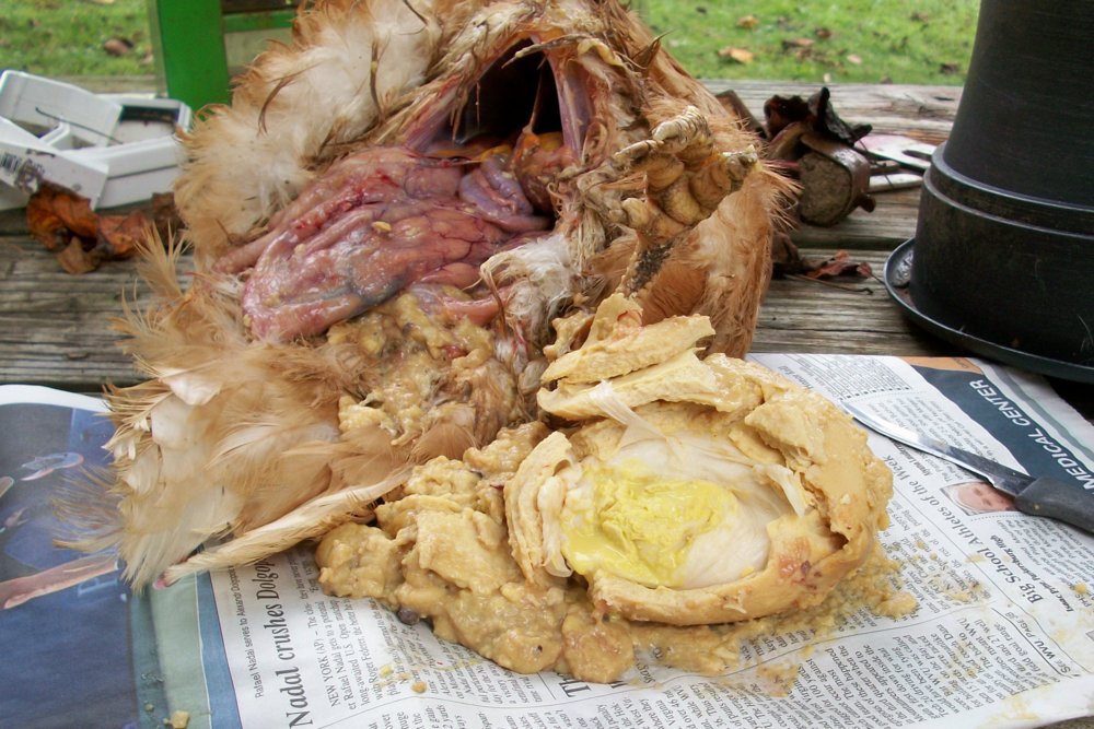

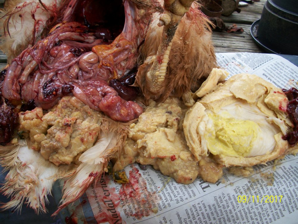

I did a necropsy on the hen I killed today~she had a purple comb, massive ascites and was listless...in other words, she was dying anyway, just taking her good ol' time to do it. The farmer I bought her from was totally clueless about chickens...nice man, but clueless, so he thought she was broody...nope, she was sitting on the nests as a refuge, as the other hens would have pecked her mercilessly if she had huddled out in the coop.
She had the most massive egg tumor I'd ever seen in a hen and how she lived this long to form all that material is just a huge question. It just kept rolling out of her, the most putrid smelling mush that was pocketed all over her abdomen but most of it came from the largest sac of tissue and in the middle of that mush was the egg tumor itself. This bird had egg peritonitis in the worst way.

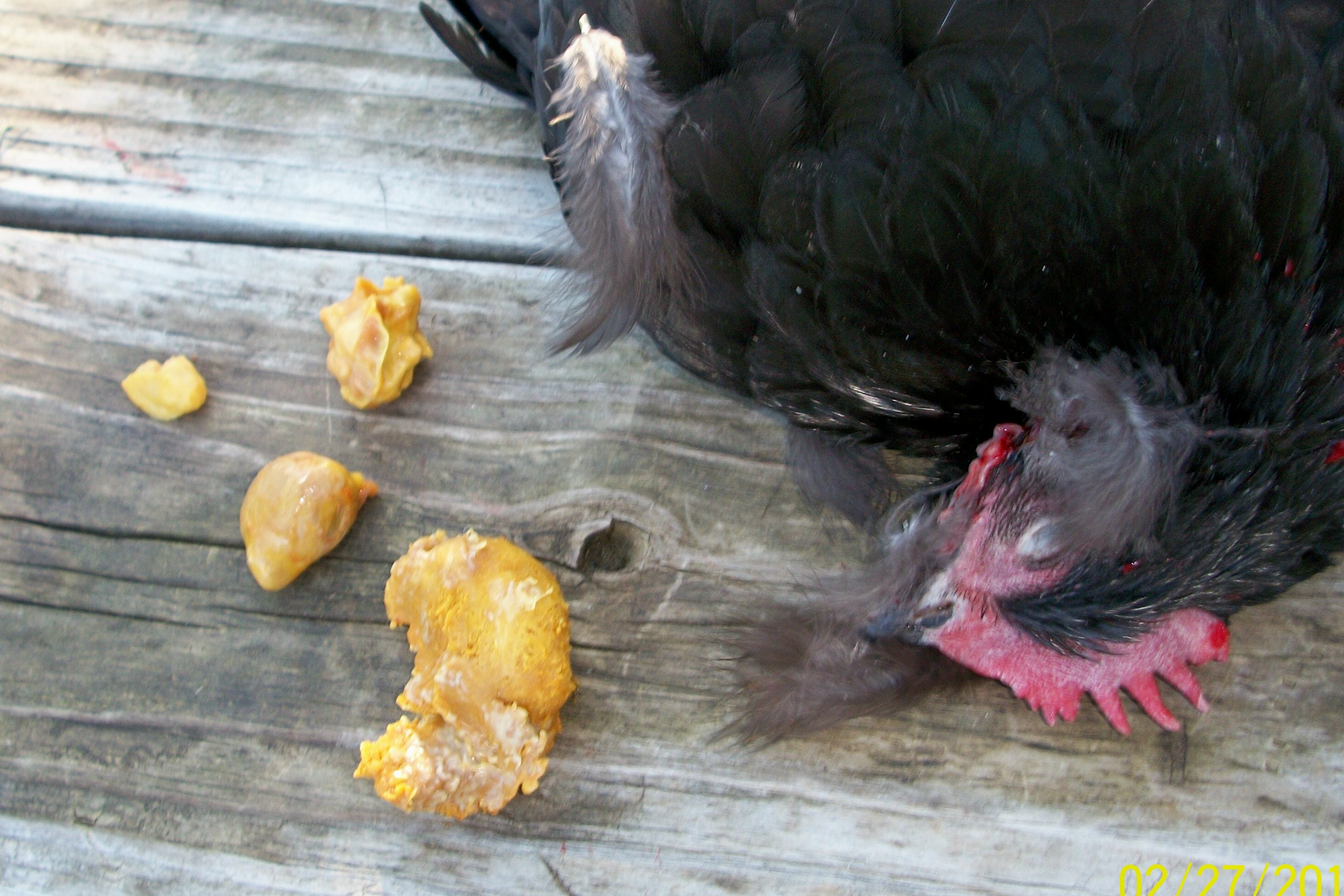

I've kept hens to the ripe old age of 7+....but regretted it when they finally showed up with lash eggs. A good, sweet hen shouldn't have to be uncomfortable or in pain at all if we can prevent it by culling them when they no longer have laying cycles~BEFORE they suffer a single minute.
Here's what was in my sweet little BA, a loyal and wonderful layer for 7 yrs...wished I had culled her before she was hurting from trying to expel these lash eggs. But, I really liked her and wanted to keep her around...you know the feeling. Now I don't give into the sentiment any longer, if I can spare a good hen a single day's suffering, I will.
