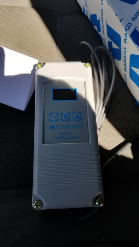

well I lied and broke my own rules. Just bought a $60 digital read out thermostat with remote bulb. It has a 1 degree differential. Should work nicely.

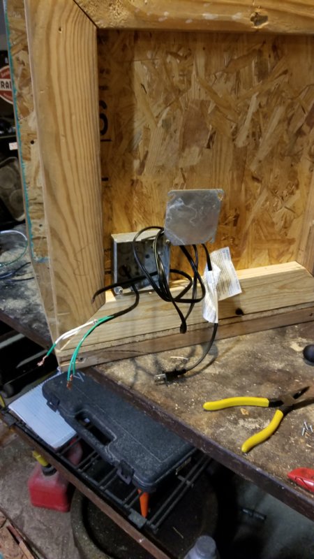

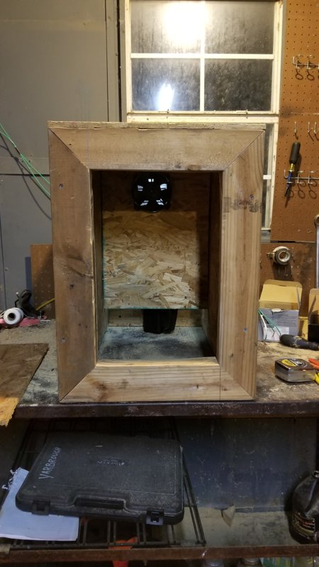

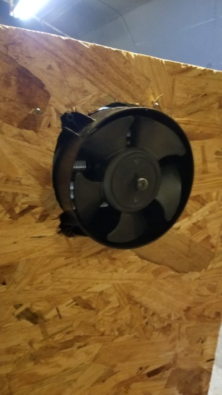

Photo bomb. Been working on it tonight.
It works! Not done yet

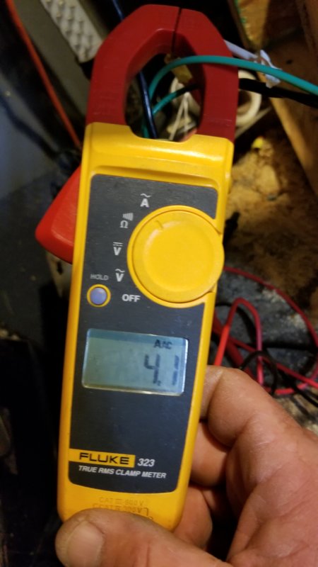

The heat strip alone is pulling 4.1 amps. At 116 volts (what I have) that's just under 500 watts. It wasn't as simple as I thought. It's not 3 seperate strips. They are all bonded together in series. So where you place the wires and how many directly effect the resistance. It's a series parallel circuit. Rather than do all the calculations I just tried some trial and error with the amp clamp and wire positions. Worked well. Got it on the second try
still need to build and install 2 shelves, put the bottom on , build a door with window and I install the thermostat
