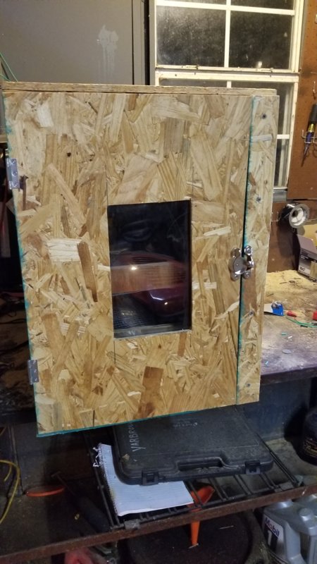

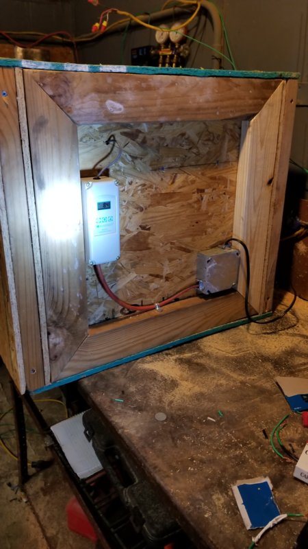

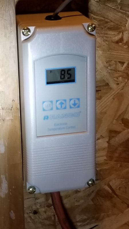

Well it's up and going. The thermostat is awesome. The heat element is a little big at 500 watts. It took 6 minutes for it to heat up to 100 from 79. It satisfied and over shot to 101. I watched it cycle a bit and it seems to be spending 2/3s of its time between 100 and 101. 1/3 of the time is heating back up 100 from 99. So it's holding a range from 99-101. I'm sure it will steady out more after it's ran for a day or so. Once everything is warm that should help alot.
All in all I'm pretty happy. Still gotta get a hydrometer tho....and put in a water pan.
well after it ran for a while the overshoot got worse. After it satisfies at 100 it continues to rise to 102. That's not gonna work for me. So I rewired the heating element for 300 watts instead of 500. It takes a little longer to warm up but so far it looks better than before. We'll see
