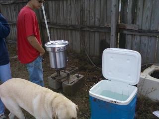

I am totally and completely sore and exhausted!! WOW. I got off work at 6am, friend (K) was here just after 7. We decided our scald pot wasn't big enough so we went a couple of minutes up the road and she bought a turkey fryer that came with a stand / burner. The stand and burner were "Some assembly required". At 938 I called my dad to come help us. After all of that time and effort, we find out the connector hose won't work on my dad's propane tank. 2 hrs wasted.
We put her pot on my dad's fish cooker and after a little bit we were ready to go!
The first volunteer was live weight of about 7lbs. I literally walked around the corner of the privacy fence and plugged my ears while the hatchet fell. I think the 1st bird we had in too long and the water was too hot. After the scald and cold dunk (no idea where I read that, but I know I did.... ) , friends 7yr old daughter and I started plucking. The big feathers were super easy to pull, but those pin feathers were ridiculous! It took forever.

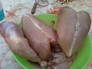

Anyway.... the finished product:
before washing
D7 and K - 2 breasts in one bag and 4 leg/thigh combos in the other
