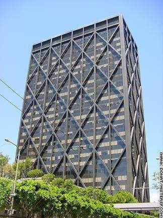

Nah... You can do it, no problem. You probably seen X bracing on lots of buildings & bridges before but never really paid much mind to them...
It's like this but your just going to do 1 X corner to corner on inside of the knee walls.
X bracing makes walls strong like bull ox

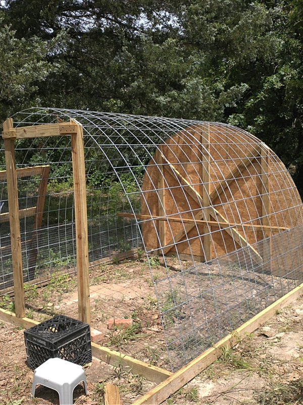

This is an X brace I built on the back side of a hoop coop in 2015. I didn't notch the 2x4's, I cut them in half and patched it together. The hoop coop is still in use, hasn't fallen down yet. LOL

That's some mighty fancy cutting on that back wall radius. We just gotta get you notching instead of scabbing. Once you learn how - it's just as fast and a lot stronger than scabbing will ever be. With notching your using the stength of the wood to your advantage, instead of relying on the strength of chineese fasteners which (bend like twig in wind storm).
Let me look around and see.if I can find some how-to's on notching for you. If you can run a skill saw read a tape measure and pound a nail with a hammer you most definitely have the skill to notch it just overcoming that voice inside your head that says "you can't do that".
Remember it's only wood... so what if you mess up on a cut... Grab another board, correct the mistake from the first board and try again. You do realize boards DO grow on trees - right? ;)
