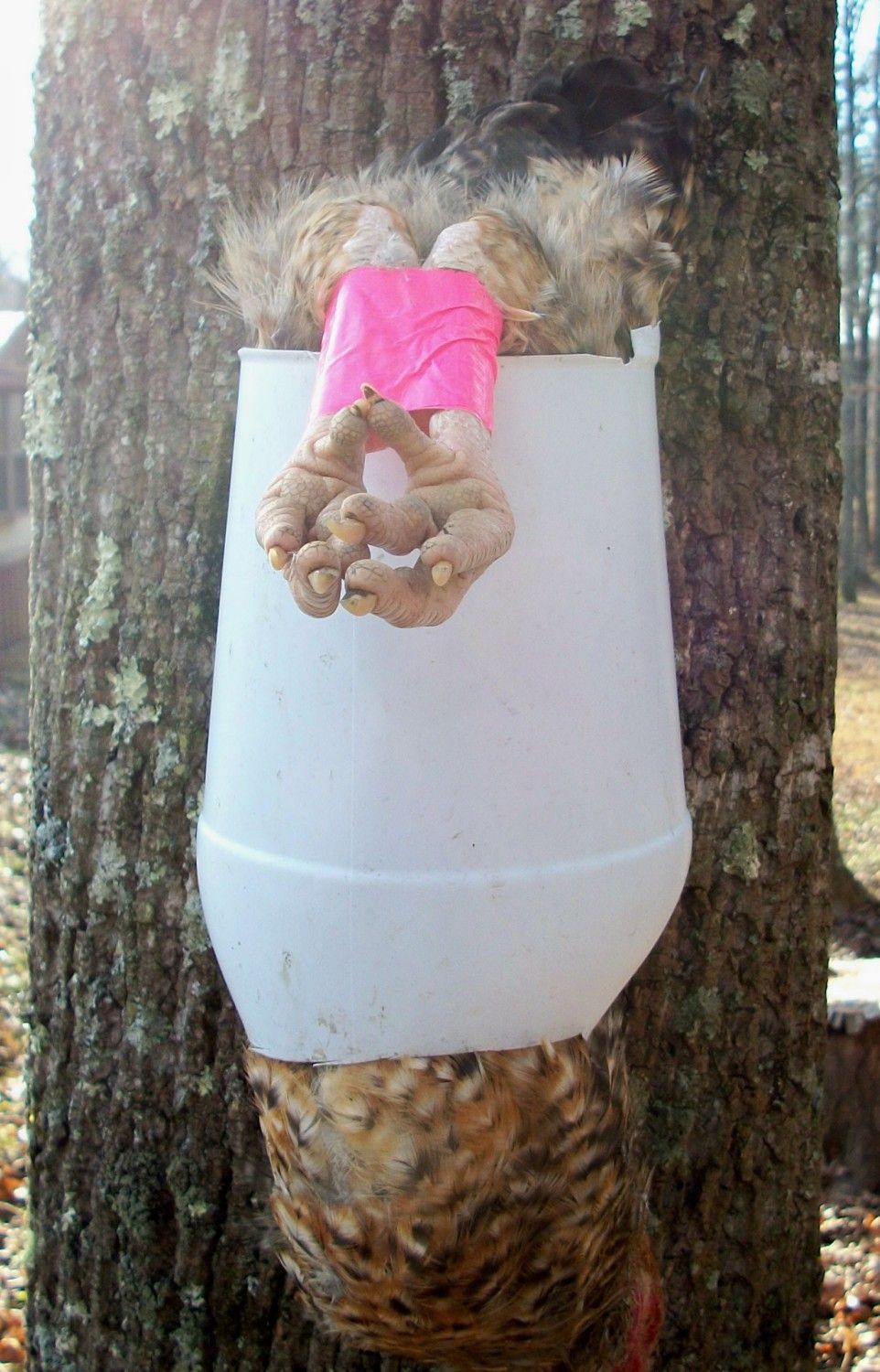

I'm currently using killing cones made from 2 gal. bleach jugs, which hug the bird just right and serve for extra large to even tiny hens, last for years and can be nailed up anywhere.

we use a rolled up cardboard-held-together-with-duct-tape fancified redneck killing cone. We put the chicken in the cone and I cut the throat. DH holds the legs to keep it from kicking out. We kill one, leave it to bleed out while we skin and gut the one before. We just butchered 5 EE roosters, gave 2 to son in law at his request.

Bay, if you use a bleach bottle your hubby won't have to hold those legs for ya. I keep two tacked up so I can load them both and have a bird bleeding out in one while I'm butchering the other and just keep doing a round Robbin on them. Put up a bird, slit the throat, remove bled out bird and process, rinse and repeat.
