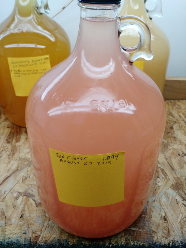

Red clover wine is taking on a nice peachy pink color. It will probably need its first racking in a week of so.

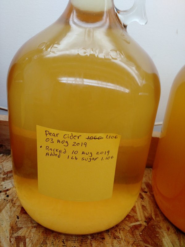

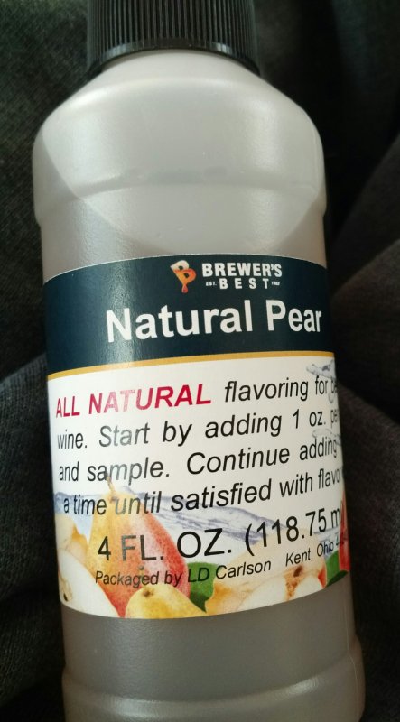

My extra hard/high gravity pear cider wine is starting to clear out. It looks like it will need to be racked, stabilized and back sweetened in the next few days or maybe I'll add more sugar a boost the gravity even more. The cider yeast I used is good to 18% ABV, 36 proof is high for a wine though. Pears are my favorite fruit, so I fermented this one for me and I don't plan on sharing any :)

Well you can pretty much be assured, it's going to taste like pear and alcohol. I picked a bottle of pear natural flavoring extract to ensure it will taste like pears :)

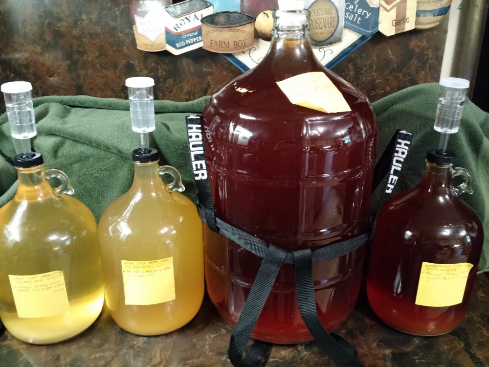

Cranberry is so difficult... Somehow I ended up with 6 gallons. I don't understand because I added 4 gallons of spring water. But when I pulled the fermentation bag, added more sugar, and mixed in. I ended up with 6 gallons.
It's also odd that it keeps dropping in volume so much. The necks of my 3 gallon carboys are only so long and I'm having to top off with aldi's unsweetened 100% cranberry juice. It's still fermenting violently even after a week into secondary fermentation. This may be the first wine I've made that might need to be racked off the lees for a third fermentation. I don't know yet, i hope not.
My buddy at the home brew store told me cranberry is a great wine but it's difficult and will test your skills. I'm finding out he's right about the difficult part anyways. I wouldn't recommend trying a cranberry wine to anyone who is just starting out.

I also noticed both my pear and apple cider wines have also completed fermenting, I checked the gravity and both are at 1.000. These gallons are leftovers from the 6 gallon cider kits, I made up for my daughter's wedding reception (a corney keg only holds 5 gallons). I'll also rack, stabilize and fine (benonite) them at the same time, as long as I got everything out for the watermelon wine. The pear on the left is noticeably clearer than the apple next to it. I tasted both the pear and apple, they are both harsh but underneath the harshness is a nice pear and apple flavor. So I think both are going to make some delicious cider wines.

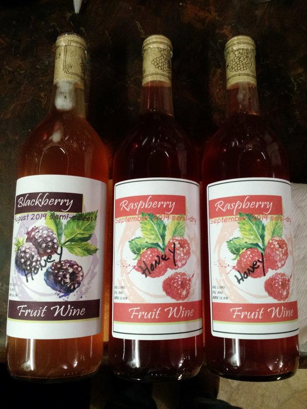

I had some extra from lees on the bottom of the carboys, so I made my wife a few bottles back sweetened with local honey to her taste buds.
I carefully syphoned off the clear wine from on top of the lees after cold crashing into canning jars and shook the tar out of them to dissolve the added honey. Poured her a taste test and added more honey until she liked the taste.
I told her I won't be clear, like store bought wine due to the honey addition, but she said that was OK with her. She likes sweetening with honey better than sugar, even her coffee.
Now both batches of blackberry and raspberry are done and she's all set for the Oktoberfest party :)
Happy Wife / Happy Life.
