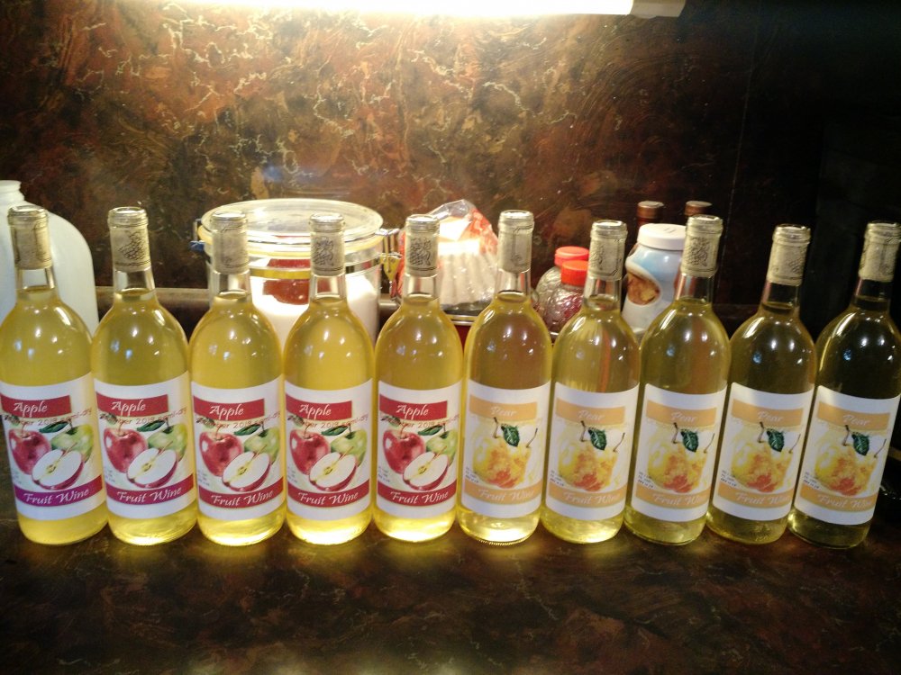

Apple and pear cider wines are done and bottled. 1 gallon gives you 5 750ml wine bottles. Apple tastes like very hard apple cider, 13.6% alcohol by volume but without the fizz. Pear has a interesting aroma of mild vanilla and pears, it also tastes like very hard pear cider at 14.3% alcohol by volume without the fizz.
Not really sure what to call these. They were both ciders and fermented with cider yeast but I finished them off like a wine so I guess they are cider wines.

Yeah... For personal consumption (Wife and I). No need to shrink wrap toppers because I will not be giving away as gifts.
After tasting a bottle of what my neighbor gave me that his friend made, with floaters in the wine. Maybe my wines aren't so bad after all... But mine are not what I would consider fine wine. I need a lot more practice/experimentation first.

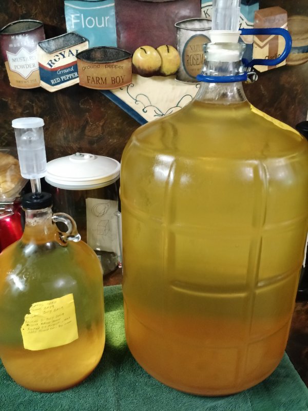

I just pulled 6 gallons of sassafras out of cold crash to bottle this weekend. Look at all the lees sediment on the bottom and how clear the wine is. so far I like the flavor of this root wine. Very mild bourbon on the front end, apricot on the back end and it warms your ears going down :)

After wiping the condensation away from the jug. I still can't get over how clear this sassafras wine is. I read on some of the wine making sites that people would have to let sassafras sit for over 6 moths to clear after they stabilized it. Nope just a week cold crash at 34 degrees works just fine. It was a mess before cold crashing.
