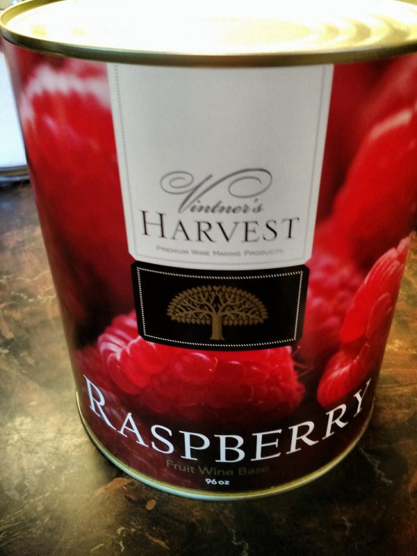

Red Raspberry 1090
13 July 2019 - I couldn't pass up a deal on 96oz of Red Raspberry wine base for $15.00. So I guess Red Raspberry wine is next.

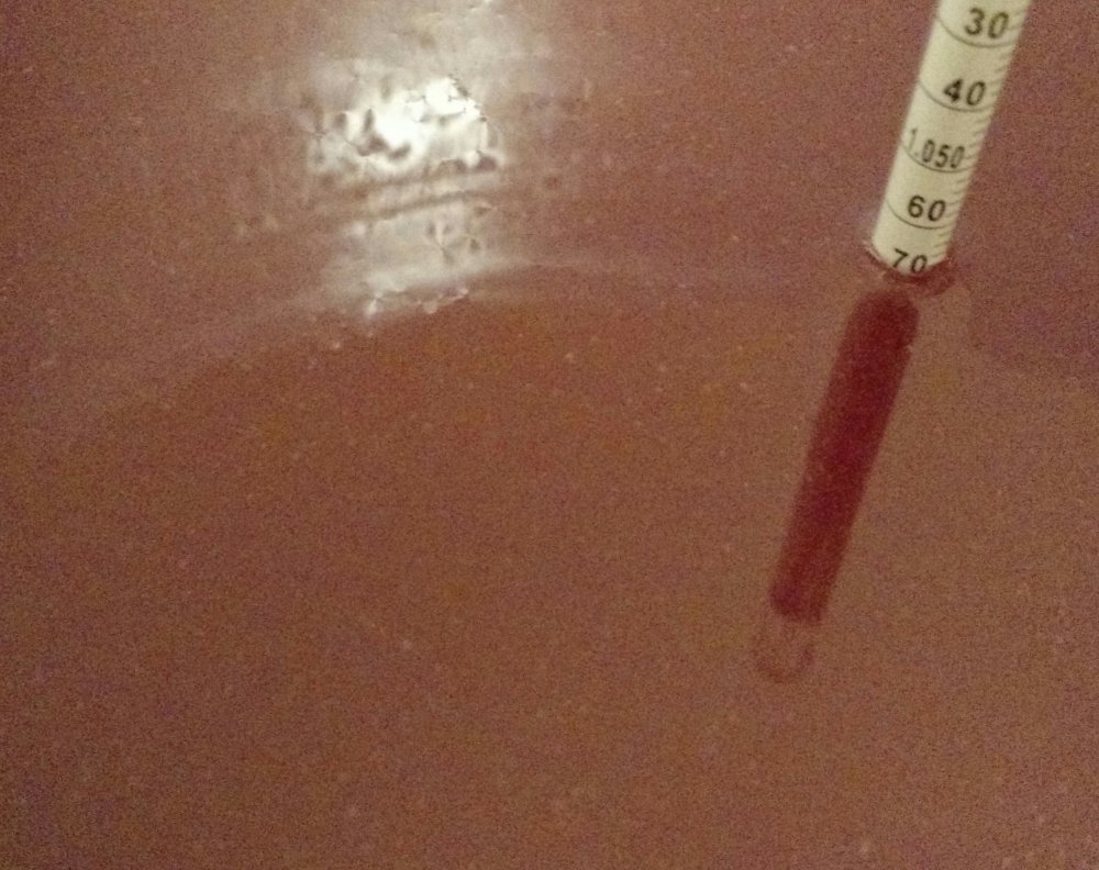

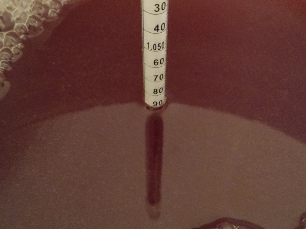

14 July - pulled the gravity @ 1.082. This is a little low, I like to start at 1090 or a little above. I'll need to add more sugar and recalculate the starting gravity, once I pull the pulp bag and can get a good estimate of the volume. It should be right around 4 1/2 gallons but hard to calculate just the liquid volume with berries included.

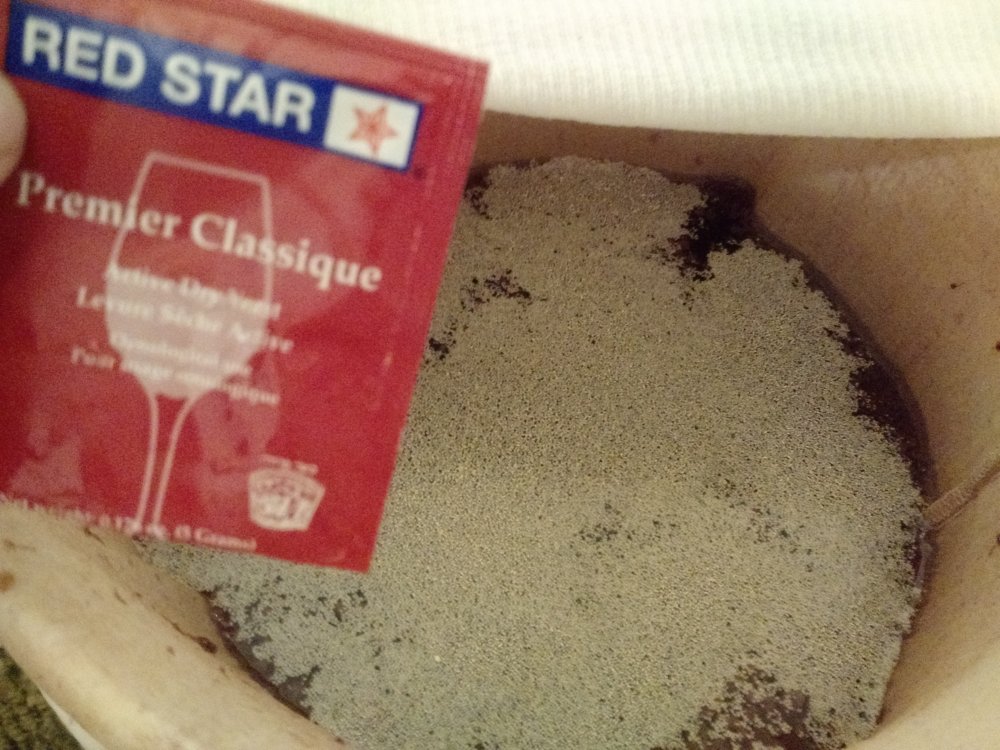

I went ahead and pitched the red star montrachet yeast starter, plus another packet of red star montrachet dry yeast. Yeast packs are only $1.00, so why not 2 packs instead of 1. I'm trying 2 as an experiment to see, if a active starter, plus a dry pack helps with the lag time, I experienced with some of my other wines.
16 July - Added 1lb sugar to raise the initial gravity to 1.090 now that fermentation has started. Gravity before 1lb sugar addition 1082, after sugar addition 1090.

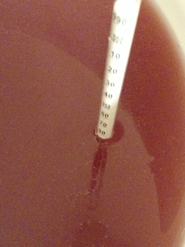

16 July - gravity 1084 approx .7% alcohol by volume produced so far. Nightly gravity reading at stir.
Notes: ferment is active, it looks like pitching a yeast starter, plus a dry pack at the same time worked very well for reducing lag time (time to start ferment). Smells divine, I enjoy the smell of fermenting blackberries and now raspberries with red star montrachet yeast.

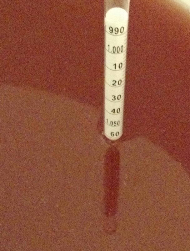

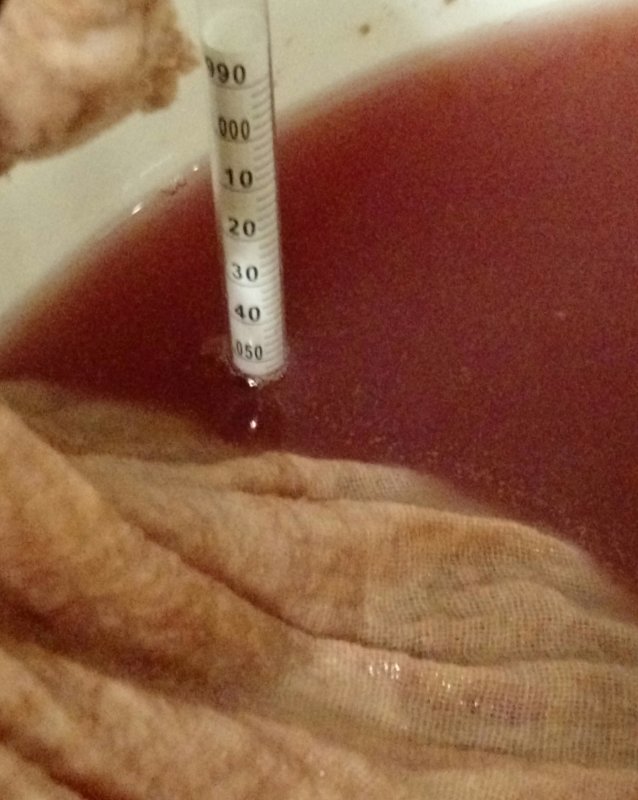

16 July - gravity 1074 approx 2.1% alcohol by volume produced so far. Nightly gravity reading at stir.
Notes: lifted the fermentation bag and squeezed the juices and wringed out to mash
the berries, returned bag back into fermenter. Nice active ferment with 1.4% alcohol by volume produced in approximately 24 hours.

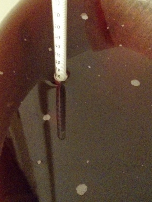

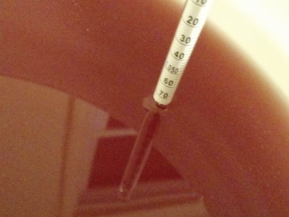

18 July - gravity 1068 approx 2.9% alcohol by volume produced so far. Nightly gravity reading at stir.
Notes: .8% alcohol produced in 24 hours
19 July - gravity 1061 approx 3.8% alcohol by volume produced so far. Nightly gravity reading at stir.
Notes: .9% alcohol produced in 24 hours. Added 1 1/4 tsp of yeast energizer.
20 July - gravity 1053 approx 4.8% alcohol by volume produced so far. Nightly gravity reading at stir.
Notes: 1% alcohol produced in 24 hours.

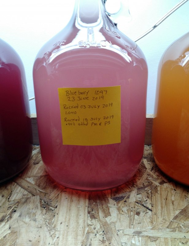

Blueberry Montrachet 1097 Part 3

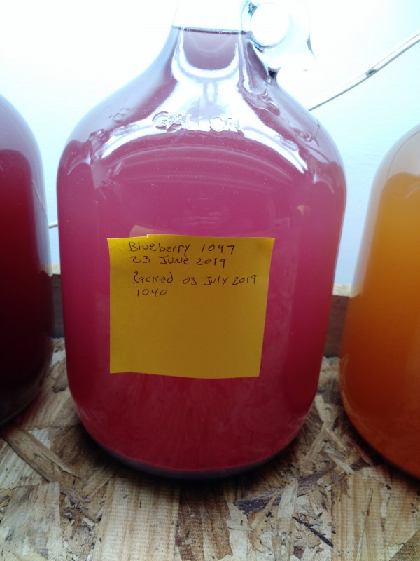

16 July - looks like secondary fermentation is close to completing. There is a thick layer of lees in the bottom of both 5 gallon carboy and 1 gallon glass jug. Wine should not sit on lees to long after fermentation has completed for risk of producing off flavors in the wine.
I'll have to go pickup up some glass marbles to place in the bottom of 5 gallon carboy since I have no extra blueberry wine to top off the carboy, when I rack it again.
It's starting to turn a nice shade of pink. It will be interesting to see what color it finishes.

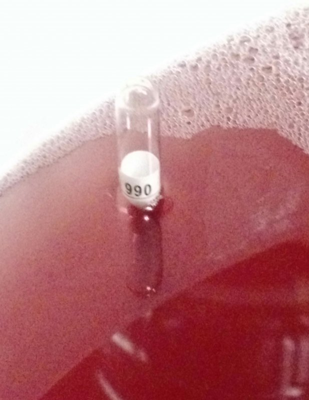

18 July - Due to the thick layer of lees on the bottom I went ahead and racked both 1 and 5 gallons through a length of copper pipe. Gravity was .992 or 13.8% alcohol by volume, so I'm calling this batch fully fermented. I also added the recommend doses of Potassium Metabisulfite and Potassium Sorbate to stop fermentation, preserve the wine and aid in clearing.
Let sit until clear
