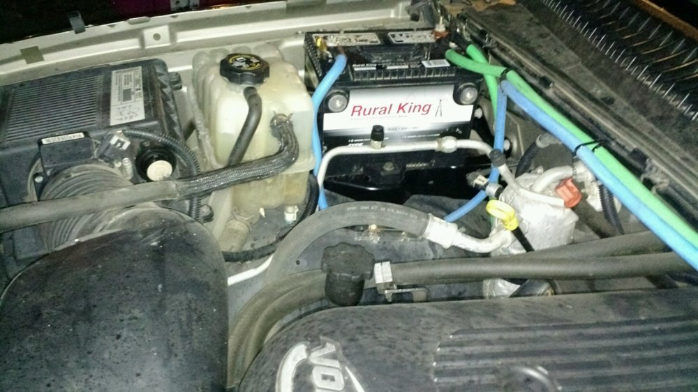

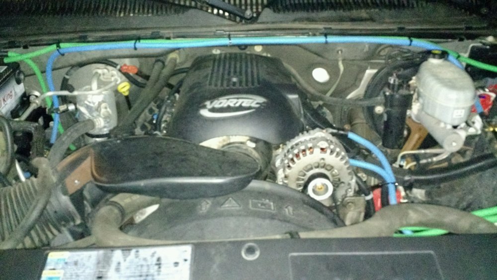

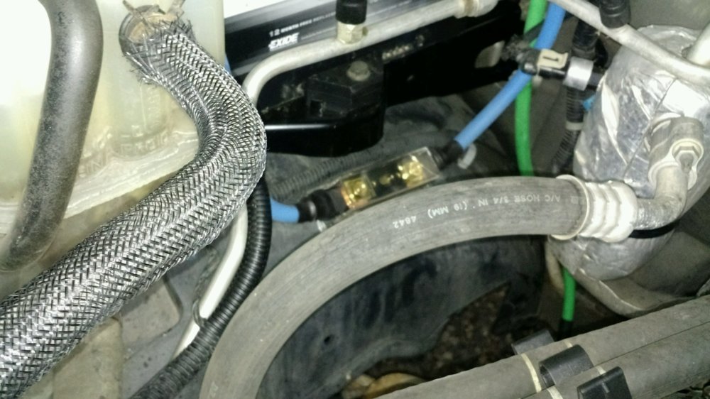

Veggie hauler gets dual batteries and 350 amp 1/0 guage welding wire upgrade. No more disco lights flashing to the beat of bass :)

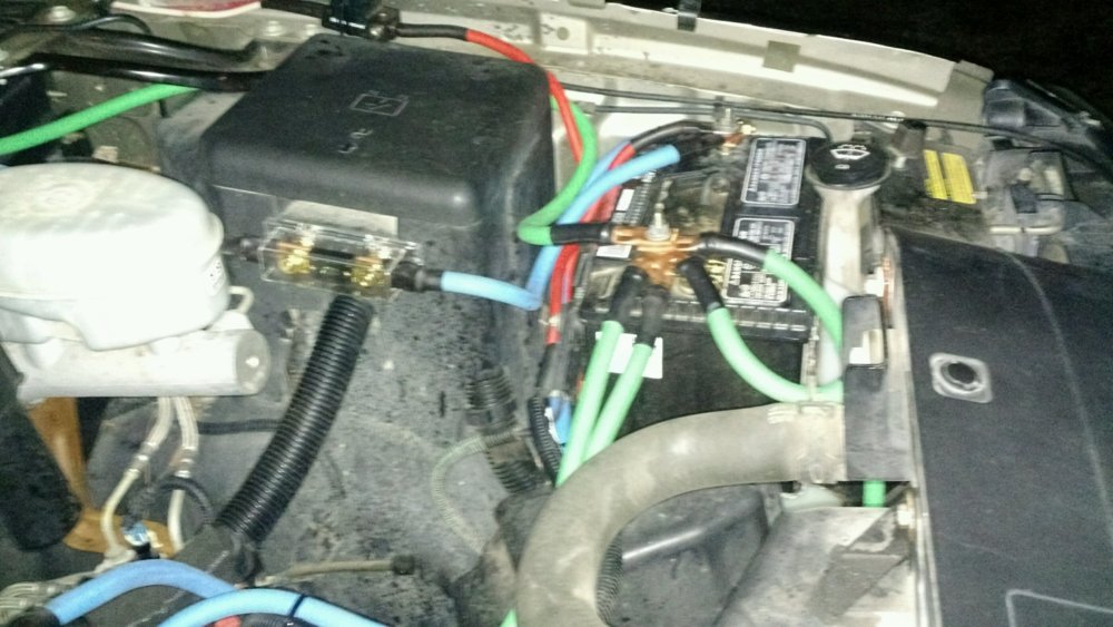

Batteries wired together and dual power and ground leads to and from the 250amp alternator. (Blue = + Green = -)
Primary starting battery dual engine block grounds, frame, chassis ground and ground to secondary battery. Plus 300 amp fused + secondary battery.
Secondary battery plus dual 300 amp fuses
I saved a ton of money doing it myself and making up my own terminals. Lots of fun - I like wiring so it wasn't any trouble at all. Upon completion I could sense the electrical was "breathing" easier. Every thing is snappy now and the engine cranks strong! Basicly I doubled my cold cranking amps and opened up the electrical system so electrical can flow a lot easier than before with stock wiring.

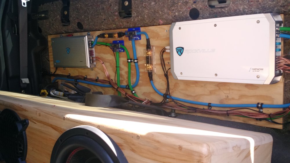

Rewired my behind rear seat amplifiers with 1/0ga and 2ga welding wire and tidied up all the speaker wires, RCAs and remote turn on wires, while I had the rear seat out of the veggie hauler.
I re-turned my amplifers, everything was just about perfect... Although my wife got pissed at me for rattling a few pictures off the wall in the house while I was working on tuning the amps in the driveway (note to self do this when the wife is gone next time).

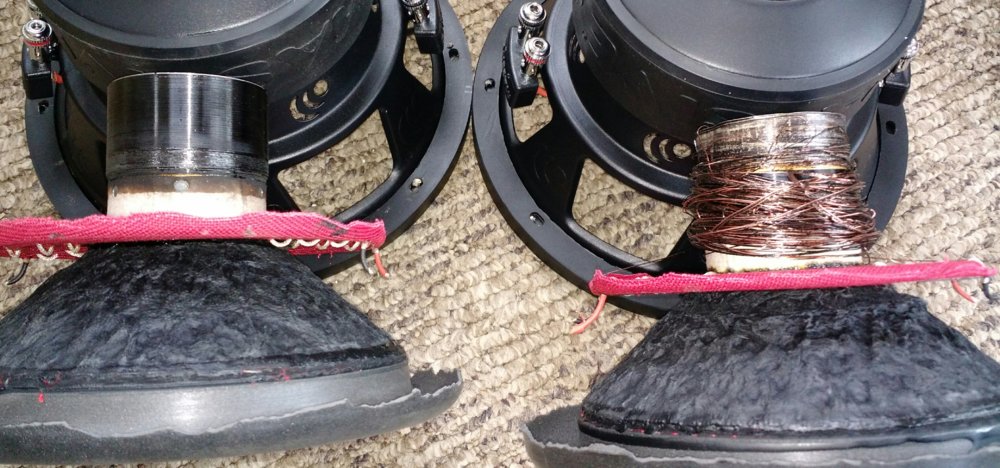

I had to run into town, then all of a sudden at normal listening volume it happened... Both sub woofers got loose, I smelt something burning. Then the sub-woofers voice coils unwound in the the baskets like a freaking slinky and my sub-woofer amplifier went into self protection mode. Needless to say I was really disappointed. I called the manufacturer and they are sending me brand new subwoofers so I guess that's ok... But still very disappointed none the less.
This is what the sub-woofer motors looked like after I took my pocket knife and cut the cone and spider loose from the basket so I could pull the voice coils to have a look. This is bad bad bad!!! I'm very surprised they didn't catch fire. But I bought amplifiers with really good protection circuity just in case... Well just in case happened!

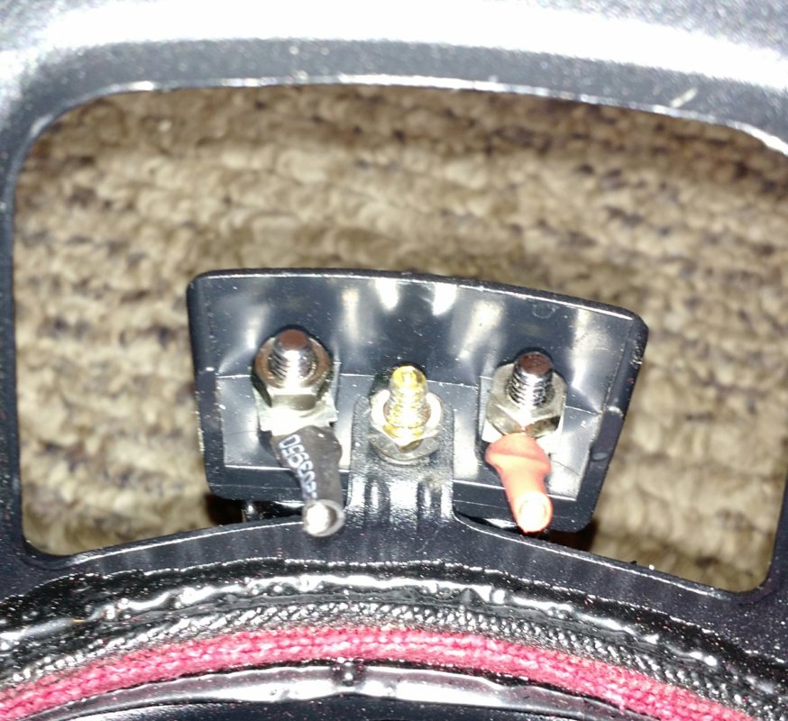

Just because I'm that kind of guy and I wanted to know if the sub-woofer self-destruction was something I did wrong or not - i got to looking over the subwoofers real close. What I found shocked me actually... The voice coils tincle leads are mechanicly attached to a terminal block (each subwoofer has two voice coils) via a wire lug, lock washer and bolt. We'll the bolts we're loose on 7 of the 8 connections. Everyone knows loose electrical connections cause all sorts of problems but perhaps the worst is heat. I mean lots of houses have burnt down due to loose wiring connections.
So I shot a video of me taking my finger and moving the lugs around and sent it to the manufacturer. With a suggestion to use loctite and instead of a lock washer to use a star washer. They were very appreciative and called me like 15 minutes after I sent the email. They said they are stopping production to test my suggestion of adding loctite and a star washer... it felt good to actually have a manufacturer customer service person listen to you and take you serious and also move me up the management chain into the engineering department all while your on the phone.
Anyways I done my good deed for the day and hopfully improved this product a little. But man what a disappointment it was to experience subwoofer self destruction and for no good reason other than it would have costs less than a nickle per sub-woofer to fix :(
When my new sub-woofers come in you can betcha I'm going to the hardware store after star washers and adding a dab loctite to each bolt and tightening the nut on the terminals real tight. While I'm at the hardware store I'll also be picking up a fire extinguisher for the veggie hauler (just in case).

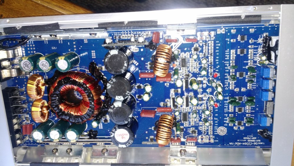

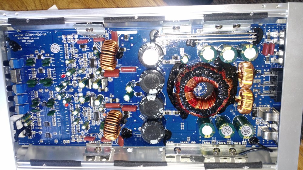

More amplifier guts from my new 2400 watt class D sub-woofer amplifier. I love looking at electroincs - it's just so interesting... And to think about the amplifier engineer who designed it. Very cool...
This one has dual class D power supplies and elevated voltage rails to efficiently move vast amounts of high AC current to the outputs speaker outpouts. It also massive heatsinks to dissipate heat efficiently from banks of power tranistors. It's a very thoughtful, cleaver and robust design, my hats off to the engineer who designed it - who ever he/she is - nice work.
