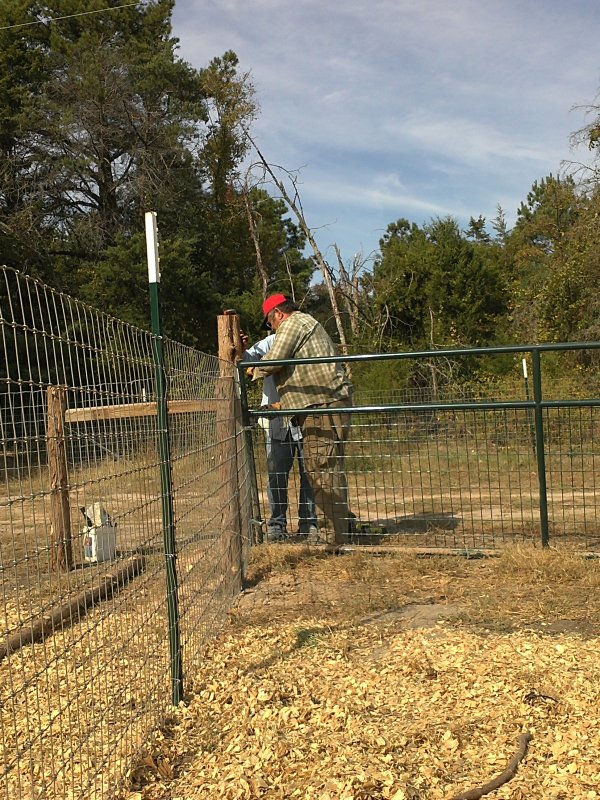

Hanging a gate. My husband made fun of me for all the gates I insisted on, but plan carefully for ease of movement for livestock. We used 12' gates and in a few places where swing room mattered, we used 16' gates.

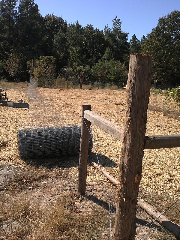

    Got it started, now to roll it on out.
    img2361-jpg.16120

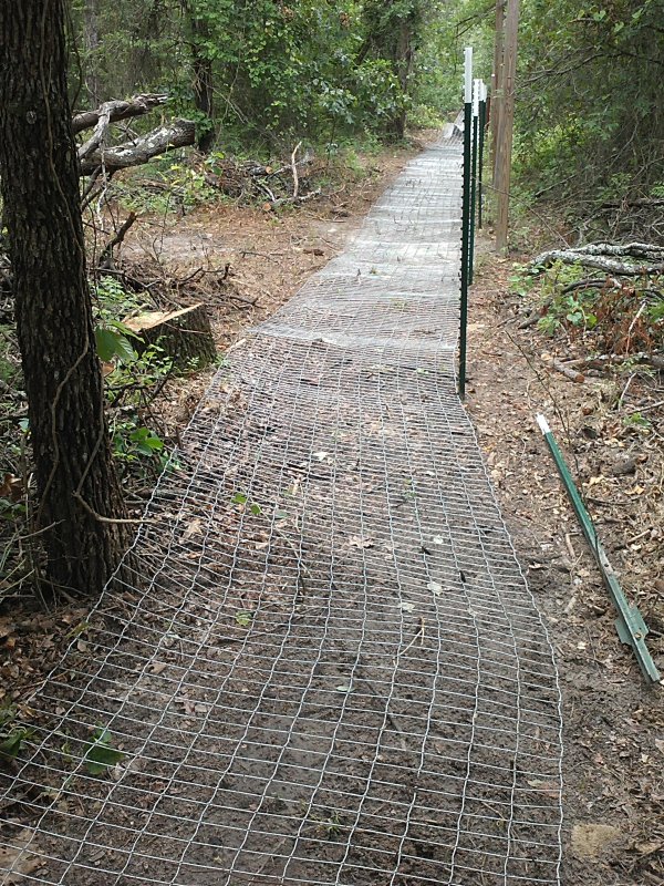

    Have to go around the stump.
    img2362-jpg.16121
    The tree just beyond the stump wouldn't move, so I had to pull out a T-post to get the wire rolled past it.
    img2363-jpg.16122

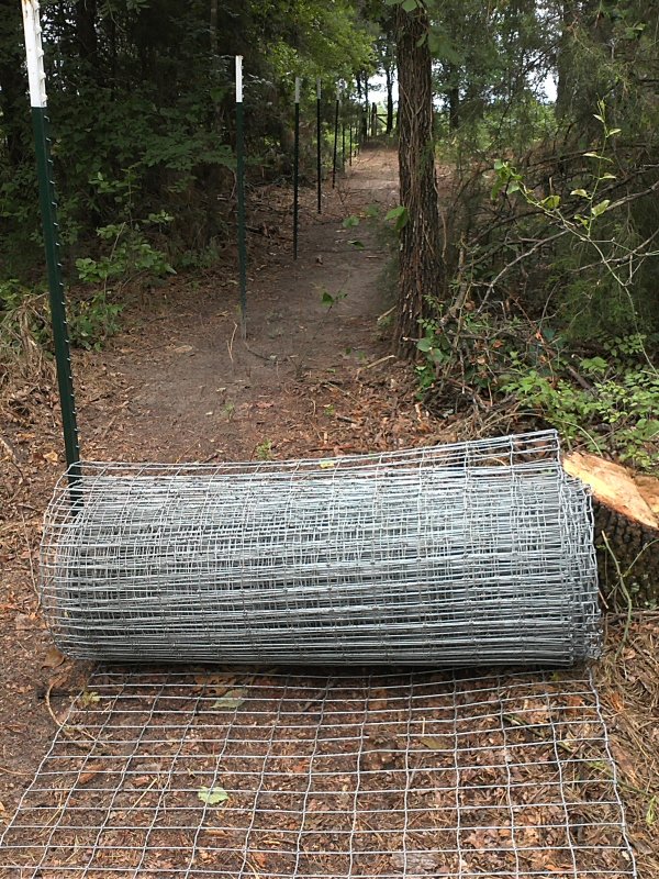

    Ran out of wire before I ran out of posts.
    img2368-jpg.16117
    So close yet so far away!
    img2367-jpg.16118
    Notice the long wires? Those long wires are at the start and end of every roll. I used them to weave another piece on. I cut a 30' piece which gave me enough to stretch with.

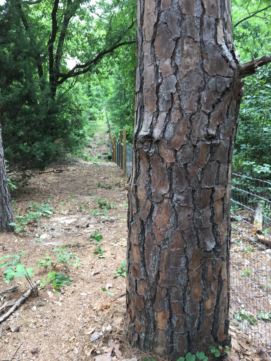

We ran the fence up the slope toward the back corner, there is a huge pine tree close to the line. I can't reach around it. My husband was insistent on keeping the tree, so we moved the fence over to make sure it has room for future growth. This was ok with the neighbors and they were pleased that we saved the tree.
img_1713-jpg.35702

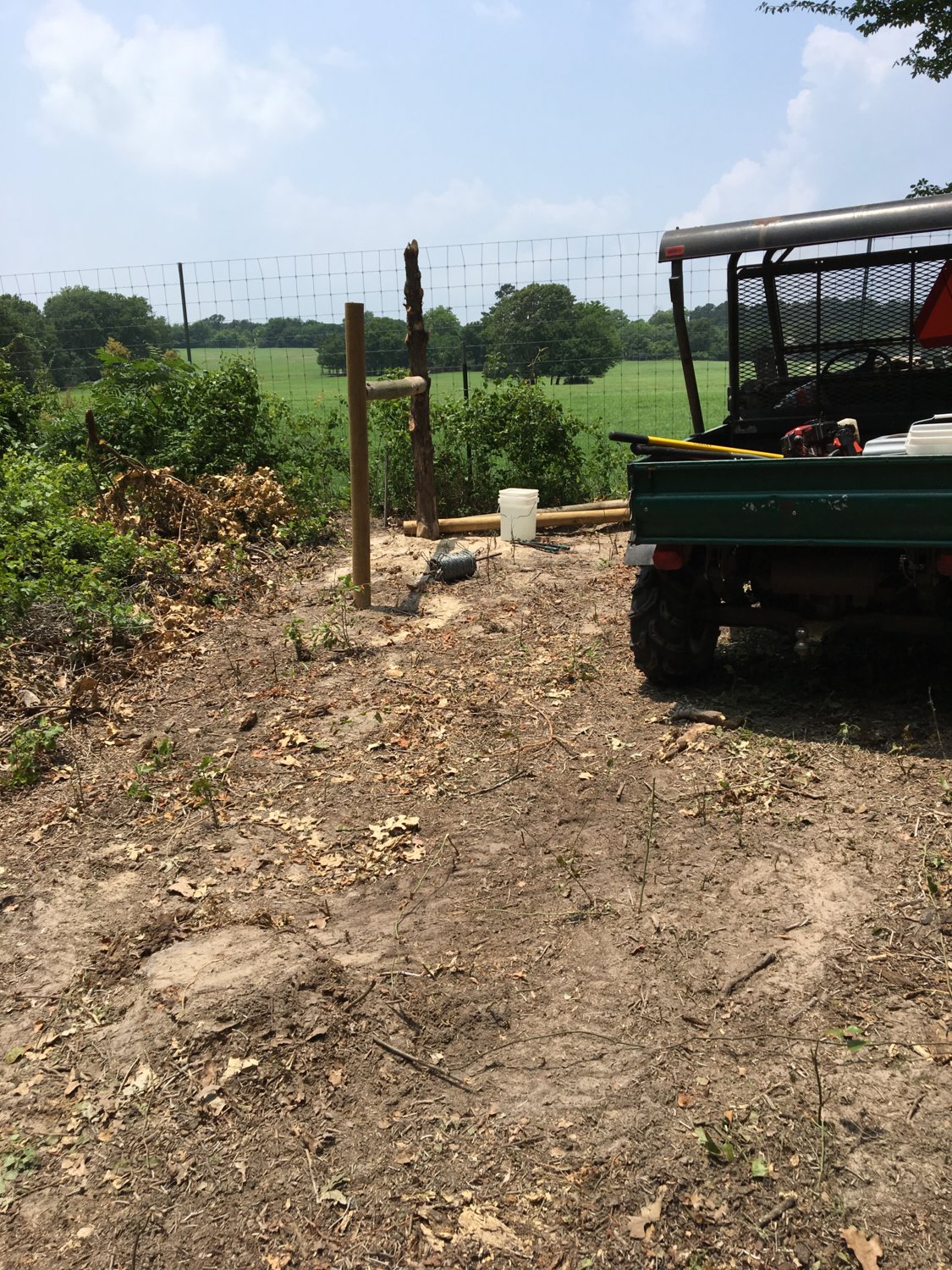

This was the corner.
img_1722-jpg.35704

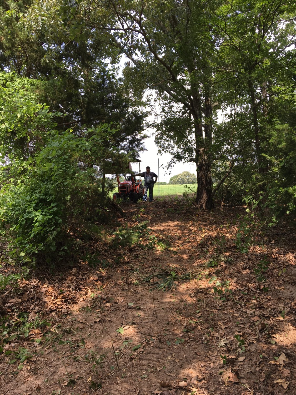

Because of the closeness of a tree to the fence line, we would not be able to get the tractor or mule through, so we cleared a short cut!
img_1718-jpg.35712
