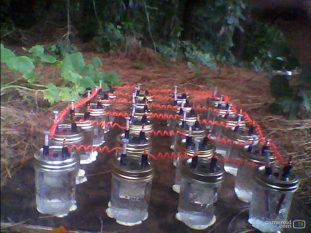

OK SS. Nice work. Now my next question is: How does the size/volume of the battery affect the performance/voltage?
If you use a quart or even a half gallon jar will that make any difference in the voltage or amperage?
If the voltage is proportional to the volume, think what a 30 gallon plastic drum would do.
Maybe not but it sure does bear asking.
//BT//
Trim sends
S
sunsaver
Guest
Size only affects the life span. The bigger the battery, the longer it will last before you have to replace the electrodes or electrolyte. I made a 28 cell battery out of two ice trays, using tiny thin strips of copper and galvanized flashing, and the performance was the same. This is a galvanic battery, based on the electropotential difference of the metal itself. I think it has something to do with the weak nuclear force, but i've never found a satisfactory description of it. Surface area, proximity of the electrodes to each other seem to make no difference in voltage levels. Stacking cells in series can add up to some high voltage though, as far as you want to go.
also, a more corrosive electrolyte, acid or base, will boost the amperage, while shortening the life of the battery. Theoretically you could have a massive battery that does what a regular battery does, but for much longer.

Good idea, FF. Heres a pic of the completed battery:
Icu4dzs
May 7, 2010
1,388
59
208
http://www.sufficientself.com/forum/uploads/3514_jj_new.jpg
Awesome work SS.
I note that this is "outside" and have to say that I'd be unable to have mine "outside" for more than 90 days of the year. The rest of it is too cold. The nice thing is that the electrolyte is benign and won't damage the environment if a spill occurs. I love that.
Keep us informed on the power, amperage and capability of this. It may be that we will have to use it one day (?soon?)

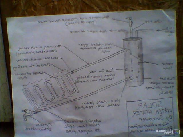

Here is a drawing i made of my solar water heater. You'll need a mirror or photoshop to read it. I'll try to scan it with my other computer, and transfer it over here.
620
I'm not a teacher, but I can read backwards and upside down. This just isn't big enough.
