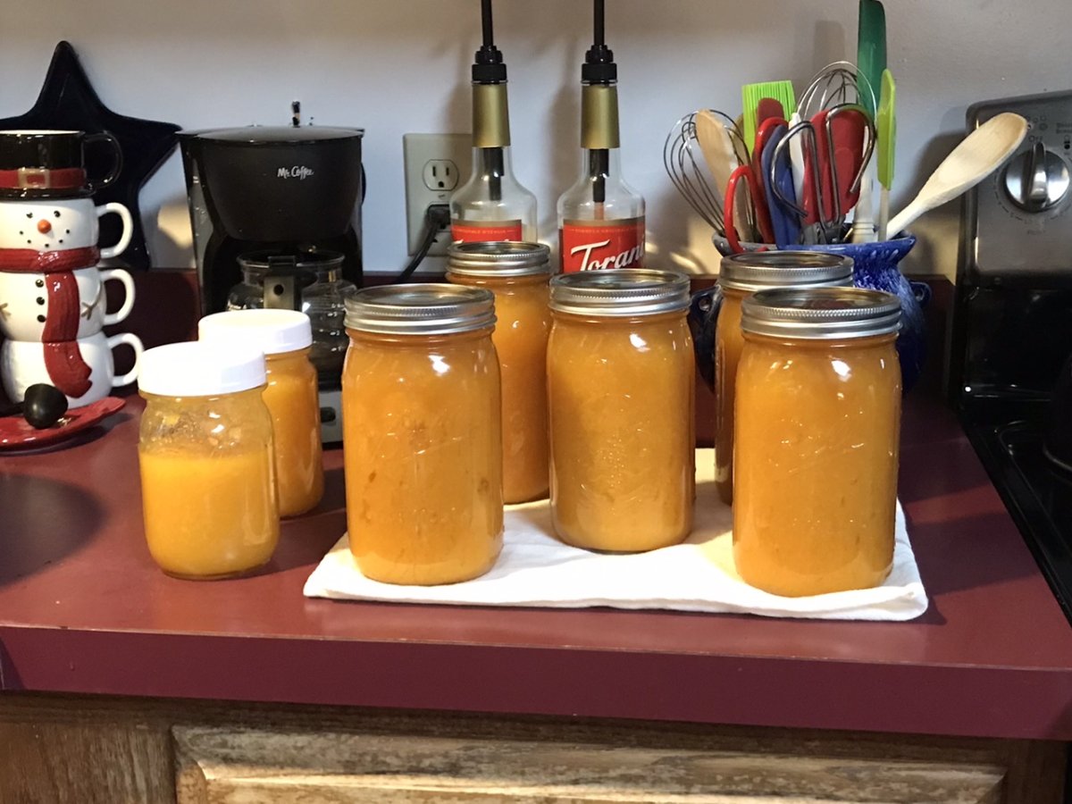

Apricot nectar/purée
This is from a 3 pound bag of dried apricots I got at Costco. Nowhere can I find those little cans of apricot nectar to buy unless I want to pay gouger prices on Amazon. Every once in a while a recipe calls for some, or I just want some to drink. So, I made my own!
Next time I will purée it better though. This batch is a little chewy! 😅 The two pints are going straight into the fridge. They were the leftovers that didn’t fit in the canner.

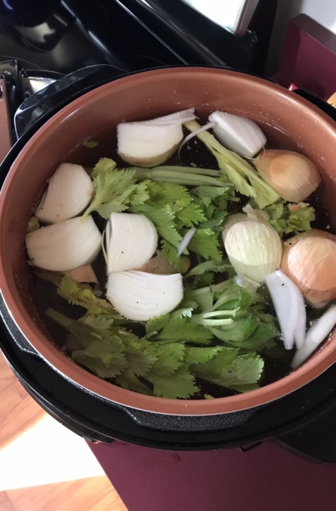

Todays adventure: beef stock!
Steak and rib bones I’ve been saving in my freezer, veggies, salt, pepper, and water to the fill line of my 12 quart GoWISE pressure cooker. Going to pressure cook it on low for at least 3 hours, maybe longer. Whether I can it today or tomorrow depends on how long it takes to cool for the fat to rise to the top for skimming. No hurry.

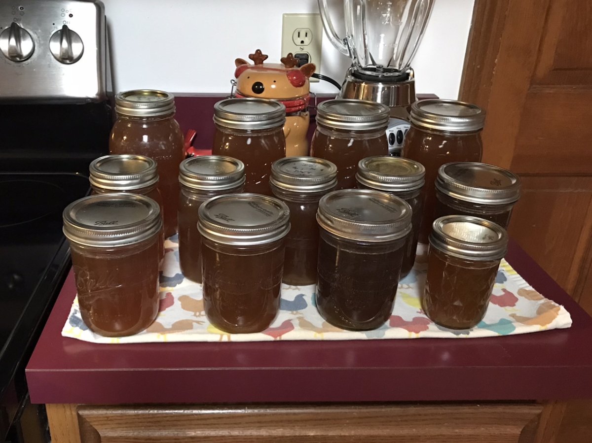

Here’s the beef broth. Cooked it Friday, canned it Saturday. I actually canned some of it in the GoWISE because I didn’t want to wait around to run two batches through the Presto. The GoWISE is a 12 quart, and I was able to fit 4 quart jars and the half pint jar in it.
2 of the pint jars didn’t ping, so they are in the fridge waiting to become soup for tonight’s dinner.
My stash of canning jars is running low. I hate to pay more than a dollar for a jar, so I will have to start scouting the local Goodwills. Some of them are charging more for jars now, but some of them will still have lower prices on them. Just depends on which goodwill I go to. I can think of at least 6 off hand that are pretty close. Will definitely be looking at garage sales this year.
Oh, and while I’m here, have any of you who own the Presto ever ran into a glitch where it didn’t stop venting after the 10 minutes was up? That happened last night. I kept waiting and waiting for it to stop letting out steam and start the processing countdown. After like half an hour I realized something was wrong. Checked the troubleshooting part of the instruction manual, and the only thing it said about the situation was that the lever must be pointed at vent instead of can. Well mine was pointed at can. I flicked it back and forth a couple times to see if it would “take”, but it still didn’t.
I ended up canceling the program, waiting for what pressure it had built up to depressurize, and starting over. I couldn’t find any issue that might have caused the problem, and it worked fine when I restarted it. 🤷🏼‍♀️ I have an email in to Presto asking what could have happened. Will be interesting to see what they write back.

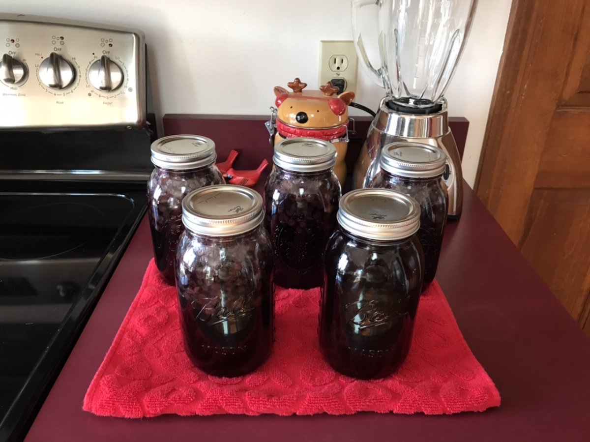

Made (sort of) blueberry pie filling today. Grocery store had blueberries for 99 cents a pint the other day! I used a few of those plus a few quart baggies I had in my freezer. Not too happy with the recipe I used. Was this one: https://nchfp.uga.edu/how/can_02/can_pie/blueberry_filling.html
I wanted to make 4 quarts, so I multiplied the amounts for making 1 quart by 4. But when I filled the jars, it wasn’t enough to fill all 4. I ended up dividing the berries between the 4 jars, and then I made extra syrup/sauce to fill the jars the rest of the way. So my “pie filling” is more like “sauce with some berries”. Oh well. I also have one jar with just the extra syrup.
If I ever want to make blueberry pie filling again (big IF, since we don’t eat much blueberry pie) I will look for a different recipe.

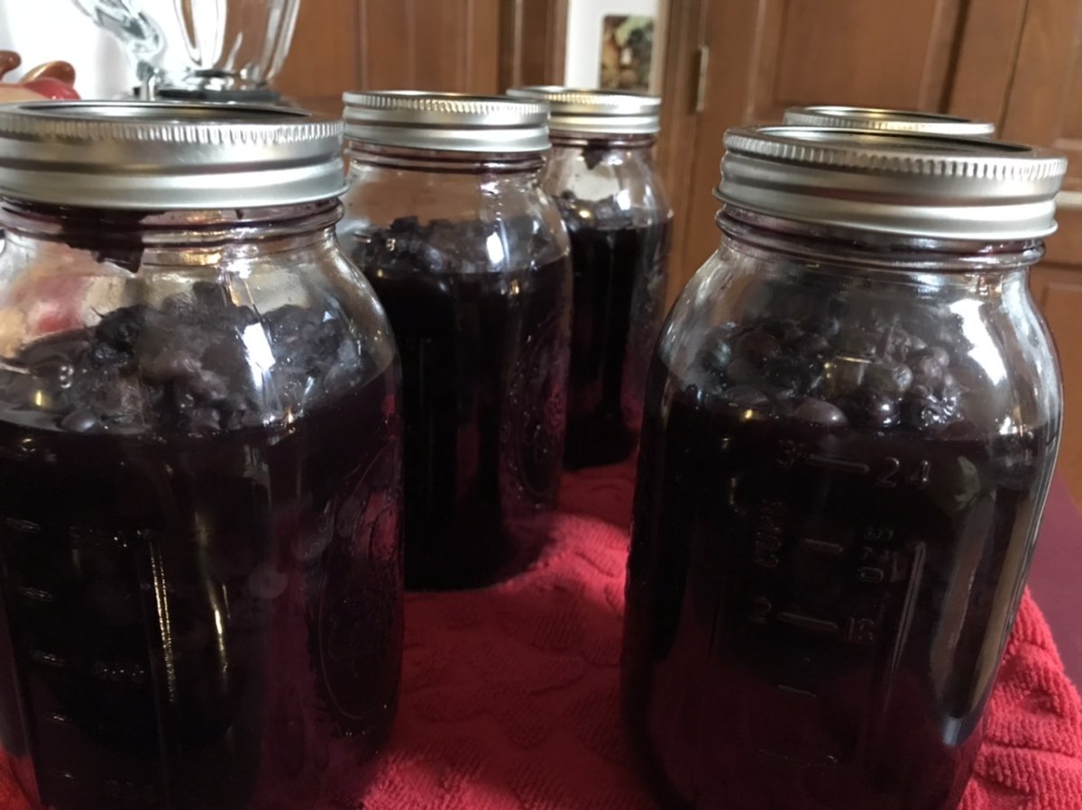

So, the photo I posted above was hot out of the canner. You can see that the blueberries floated to the top, and filled up the whole 1 inch of headspace. 9 hours later, and now that they’ve cooled off, the liquid level has gone way down. And the blueberries are sticking up from the liquid and there is a huge headspace of air now.
Checking the troubleshooting section of my owners manual says this is from liquid leaving the jars during processing. It gives two reasons, either packed too full (I don’t think so, there was 1” headspace) or bands weren’t tightened down enough. That’s possible, because I tend to err on the side of not making them very tight. But I did notice that today I was cranking them a tiny bit more than usual. Maybe I just thought I was, but was actually tightening them less. I don’t know.
The manual said the berries above the liquid will discolor, but otherwise be perfectly fine. I’m reposting the same photo for comparison with how they are now.
Hot:
Cooled:
