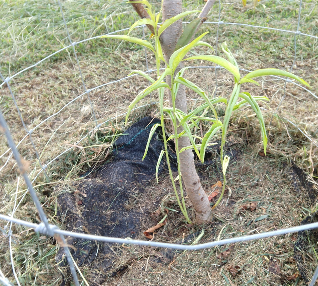

IDK... What you all think? Leave or cut off?
This peach tree was whip and tongue grafted. I can see the outline of the graft. The suckers are growing below the graft, so potentially free root stock. If they continue to grow, if survive the winter, if some small animal doesn't find them tasty and if I can successfully air layer them next year. That's a lot of if's 🙄
I'm seriously considering taking some horticulture classes.

Can you gently bend the suckers out to the side a little farther away from the trunk and then feed them through the bottom of a pot? Fill the pot with dirt with some rooting hormone but leaving the top of the sucker sticking out, and add more dirt as it gets taller? Then in spring before the leaves start, check to see if it has grown roots in the pot. If yes, you should be able to cut the sucker off at the bottom of the pot and it will be a separate plant, to put into a bigger pot or plant in the ground elsewhere.

Peach trees have a different pruning schedule. Peaches develop on 1 year old wood and are pruned in the spring, timing is very important. Here is a good guide on peach tree pruning.

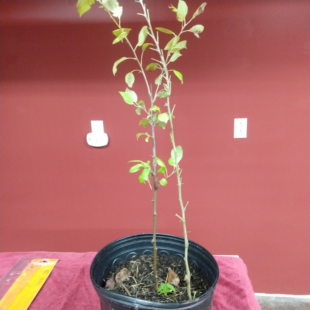

What fun grafting apple trees, I enjoyed myself. It's some delicate work with razor sharp stainless budding knife.
First select a branch this year's branch and cut it off where it meets the main trunk or main branch. It helps if it's about the same diameter as the root stock you're grafting. Then trim off the leaves but leave the leaf stems. Now you have what is known as a bud stick.
Potted rootstock and bud stick

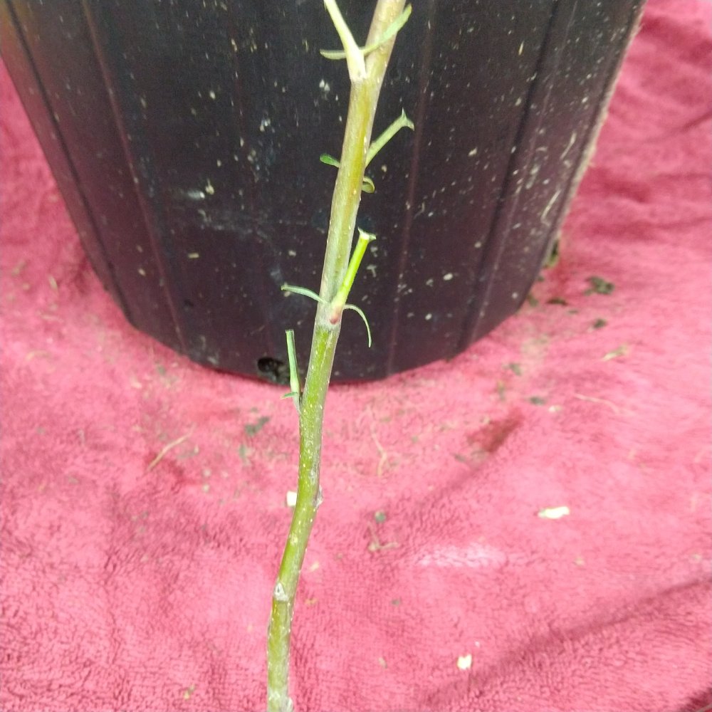

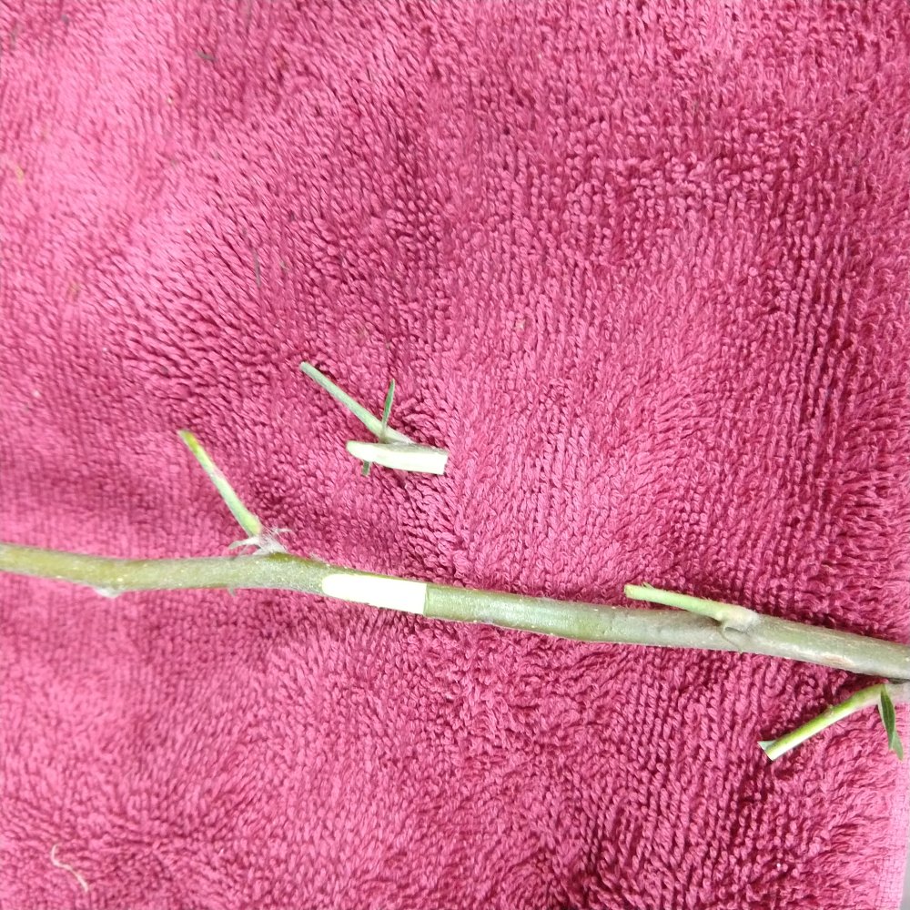

Next select a good bud to cut for the chip. Take budding knife and cut across the bottom of the bud the cut the bud loose from the bud stick by gently slicing top to the bottom of the first cut.
Good bud pictured and the cut chip.

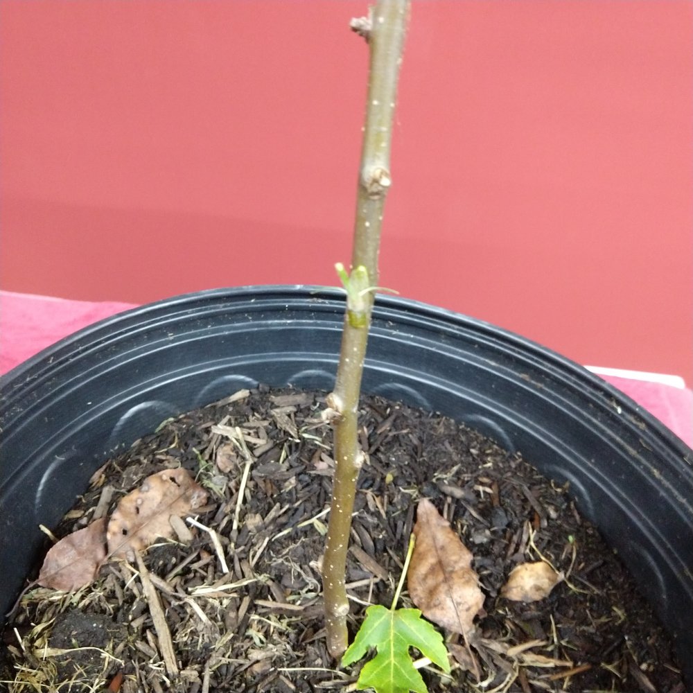

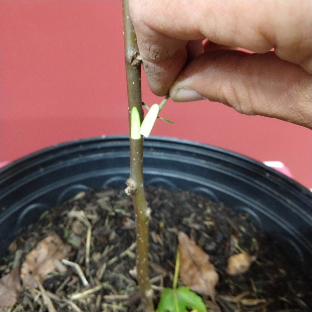

Next do the same cuts on the rootstock, to match the chip cut from the bud stick.
You know you did a good job when the chip sticks to the root stock all by itself.

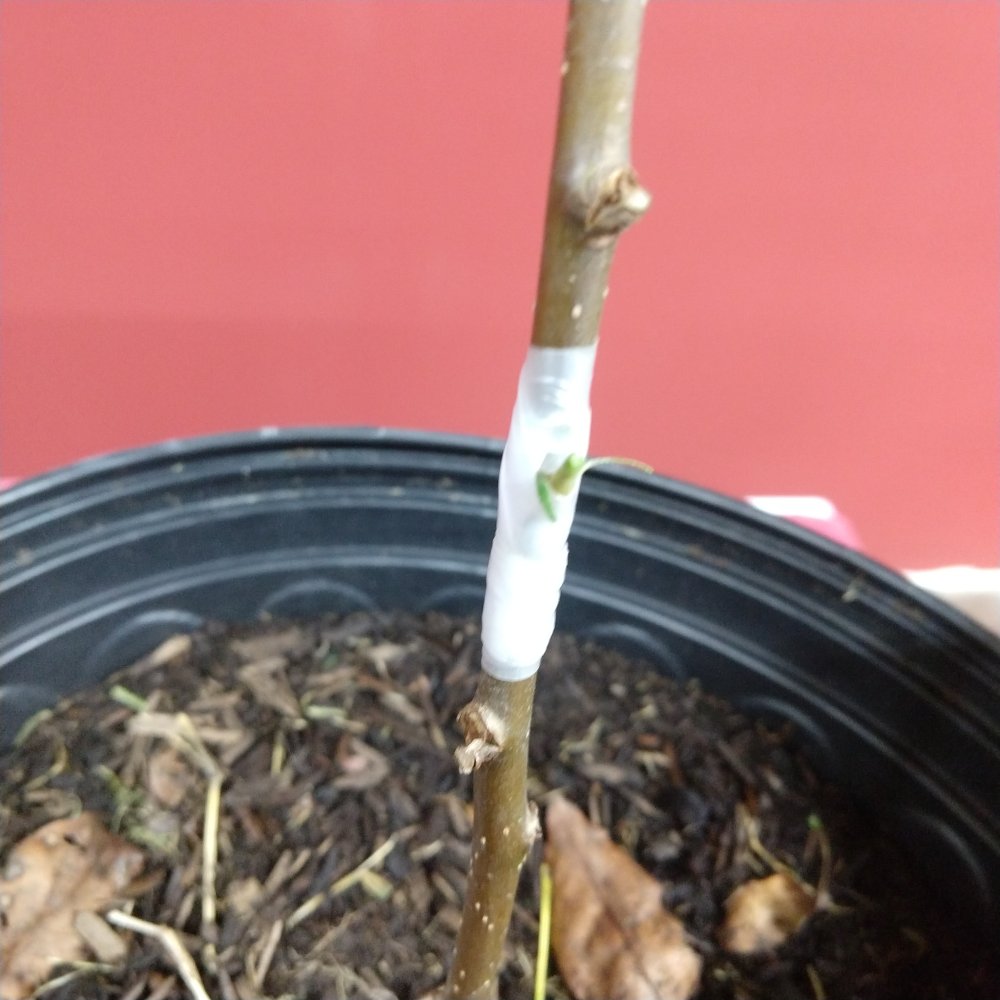

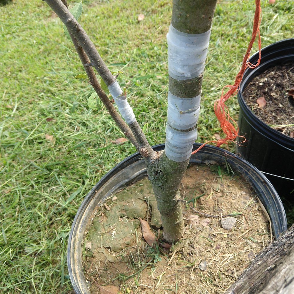

Next wrap with parfilm to secure the chip to the rootstock cut and snip off the leaf stem.
Pretty cool 👍 I had fun. I chip grafted a granny Smith, red delicious, golden delicious and an unidentified apple from the original orchard.
Plus I did a "fruit cocktail" 4 grafts, plus the crab apple produced by the root stock just for fun.
We'll see in a couple of weeks if the grafts took or not.

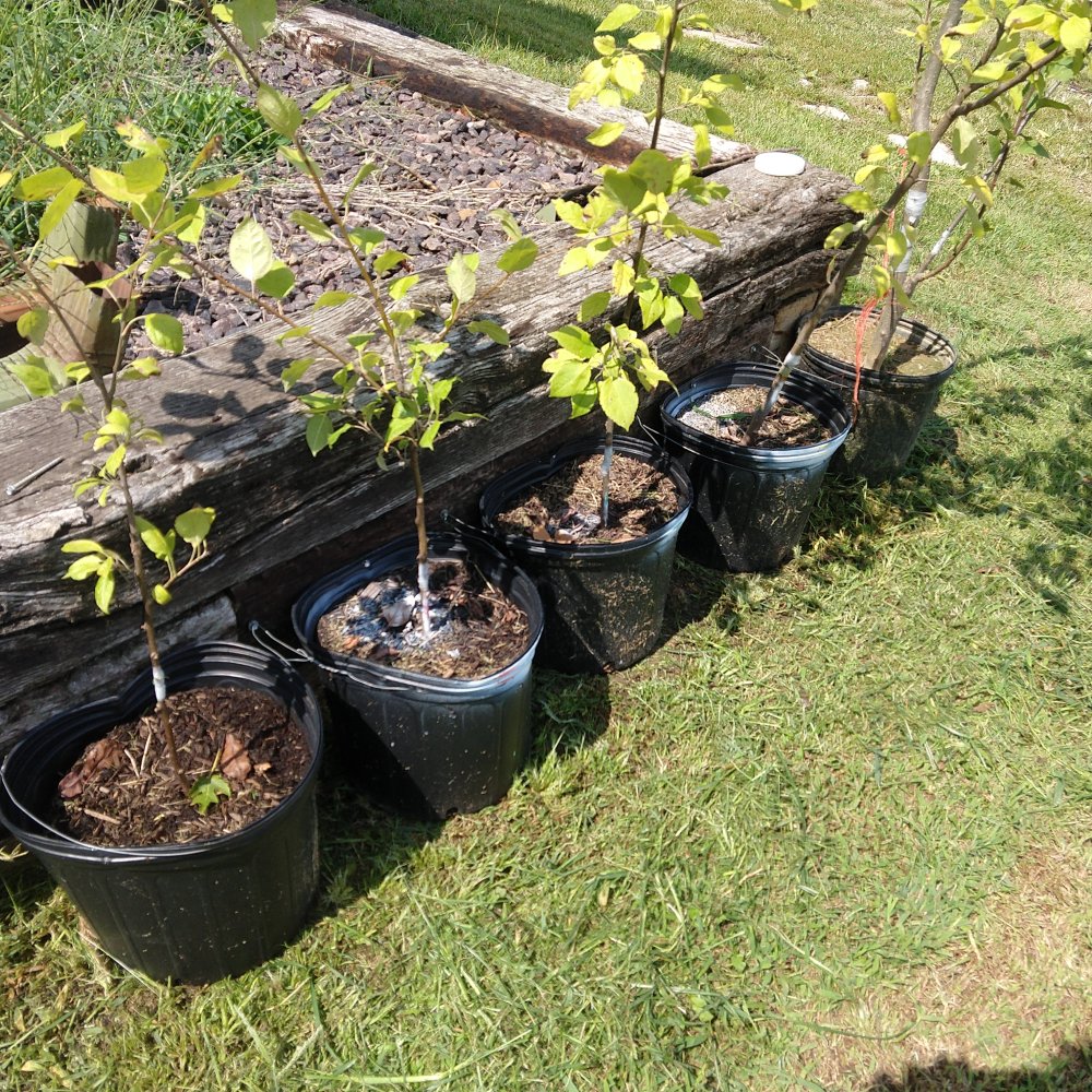

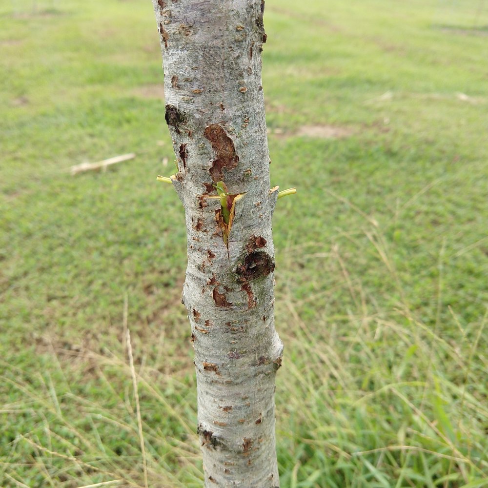

T-Budding the bark on this peach sapling is pretty thick. But with the nice rains we had last night and the cooler temperature the bark slipped (peeled away easy from the sap wood). This is a lot quicker and easier than chip budding but kind of the same. Cut a T in the bark with the budding knife down to the sap wood. Then use the brass non sharp bark seperator to gently peel back the top of bark to expose the camban layer (green). Then cut a chip from the bud stick same as for chip budding. Slide the chip into the T top to bottom and wrap with parfilm. Easy peasy.
Three T bud grafts about knee high
Wrapped with parfilm

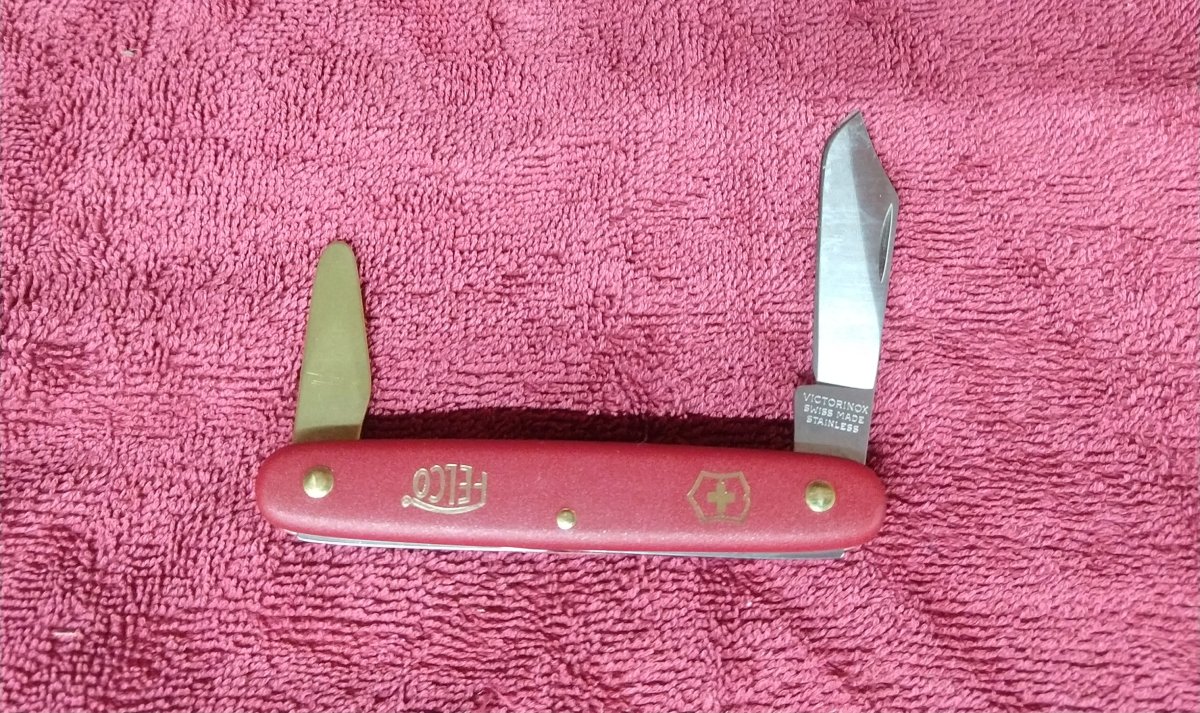

Budding knife it's a good one with razor sharp stainless steel blade and brass bark seperator.

I looked at all my grafts I did yesterday, the leaf stems are still green. I hope that's a good sign. I didn't remove the parfilm, it's biodegradable so there's no need to mess with it. I plan on giving the potted root stock a little fertilizer, since there potted and it's up to me to care for them.
