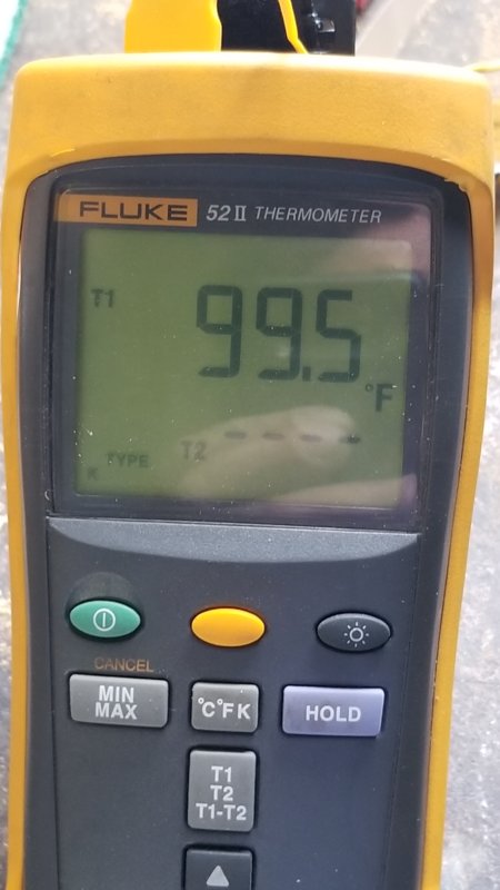

I went to work and brought home my $300 fluke dual input ktpye thermometer. I have one probe for dry bulb and one for wet bulb.
I don't think this vs are as stable as I was thinking. The k type reacts faster than any of the others and I'm get swings from 87 to 106 as the heater cycles. My bowl of water that's been in there for 2 days measured 86.
So ok eff it. The air is gonna swing. Nothing I can do. But I need a steady 99 in the eggs. That's where the rubber meets the road.
So I wrapped my k type in a baggy with water in it and I'm gonna let it set a while and see where it settles out. Then I'll make changes to the temp settings to maintain 99 in the baggy.

my little water baggy is holding 99.5 solid as a rock. Air temp swing has dropped alot. It will drop to 97.8 and rise to 100.9. It's amazing what some biomass will do! I'm veery optimistic about the hatch.
It's loaded with 57 eggs right now. I could have fit alot more, maybe 80, but that's all I had on the counter. Next time I'm going to make sure and have enough to fill it completely and I will probably add a couple water bottles before I warm it up.
