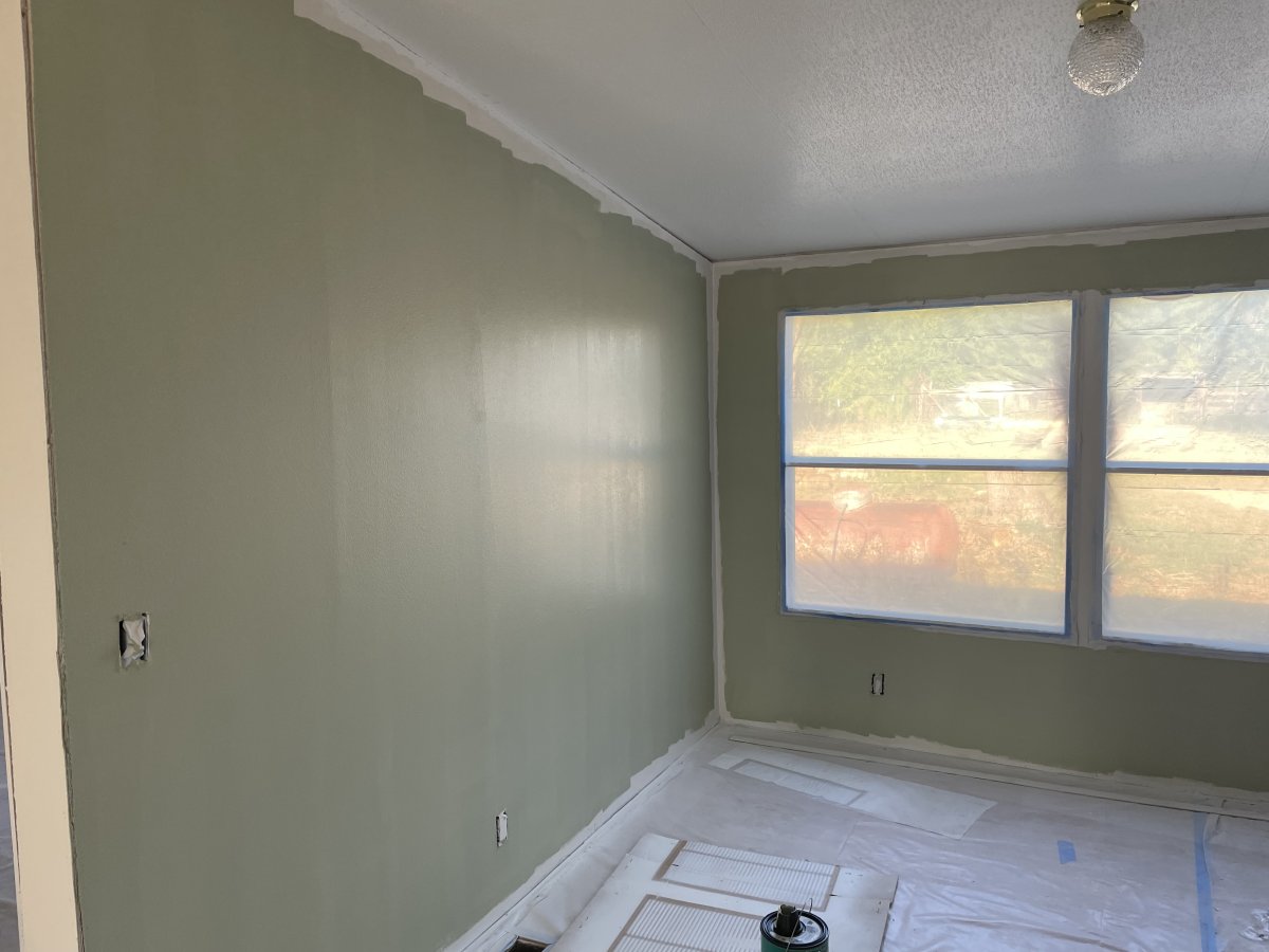

I painted yesterday! I still need to touch up corners with texture where a roller couldn’t go, and paint corners. I did the FUN stuff first!
Kitchen, dining and living room is sage green. I’ll trim this winter with 1x6 floor and ceiling, painted bright shiny white enamel with batten strips on walls for that country cottage look.

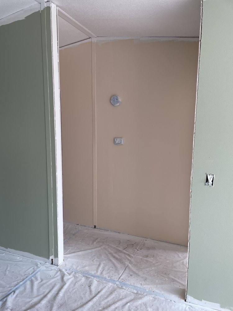

I painted the hallway, son’s/guest room a cream color. I’ll paint hall bathroom same color.

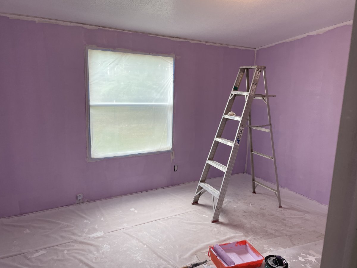

Little granddaughters love purple. I don’t. But I’m Mamaw and Mamaw does crazy things.

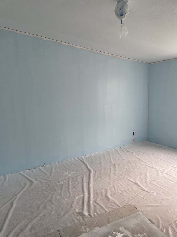

My room is a light blue. Still got to paint the bathroom.
