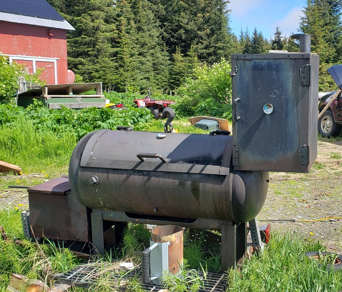

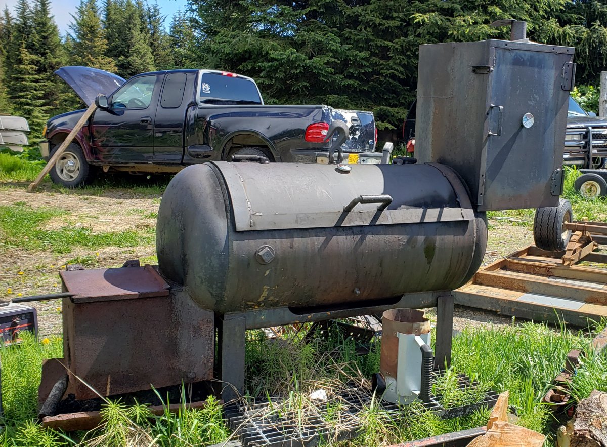

There was the coolest smoker i saw once... I will see if I can find it and take photos.....
We just use a BBQ pit/smoker, hand made

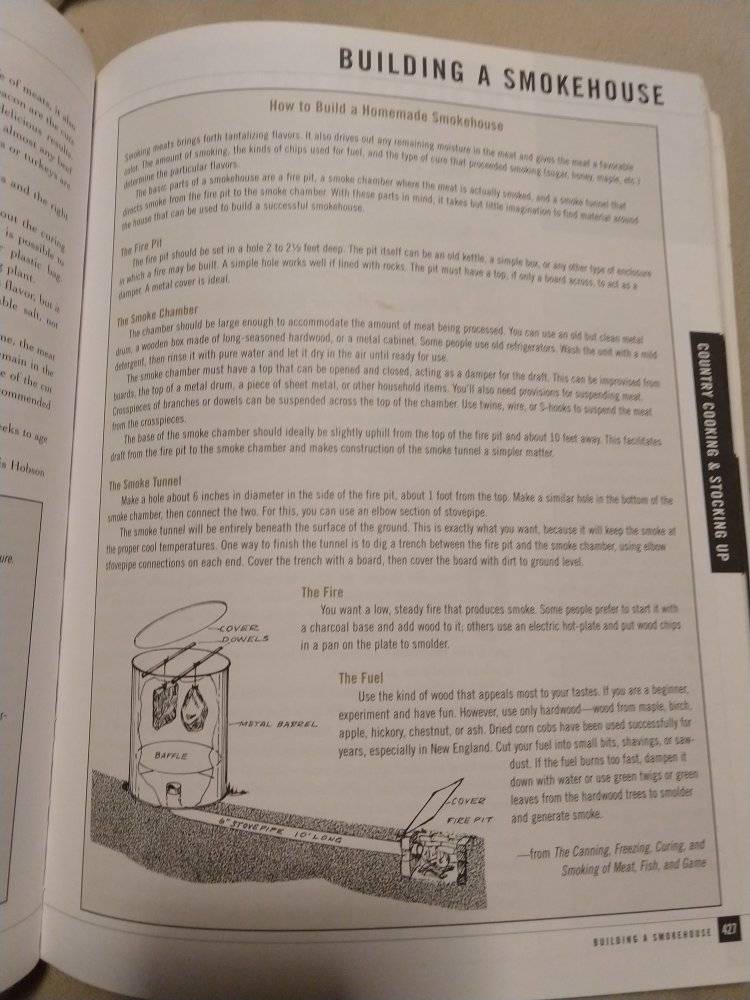

Generally speaking the fire is usually a pit in the ground outside of the smoke house with a pipe that runs under the floor of the smoke house. The smoke usually comes up from cracks or holes in the floor boards. Or the smoke pipe comes in at ground level on a side of the smoke house. The one I recall that my uncle used was smoke rising up from the floor boards and exiting from soffits in the roof.
This is generally how a cold smoker would work. I'm sure there are numerous ways to build them though. I've never built one, but like you I have been around them before. Building one is on my bucket list 🙂
Storey's Basic Country skills, explains the concept better than I can.

I have some good old books, Fox Fire, Back To Basics, Gene Logsdons Practical Skills, and a few more. they all have a smoke house in them. It would be great to do fish. Here we can get Pinks for 4$lb they are good for canning or smoking.
