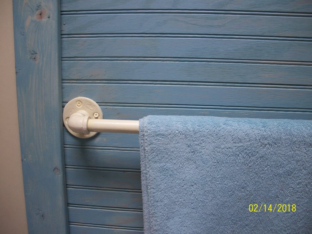

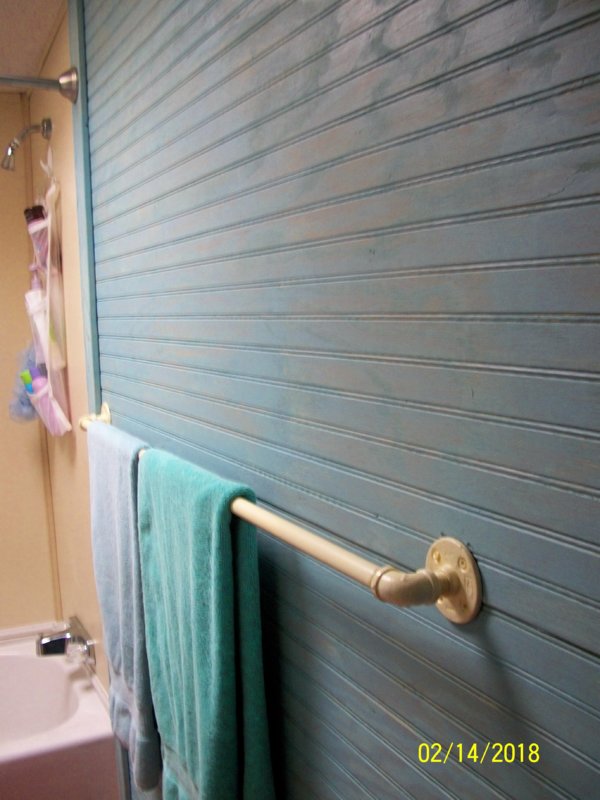

Opted to construct a new towel bar from pipe and flanges...got a 48 in. towel rod for less than it cost to have a much smaller, much more cheaply constructed one. Painted it with auto body primer and then some semi gloss latex that matched the paint I painted the bathroom vanity.

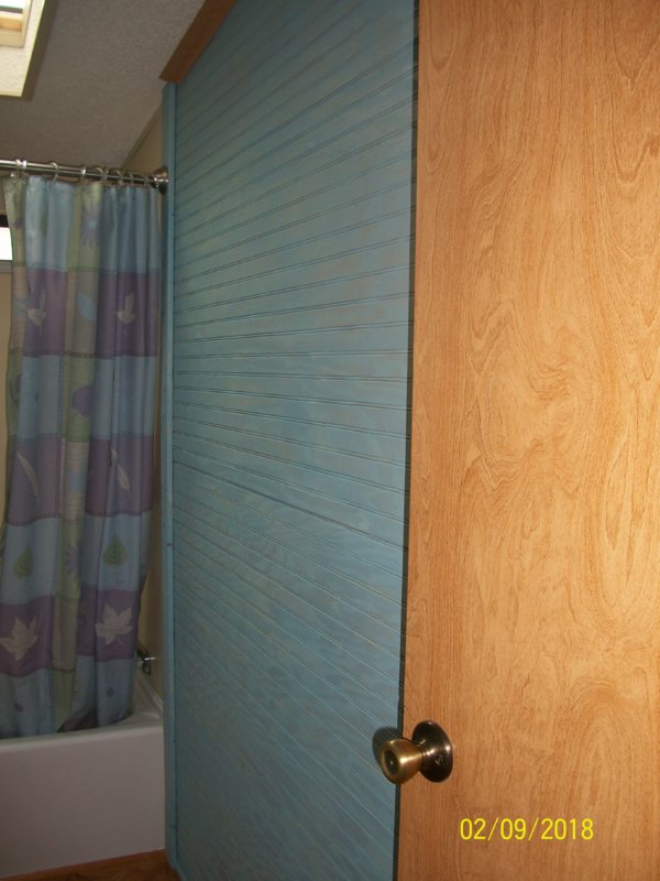

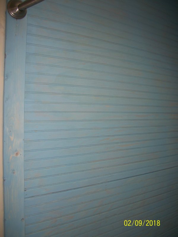

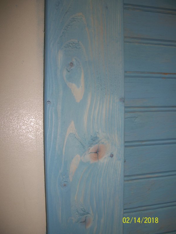

I'll be putting up shelves on the opposite wall and painting them the same color as the blue wall. This painting was done as a wash, with a mix of 1c. paint to 3 c. water...and it only took 2 c. of this mix to cover that wall and the board trim around the shower. I still have two c. of the wash to use on the shelves and the frame around the mirror.
Here's a few pics of the befores and afters....the camera doesn't show the true color of the paint as it's a cheapy camera. The paint is a little more bluey-green color than this...

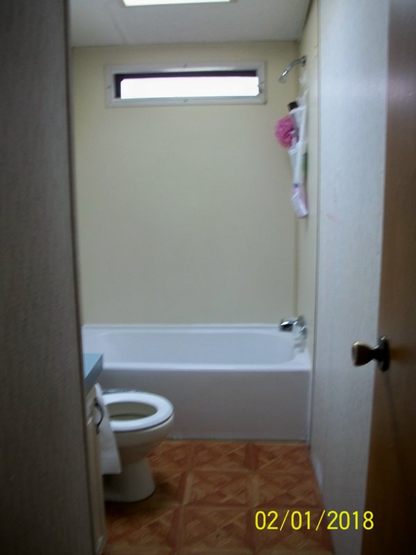

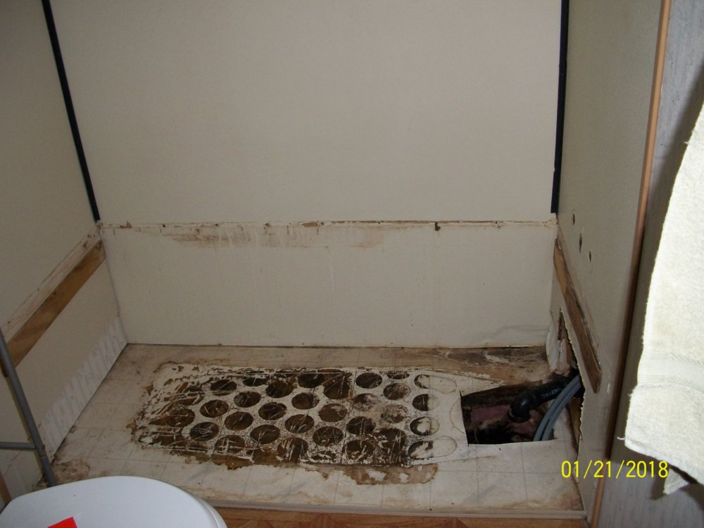

This is with the old tub taken out...it was a sort of harvest gold color but we couldn't get one of the same color to replace, so had to use a white one. Got a chance to clean up 25 yrs of crud that was under this tub, replace insulation that had gotten wet, put in shut off valves to all water lines and replace spigots.

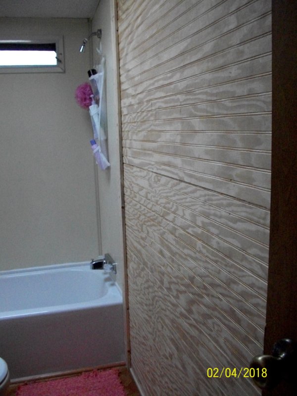

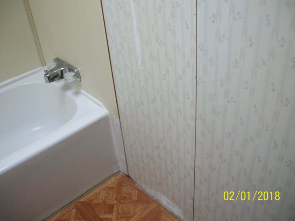

New tub...was very hard to get into that space and the wall on the right got very gouged. It's just printed panel board, so patching it was an option, then painting it...but painting these things is a bear. They are plastic coated, so they take primer and many, many layer of paint to cover and even then you can see the print showing through. We opted to place panel bead over that wall, put in horizontally rather than vertically. I wanted it to look like an old cottage exterior wall. I had wanted to do it all in shiplap but MUCH too expensive.
Water damage and gouges in the old wall....Mom had caulked over the gouges temporarily but you can see them all the same.
Panel bead up and board trim placed around the shower....hadn't been sanded yet.
One coat of the wash...which is all it's going to get. I wanted the wood grain to show through on this.
The towel bar....
I've yet to place decoration back on that wall...will bide my time and choose the right thing that goes with this "weathered" wall.
Didn't start out to be a bathroom redo, but just a tub replacement. Then it morphed into getting that wall covered...the old towel bars were from the early 90s and had to be glued onto that old wall for the lack of stud placement to support their length, so that necessitated new towel rod.

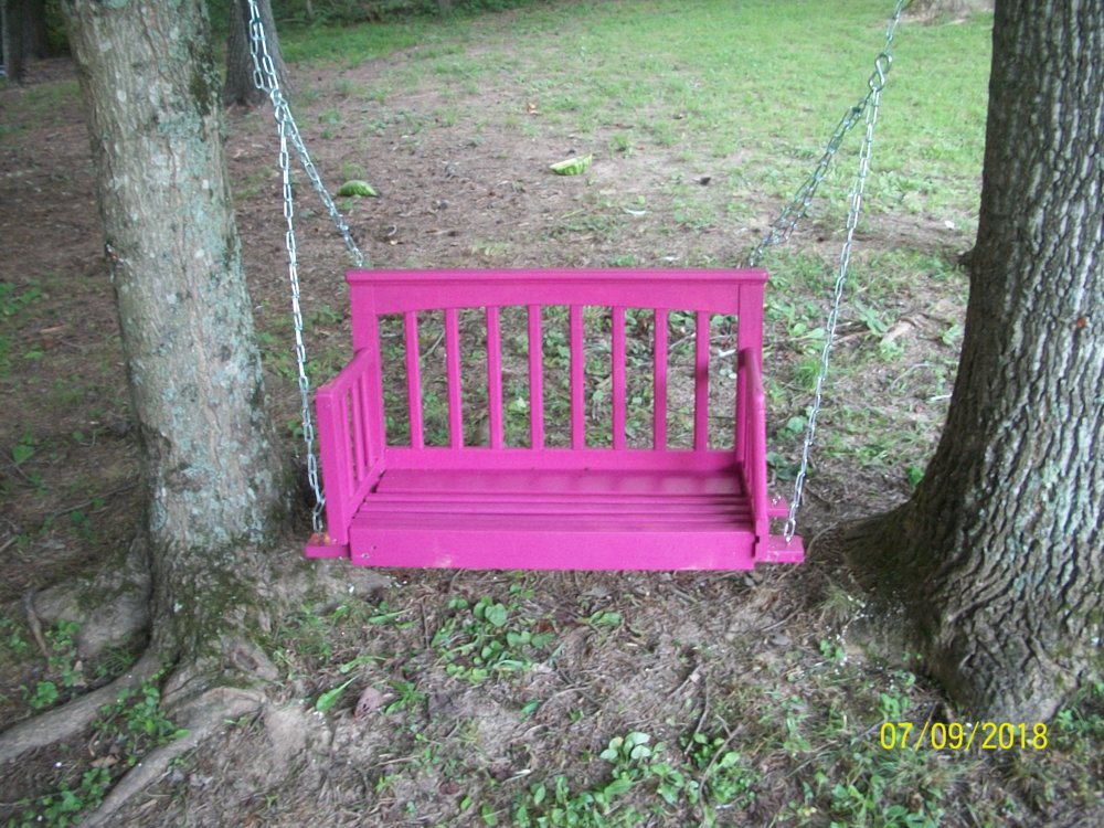

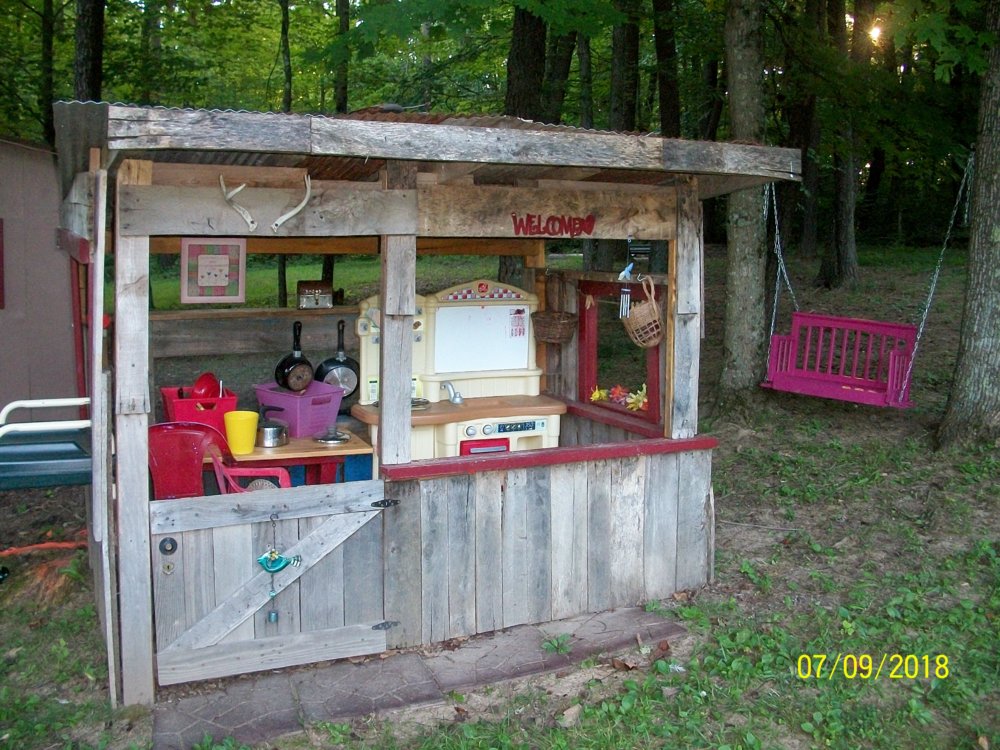

It's done.... swing/glider I built from the legs of an old table and a wooden toddler bed frame we got at GW for $10. Other than paint and hardware, that's all that's in it. The frame has been sitting under my carport for a year, awaiting a new life and now it's got one. I modeled the design after an old glider we have in front of the garden as much as I could.
Got a few safety adjustments I want to make on it, but for now it's mostly finished.
Oh, and that color? Grandgirl said she wanted it pink. My son says it looks like Barbie puke, but she'll be pretty happy with it. :D

I didn't like the instability of the glider setup, so turned the glider into a swing instead...I think the girls will like it better this way too.
Hung it by their playhouse.
